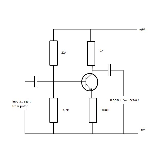

I am new to this forum and I have what I guess must be a pretty simple problem to start with.
I would like to make a guitar amplifier for my A2 level Product design project and so I thought I would start with a simple transistor amplifier to get things going. Basically, I have tried this a few times and watched videos, read books and seen schematics and I cannot get this circuit to work (see attachment for schematic).
I can hear the interference when I hook up the battery so it all must be connected up, right? But when I plug the guitar in, I get no sound out of the speaker whatsoever. I have tried to follow a schematic I saw on youtube for a transistor preamp where his input was a mic and his output a PA speaker, he ran it through an IC power amp stage though. Do I need to do this to get any sound?
If I need a power amp stage then I would prefer to make it myself out of transistors instead of an IC as I would like understand how it all works, so does anyone have a schematic for a basic power amp stage?
Any help would be appreciated as I don't really know where I am going wrong.
Thanks in advance
Callum
PS, the transistor is a 2N3904 if this matters

First of all,you need more gain. The output signal of a typical guitar is very low,you simply aren't amplifying it enough to be heard.
Second,the circuit you posted is more of a 'low level' amplification stage,it doesn't have the 'grunt' to drive a speaker.You need a power amplifier of some sort,it could be a simple circuit with a couple transistors,and a handful of passives (caps,resistors) or a chip of some sort (LM386 comes to mind).

The circuit you have provided is just a simple voltage amplifier and cannot drive a speaker directly. A discrete transistor amplifier is a complex undertaking and without some experience you are not too likely to get it working.. A chip based power stage would probably be a better idea.

The circuit you've posted has an input impedance of roughly 4k. For a guitar it needs to be more like 400k.
Guitar output varies a lot, but 50-100mV is a reasonable starting point, but only if it connects to a high impedance input - give it 4k and it'll pretty much disappear.
The speaker is very low impedance - 8R (ohms) is common, so it needs a circuit that is better at supplying current. I've never come across a one-transistor practice amp, and I'm old now!

Without this, you'll struggle with non-working circuits and we won't even be able to explain why. Hint: your circuit's gain is about -22dB (or, considering the loss by the input Z, about -50dB) - it's an attenuator!

Assume that your input capacitor is large enough that it has very little impedance at frequencies of interest - in this case anything above 82Hz, which is the fundamental of bottom E on a guitar.
Signal current flowing in through that cap sees three branches of circuit in parallel:
Through the 4k7 to ground
Through the 22k to the +ve supply rail, which to signals looks like ground (really).
Into the base of the transistor and then to ground. Because you have an emitter resistance in circuit, of value 100R, and because the transistor has substantial gain the resistance looking into the base terminal will be reasonably high. If the gain, hfe, of the transistor is, for example, 150, the resistance looking into the base of the transistor will be about 15k - the emitter resistance x hfe.
So, calculating 4k7 // 22k // 15k gives 3.08k - a bit lower than I guessed earlier, but I know I tend to over optimism.
The transistor's input impedance has been much increased by the emitter resistance, which provides negative feedback. Some types of feedback reduce input impedance, this one increases it.
Another effect of the negative feedback is that it reduces the gain, and distortion of the amp - with no load attached, the voltage gain of the stage will be roughly 1k / 100R, ie 10. But with an 8R load, voltage gain will fall to about 8R / 100R - 0.08 - not very loud at all!
To get the 0.5W output mentioned earlier, which might surprise you as to how loud it is (only 16 dB quieter than 20W) you need to get 2V RMS across an 8R speaker. Because a guitar signal is quite peaky, that means a peak voltage of something like 8V - or 16V pk-pk (others here will be able to give you a better idea on typical "crest factor" for guitar signal).

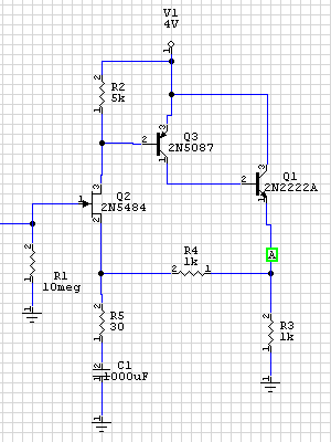

Build a preamp, that will get your guitar signal up to "line level", for domestic gear that's -10dBV rms, which in volts is 316 mV rms (roughly!).
This would mean that you could test it out with one channel of a not-too-precious solid state hifi amp going into a guitar speaker, or a cheap powered computer speaker - my local computer shop gives those away.
Once you've got your preamp working you could use it to drive a chip amp, like a TDA2030, or just swipe the chip amp and power supply from the computer speakers......gets you a free volume control. If your A level is Product Design, not electronics, I don't see a problem with that at all. :D
For a guitar to line level preamp the requirements are:
High Z-in (input impedance) - in the range 470k to 1M
20dB gain (ie 10x voltage gain)
Medium Z-out - 600R is quite fine.
Given these, look at this:
Ritter preamp
This circuit uses a fet as the input device, so it has inherently high input impedance. R4, R5 and C1 form a feedback network. The feedback fraction is R4/(R4+R5), so roughly 1/30, and that defines gain as roughly 30x, which is also roughly 30dB. The feedback also lowers the output impedance substantially, but connecting it to a speaker might overload and destroy the output device Q1.
I'd drop R1 down to 1M or even 470k for guitar use, bit less noise with nothing plugged in and easier to get the part.
Only one cap is shown, but you'll need an output coupling cap connected to point A - the value will depend on what impedance it works into. The higher the impedance, the lower the value required. Too low a value will lose you bottom end.
It'd probably be a good idea to have an input coupling cap too, though this can be smaller than the output cap. Say you make R1 470k, and maybe one day you might want to put a bass through it, so let the -3dB low frequency cut-off point be at 20Hz. Then you'd want to choose your input coupling cap to have a reactance of 470k at 20Hz.
The formula for capacitive reactance is "Xc = 1 / (2 x Pi x F x C)" so for -3dB at 20Hz, you want Xc = 470k, swap the equation round and you get:
C = 1 / (2 x Pi x 20 x 470,000)
C = 17nF
next bigger preferred value is 22nF, so use that.
