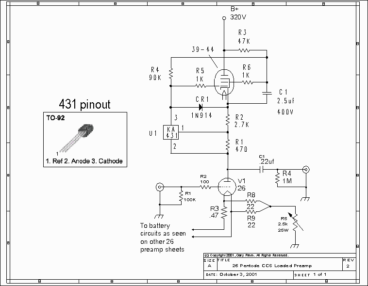

Hi Peter,
I've tried pentode based current sources, nice but doesn't beat a nice plate choke.
Just curious,can you tell us more?
You wouldn't happen to have a circuit diagram you can post here or e-mail me?
Did you use it together with a valve regulator?
As you see I am rather very curious.🙄

I haven't done anything exotic, just variations on this circuit using EF86, EL84 in different applications. Takes 10 minutes to try. I did use a TL431 as i don't have any tubed voltage references. Yeah, i know 🙂
cheers
peter

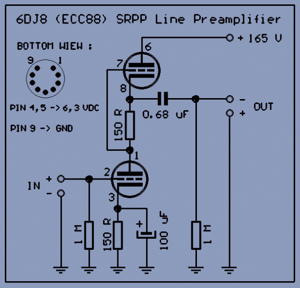

apassgear said:
Yes, Lundahl LL1660 fits the bill for a max 16 mA stage (ECC88 which isn't the best aproach since it has 2/3K RP), though no CT for a balanced output. For the moment I use an Aleph 4 and would like this provision.
You don't need a centre tap for a floating balanced/symmetrical output.
Should I use a floating symetrical output?
Or are you thinking of creating a ground with two shunting resistors?
I thought it should be referenced to ground, I might even like to try some NF.
In any case there is no problem adding a tap on the secondary.
