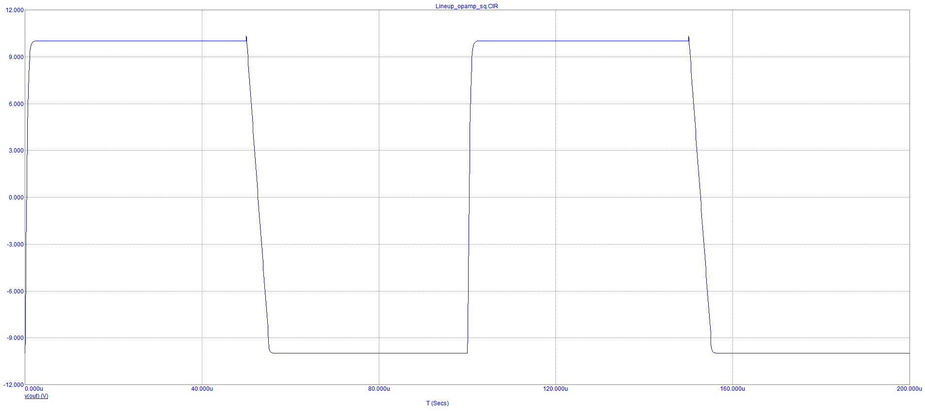

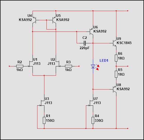

Here is a basic opamp with good performance. JFET input and can be used with single or dual supply. Max 30V single or +/-15V supply. Can be used as a preamp or whatever you need.

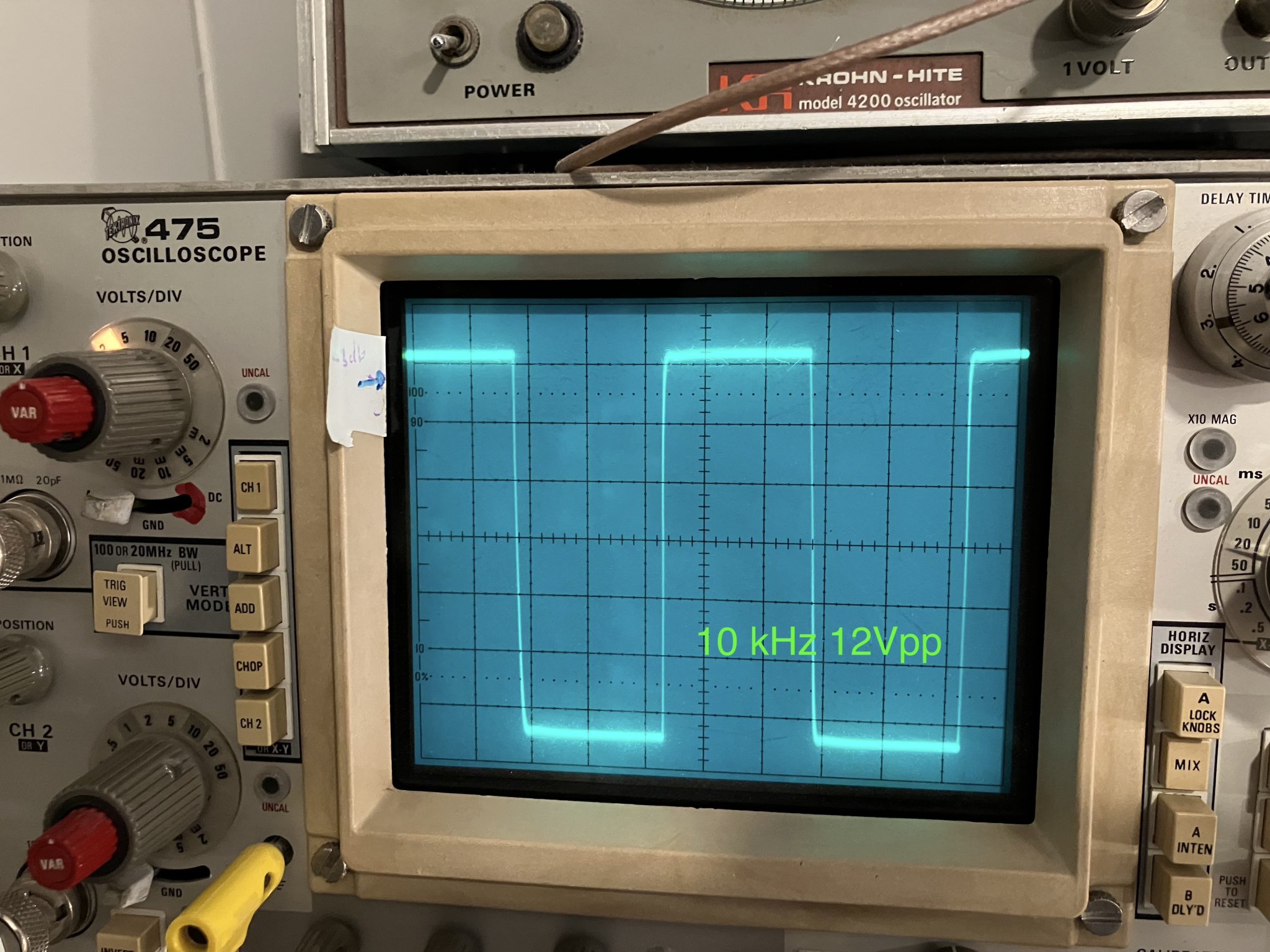

PMA Member Joined 2002 pmacura.cz/audiopage.html Paid Member Yesterday at 9:47 AM #2 Yesterday at 9:47 AM #2 May I have a question - what is the goal of your "designs"? PMA Member Joined 2002 pmacura.cz/audiopage.html Paid Member Yesterday at 10:18 AM #3 Yesterday at 10:18 AM #3 10kHz square (gain 10x) ..... You must log in or register to reply here.
