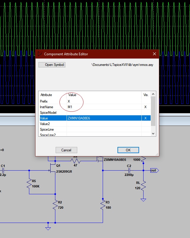

Now this topology needs to get muscular strength, I mean N Channel Mosfet.
I want to add Fairchild FQP30N06 as output buffer.
Ltspice Spice Sim is attached.
Tried ZXMN10A08E6 mosfet , ZXMN10A08E6 (MOSFET Master Table)
Still didn't work, everytime lt spice fail
feeling frustrated
<CTRL>+Right mouse click on 'M1'
Change 'Prefix' to X
This lets LTSpice know that you want to use a subckt.
attachment.php
With Zetex ZXMN10A08E6 Mosfet, at 25db Gain Well well that will destroy my ears

Gotta bring the gain down
2.5vpp into 20K load ( Let say TDA7293 AMP) ,
