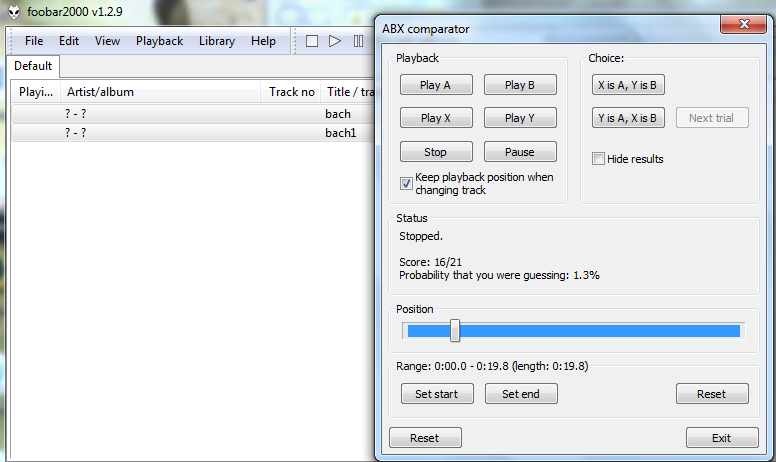

Pavel, here is my Foobar ABX result for your test :

I would like to see properly prepared sound files, with level matching and trimming so they start at the same time.
Without this anyone can get a positive ABX test result even if the files are identical in every other way.
Try Bach/Bach1. Absolutely same level, absolutely same time beginning.
I will not bother to preapare better files with Clapton music. The difference between them is 1000 : 1 in quality so it makes no sense to waste time with them. They are so dissimilar that better level matching was impossible.
Please try Bach/Bach1 in ABX, tell us the result and send me your preference, if you like - thank you.

Stuart, I agree with you completely. As you know, I have already provided you and Richard with three files that should be technically good enough for the well structured test. Today, I have modified the test files to have the same size, same time length and same time beginning of the sound. Amplitude matching within 0.01dB was of course retained. You and Richard were provided with a new link (dropbox) few minutes ago.
Two of the files were already used in another test here, the third is added to fulfill ABC test requirement.
I would like to ask kindly you and Richard to organize a well-structure test, as you both are profs in this. IMO it will be much more helpful than negative comments. I often have negative comments to tests as well, but then I am trying to provide members with useful data, like Bach/Bach1 comparison. I believe that you and Richard could bring a new quality to the test methods used in this great DIY forum.
