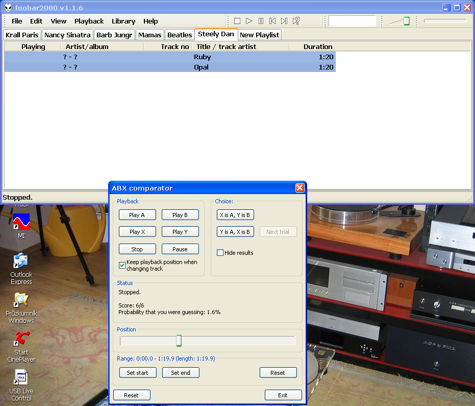

Here is my A-B-X result. Hope I am not asked to repeat it 16 times, it would be 100% then as well 😀
foo_abx 1.3.4 report
foobar2000 v1.1.6
2013/11/19 13:05:10
File A: C:\Documents and Settings\Administrator\Dokumenty\Hudba\Ruby.wav
File B: C:\Documents and Settings\Administrator\Dokumenty\Hudba\Opal.wav
13:05:10 : Test started.
13:06:19 : 01/01 50.0%
13:06:48 : 02/02 25.0%
13:07:22 : 03/03 12.5%
13:07:57 : 04/04 6.3%
13:08:30 : 05/05 3.1%
13:09:03 : 06/06 1.6%
13:09:31 : Test finished.
Total: 6/6 (1.6%)
P.S.: you must have a FM radio near when you are recording?
I have not voted which file I do prefer, I have just performed the strictly scientific A-B-X test 😀

I need your help here. I have no preference between these 2 files, but I have 100% success in ABX and I am sure I would have it even if ABX was repeated 20 times (boring and tiring, then). What does it mean, how do you translate the result? Like, YES, there is a difference? OK. But how much helpful is such information?

Yes, I have made a software analysis AFTER I have finished my ABX test. I was curious what makes such a huge sound difference (I was really surprised how big the sound difference was). So I have made an analysis, but I am saying nothing else than that I found 19kHz pilot. 19kHz or 15.625kHz is quite usual and it indicates that immunity against RFI is not perfect. Unfortunately, you will find it at studio recordings as well and then, in studio record, it is IMO unacceptable.
I am not revealing more 😉

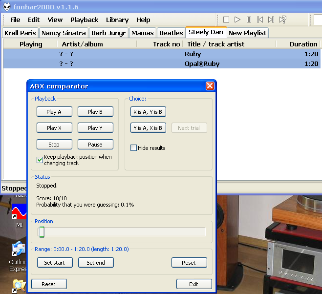

Pavel has very kindly produced a level matched file for "Opal" such that it is the same level as Ruby.
I'm going to put that file up as an alternative (but still leave the originals in place too).
