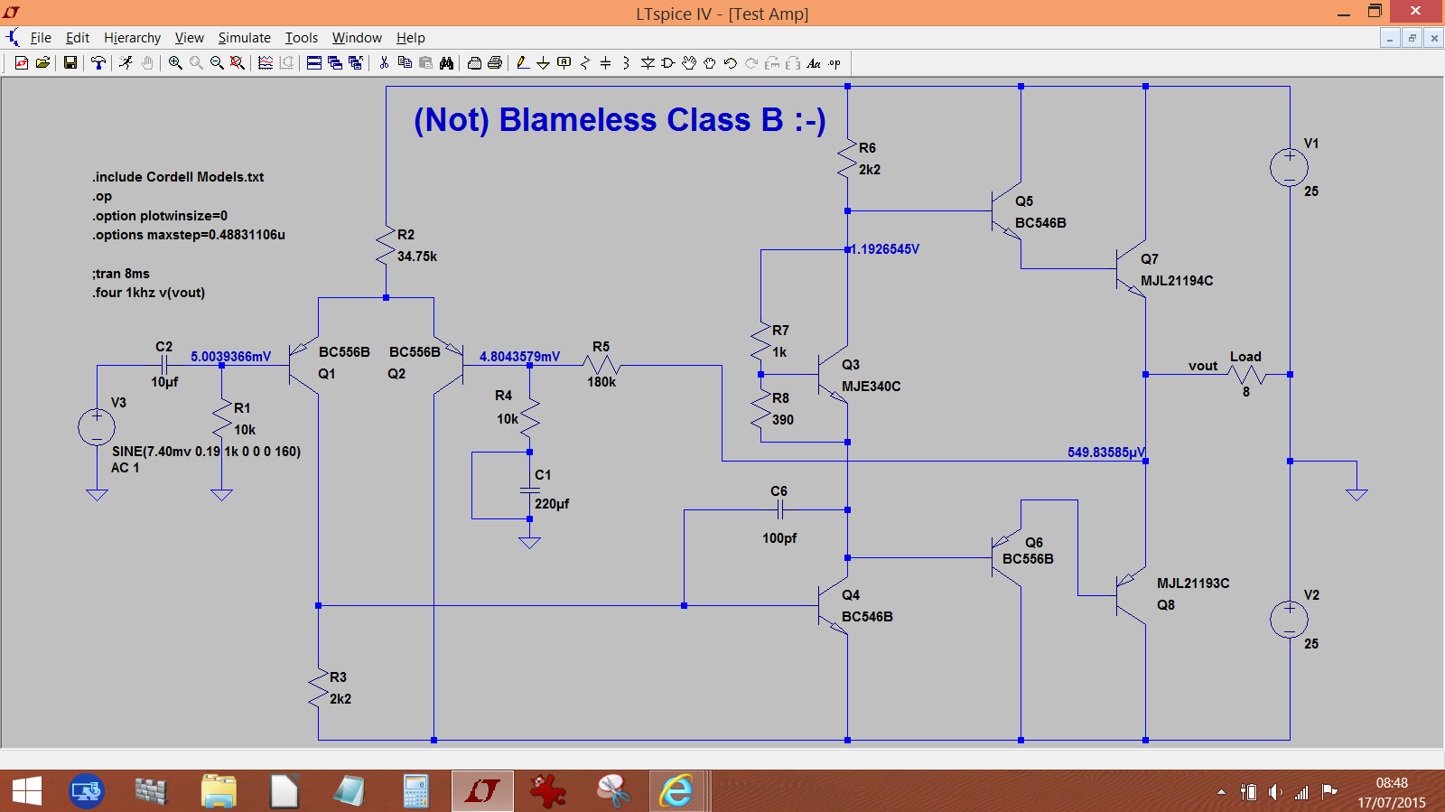

Yes mooly removing the feedback ground shunt cap (DC coupled) means that the offset moves around as the signal amplitude changes i.e. hot and cold.
Its not jumping around as might be expected if the amp is oscillating. All transistors (except VA) are cool to touch at idle.
Removing that cap may well cause instability at really high frequency, you would need to put a scope on it and confirm (or otherwise) that there is a problem.
Ok thanks mooly I will have another look at the scope trace tomorrow (it is late here now).

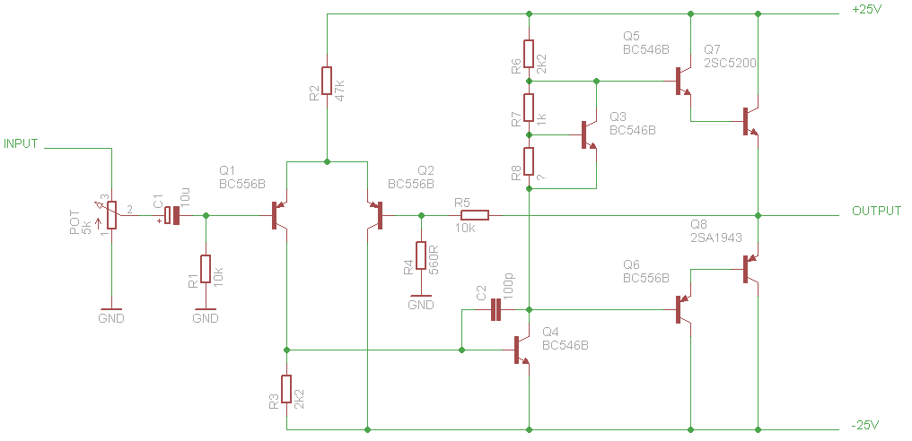

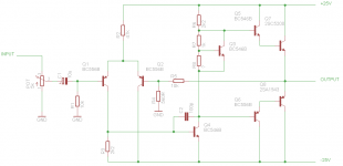

I want to etch some proper boards because what I have at the moment isn't ideal - flyleads between the PCB and outputs mounted on heatsink. I think I will put some base resistors on the outputs until I get make a proper PCB.
The basics of the layout look OK, feedback take off and so on.
(I don't usually check layouts here😉)

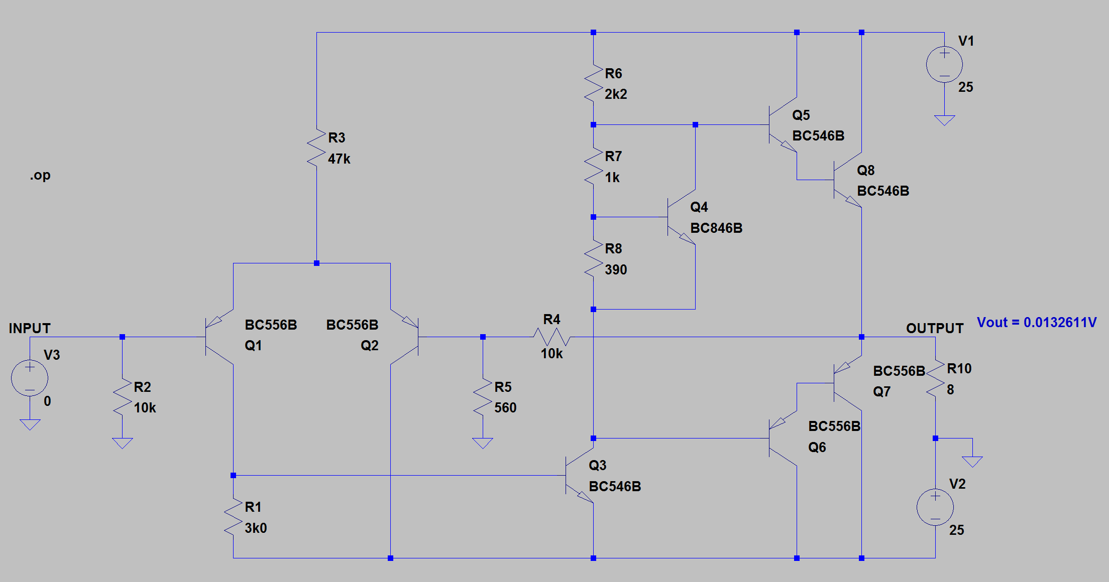

The downside to compactness is inductive and capacitive coupling between the input stage and the output. That couples power supply ripple into the signal and results in distortion - not the sweet, mellow H2 type either. In my limited PCB experience with making distortion comparisons, a bit more space between these nodes is a good idea for power amplifiers..... Any comments?....layout is 2x2" so nice and compact to keep parasitics to a min.
If you aren't too fussed with refinements, just build as you have drawn and consider improving it as you progress from mk1-mk2-mk99 etc.😀

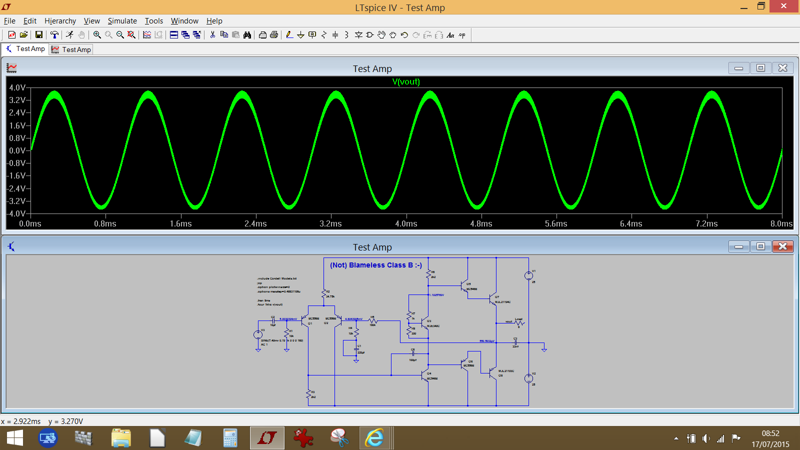

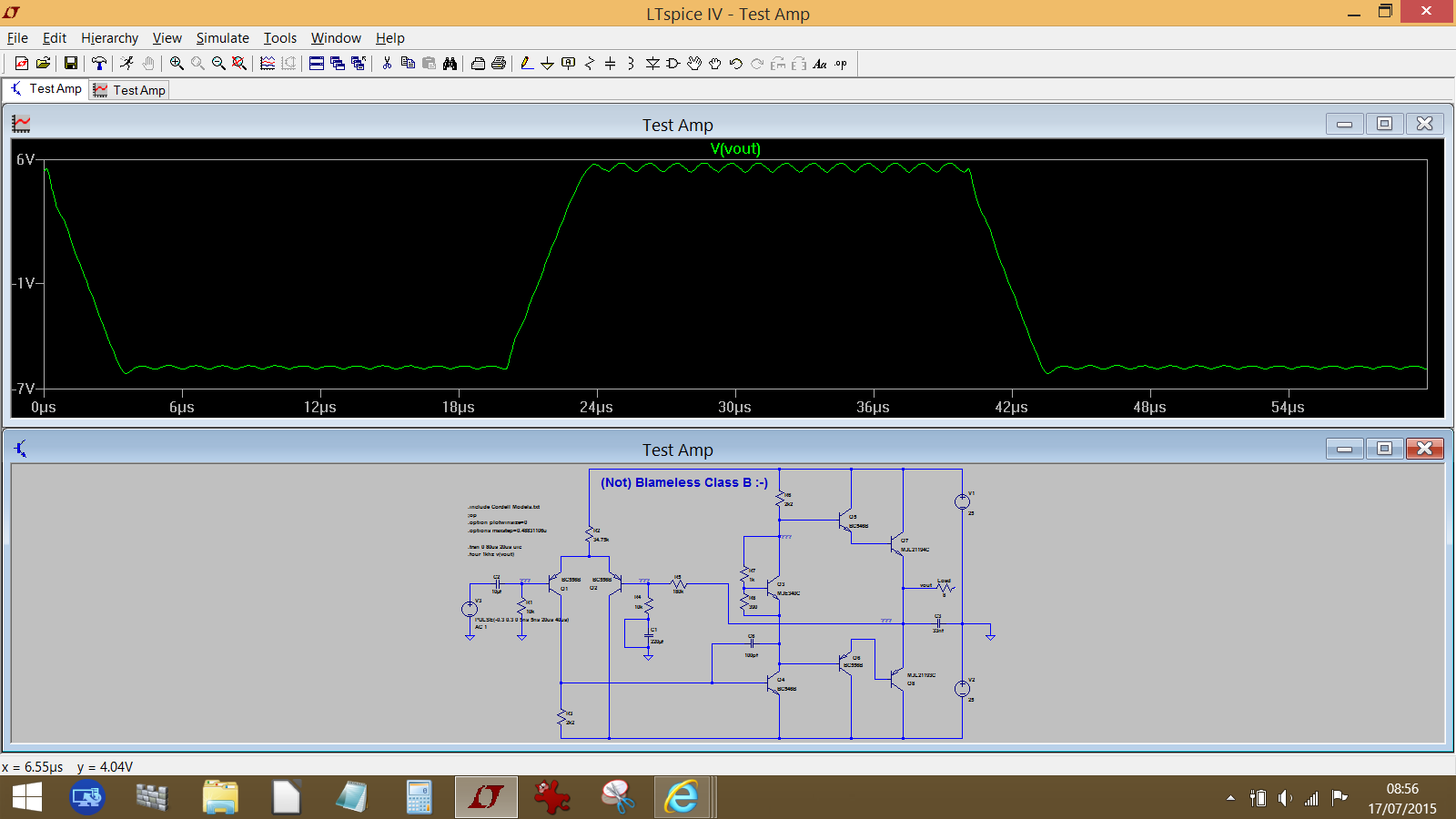

re: suck-out (or speed-up) caps. This definitely refers to the output transistors. They cannot lose stored base charge fast enough for the signal's rate of change around the crossover point. The cap provides a faster discharge path in EF designs but tough luck for CFP (complementary feedback pair) designs - they remain problematic.
You'll find this better explained with graphs and figures in section 5.3 referred to earlier.
thanks guys for taking the time to cast your eye over the board.... Ian you make a good point about coupling of the half wave high currents coupling with the sensitive small signal traces. I definitely want to refine and obsessively perfect the layout because I think this is going to be far more important to getting a good result than coming up with some fantastically complex schemat that in theory (ltSpice) is 0.00000001 % thd but in practice is a dud because of bad layout. I'm going to add an extra inch or so to the PCB and revise the layout tonight.
I am really nervous about the idea of a cap to suck out base charge. I see the benefit it brings to the table BUT.... that stored charge has to go somewhere, sometime, and to my thinking it has the potential to seriously upset the bias when it does. I will think on it some more.....
Perhaps just unfamiliar with the feature. It has been an integral part of many BJT switch designs for decades but for emitter follower output stages, a cap. is not strictly necessary if you are using more robust drivers with higher driver bias currents or simply not chasing the shortest switch-off delay...I am really nervous about the idea of a cap to suck out base charge. I see the benefit it brings to the table BUT.... that stored charge has to go somewhere, sometime, and to my thinking it has the potential to seriously upset the bias when it does. I will think on it some more.....
Clean switching performance is required for good class AB so if you want to use high Ft parts, their higher switching speed demands addressing this limitation - otherwise they're wasted, only contributing to instability. For more on how the cap helps, Google brings up a number of references including some helpful posts here. Try "Transistor base suck-out capacitor" and follow the trail.

It doesn't seem appropriate to focus on this one possible design refinement when the fundamentals are still in dire need of improvement, as Mooly has pointed out. After all, it's a cheaper than cheapo utility amplifier, not a hi-fi design to begin with. I don't see any problem with a 1uF 63V MKT cap. but if you intend to use SMT, suitable parts for many typical amplifier designs may prove difficult to source.
Build as originally designed again, with room for your modifications. Then alter it according to your plan and test, listen, verify results. I still suggest you don't use high Ft parts until stability proves very good, which means not with the Digi design as it is. In any case, an analog oscilloscope will be essential for checking this out and for properly investigating almost any audio design.
