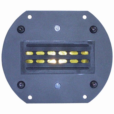

These beasties.
Looks like they need a waveguide, might mount them from the inside of the baffle and go nuts with the roundover bit.

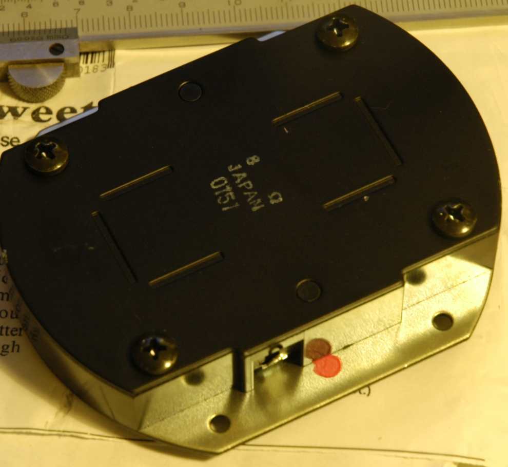

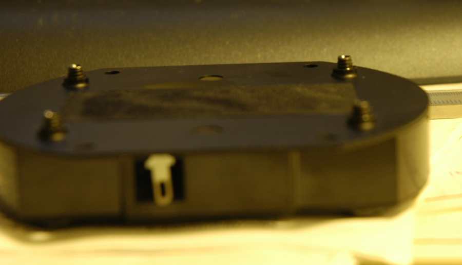

They arrived today.
Not exactlky as shown in the pictures, the four philips head screws come from the back, the threads protude slightly from the front.
the rolled threads in the front steel plate are stickong out the front as well.
the last slot to the bottom edge is 19mm, so if two were used in a mni line array the distance between the two groups of emission holes would be 38mm.

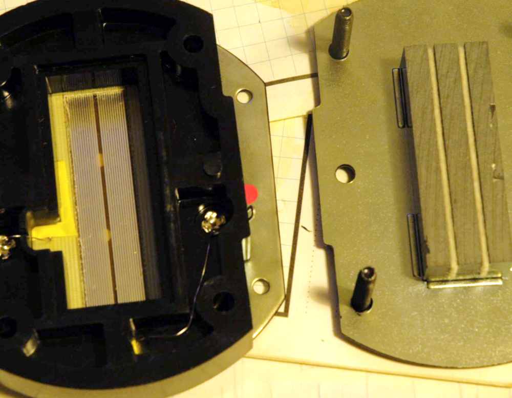

I pulled one apart to see if I can trim one end off to get two of these closer together on a single custom front plate. a 38mm gap is too big. It looks way too hard, I have emailed you the photos directly, the only thing I could do is a deep, hornlike waveguide to couple them together.
If anyone else wants high res pictures of these, (including the insides) PM me.
If you decide to take yours apart be careful, the magnetic field is pretty strong but the plastic dowels help a lot when putting it back together.
(On a second look the picture posted earlier is spot-on)
Front plate removed.
note the recessed screw threads on the fornt plate. not sure why they've done this. If you wanted to remove the protruding screws you'd have the drill the holes out larger, clean the swarf off the magnets, then use cap screws through the front with nuts on the back.

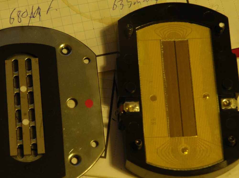

Here's the back plate, note the chips on the magnets and the loose fibres sticking out of the fibreglass circuit board.
Interesting arrangement of north south north magnetic feild with the current effectively going up one side and down the other. It explains why there's two rows of slots in the front.
Build quality is nowhere near as high as I expected, this is consumer grade boom box stuff.
