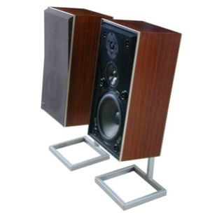

Very good to everyone. I show some aesthetic improvements that I have made on a couple of B&O Beovox S45-2 boxes. They are as you will know highly acclaimed boxes from the year 1982.
I have updated their capacitors (I would have liked to do it with film capacitors); perform internal damping and I have changed the fabrics of the grids.
I have used Sonic Barrier 1/2 "Acoustic Sound Damping Foam with PSA 18" x 24 "and Parts Express Speaker Grill Cloth Black Yard 70" Wide.
The side wood veneer I have embellished with brown wax for leather shoes.
The result I show photos.
The sound was already spectacular. Now it is even better.

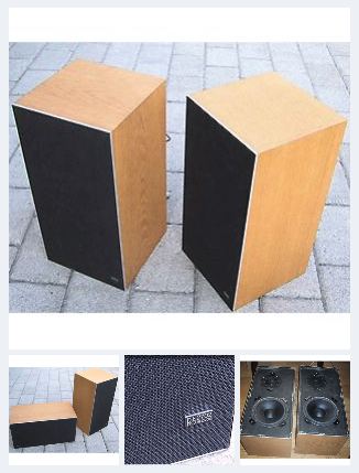

I think we all liked B&O speakers back in the 1970-80 era. They just looked terrific and sounded great. Black grilles, teak or rosewood cabinets and pretty aluminium trim. The ampifiers and turntables won design prizes too.
I owned a miniscule pair of Beovox 2702:
320459d1356890529-help-identify-seas-tweeters-beovox-2702-jpg
263213d1327920500-classic-monitor-designs-beovox_2702-jpg
5" paper bass, 2" SEAS H087 tweeter (also used in the Dynaco A25). Some nice touches like wall mounting holes on the back:
263215d1327920500-classic-monitor-designs-beovox_2702_rear-jpg
Crossovers were generally minimal. The smaller still Beovox 1702 with 4" bass was like this, though I'd now guess the bass was 4 ohms. The H087 I could look up, and I did, it's 6 ohms:
263214d1327920500-classic-monitor-designs-beovox_1702_crossover-jpg
B&O generally used Celestion and SEAS drivers with what is called high Qms or low-loss. Also 4 ohm units I think. DIN connectors were fashionable then, but dubious on tight connection by modern 4mm banana plug standards. Surprisingly scruffy crossover, but functional I suppose.
With respect ALPUY, you could tell us more here. I'd like to see the schematic. Also confirm the mid is in a little plastic enclosure. Measurements of speaker DCR would be of interest too, along with more detail about the driver models. You would then have made a good reference for people with this model, or interested in the design ideas.
It is often hard to get detail, but a classic speaker for sure.

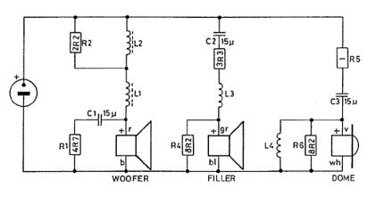

Good morning System 7. I have little to say about these wonderful speakers.
But I will tell you that the woofers are 8 "Peerlees; the mid (actually B&O does not call it medium but phase link) are 4" Seas 10FM, both 4 ohms; and the tweeter is Philips AD 162 T8 1 "and 8 ohms.
The crossover crosses at 3000 Hz 12dB octave, but the phase link is at that frequency at 6 dB octave.
It's a weird thing, because it would be a two-way with a speaker that phase compensates the mid frequencies.
The front of the boxes is designed in an inclined way, making the centers of the three speakers lie on the same plane. It will be so that they are in phase.

It says that the boxes are 29.5 liters, but according to the internal measurements (45 x 15 x 23.5 cm), we would have 15.8 liters.
I do not know inductor values.
Greetings.
Schematic is interesting. Don't really care who makes the drivers.

B&O developed something called the "Filler Driver". Idea was to eliminate time-delay.
You can build an 8" plus 1" two way.
714065d1541548033-restoring-monitor-audio-r300-bookshelf-speakers-ma-r300-md-4th-fr-png
715080d1542008118-restoring-monitor-audio-r300-bookshelf-speakers-steen-duelund-1-414-root-2-png
B&O's strange idea was to wire the bass and tweeter out of phase. Normally would sound a bit weird and phasey. A big suckout at crossover. Often considered a test of phase alignment.
But due to a bit of algebra, it turns out you can add a lower order mid and fill the hole. Obviously worked to some extent, if only on-axis.
A subject of deep interest to some people here. But I assure you even amateurs can discover interesting things with effort. TBH, I get frustrated at the secrecy in our industry. Holds back progress.
I'd better point out that the Peerless woofer in the S45-2 has a rubber surround so is not the same as the 'Japanese' woofer in the S35 which had a foam surround.
I note that the Beoworld specifications differ from yours, ALPUY.
In the B&O crossover, the 'filler' driver is a necessity because, at the crossover frequency, the woofer and the tweeter have the same amplitude but relative 180 degree phase shift so cancel themselves out. If the 'filler' unit was not there, there would be a huge amplitude dip at the crossover frequency.

Your renovation looks very nice and, in my opinion, you were right in using electrolytic capacitors to retain the original character of the loudspeaker.
