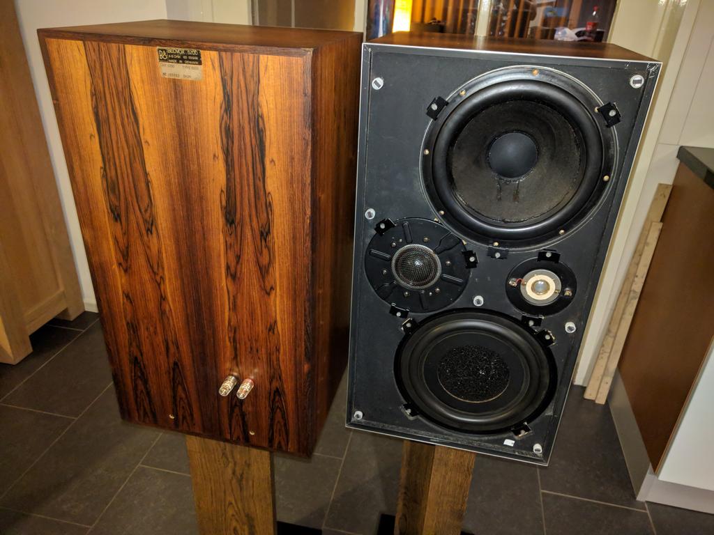

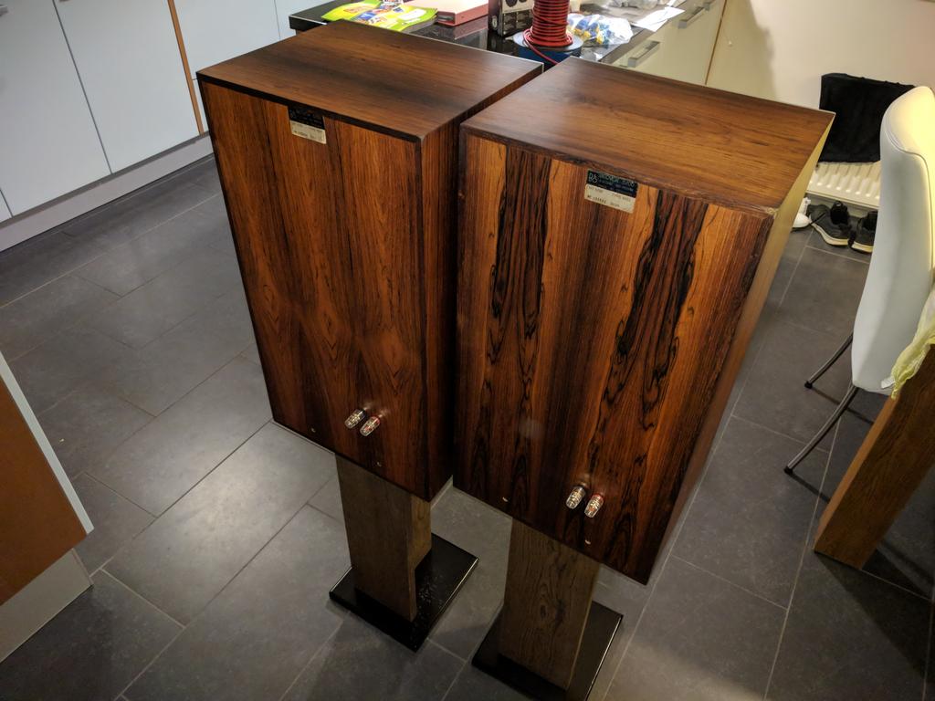

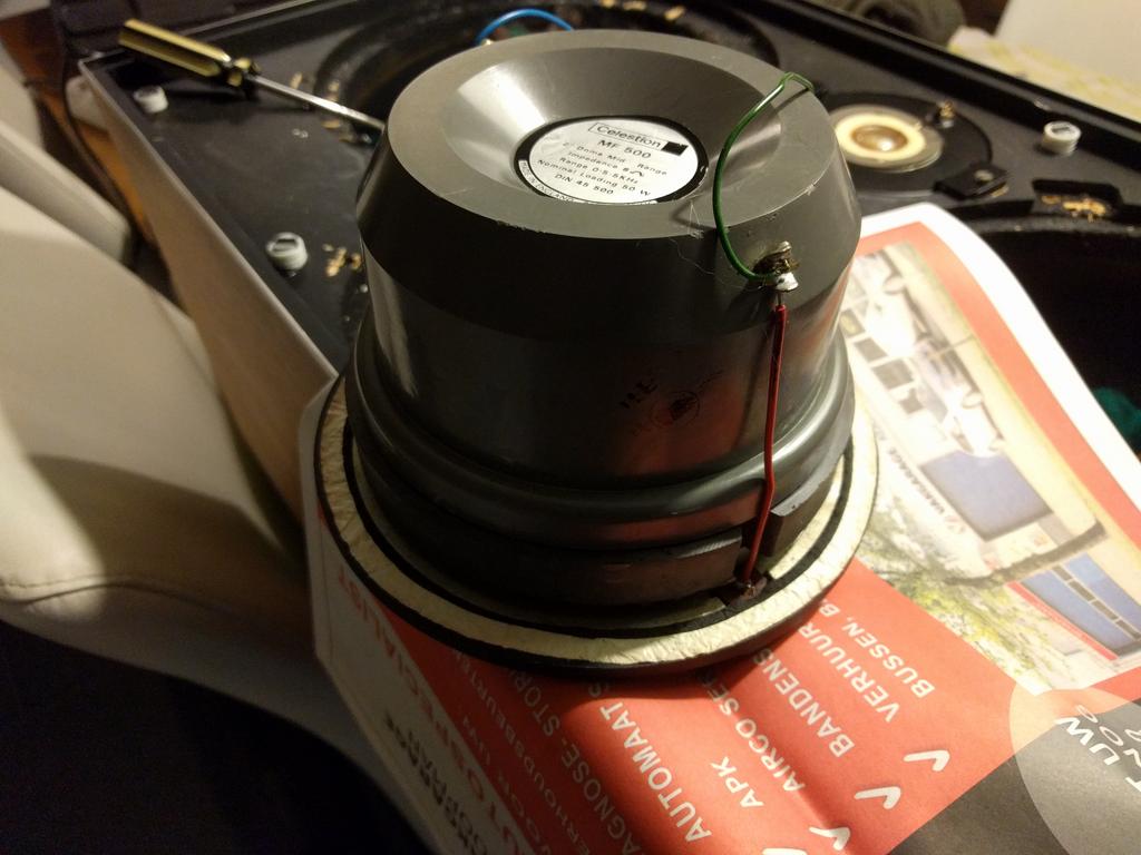

I acquired these speakers a while back.
The speakers looked terrible, they were scratched and smeared with white muck / paint, dusty and very dirty and sticky. At the top were circles in the wood of lime/water that had leaked from flower pots or something. The foam dust caps in the woofers were completely perished. The pieces of foam fell out when I removed the front.

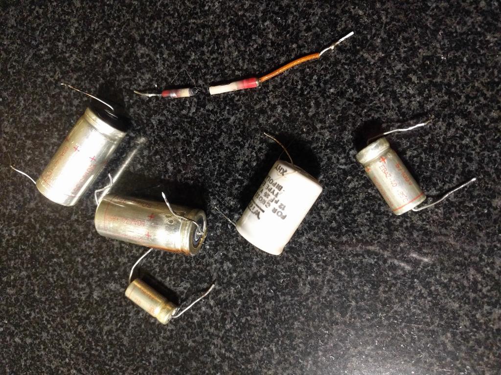

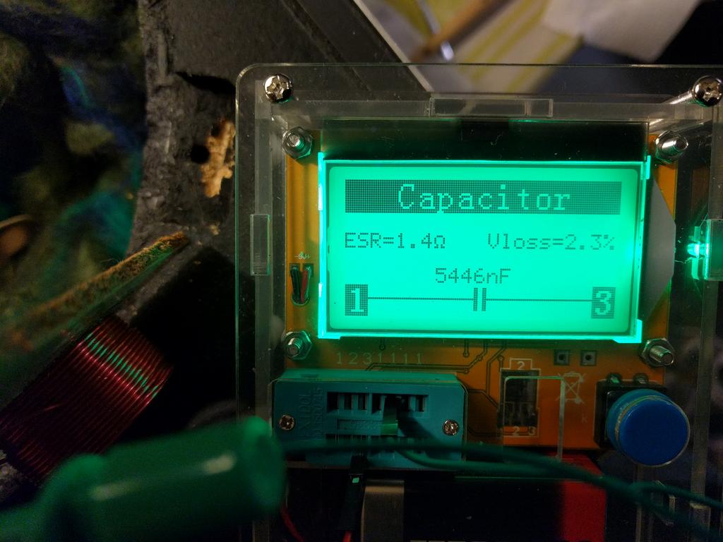

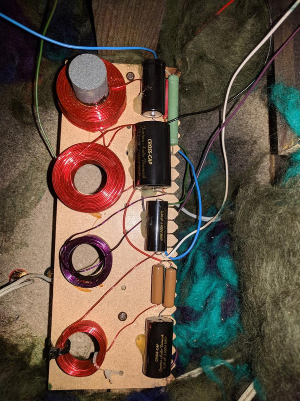

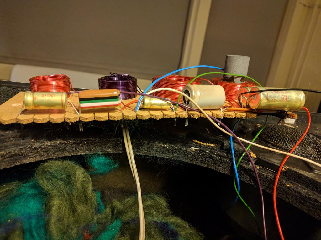

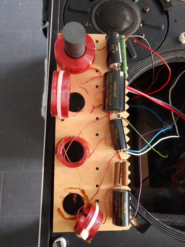

One of the resistors in the filter of a loudspeaker was completely burned out. Most electrolytic capacitors had wrong values and / or had an ESR of 1 to about 2 Ohm.
What have I done?
They play excellent again, these are really fine speakers!
Any opinions or remarks?

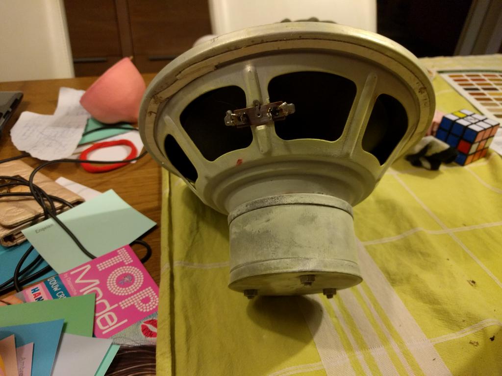

woofer: 22.5cm Philips AD 1056 / W8

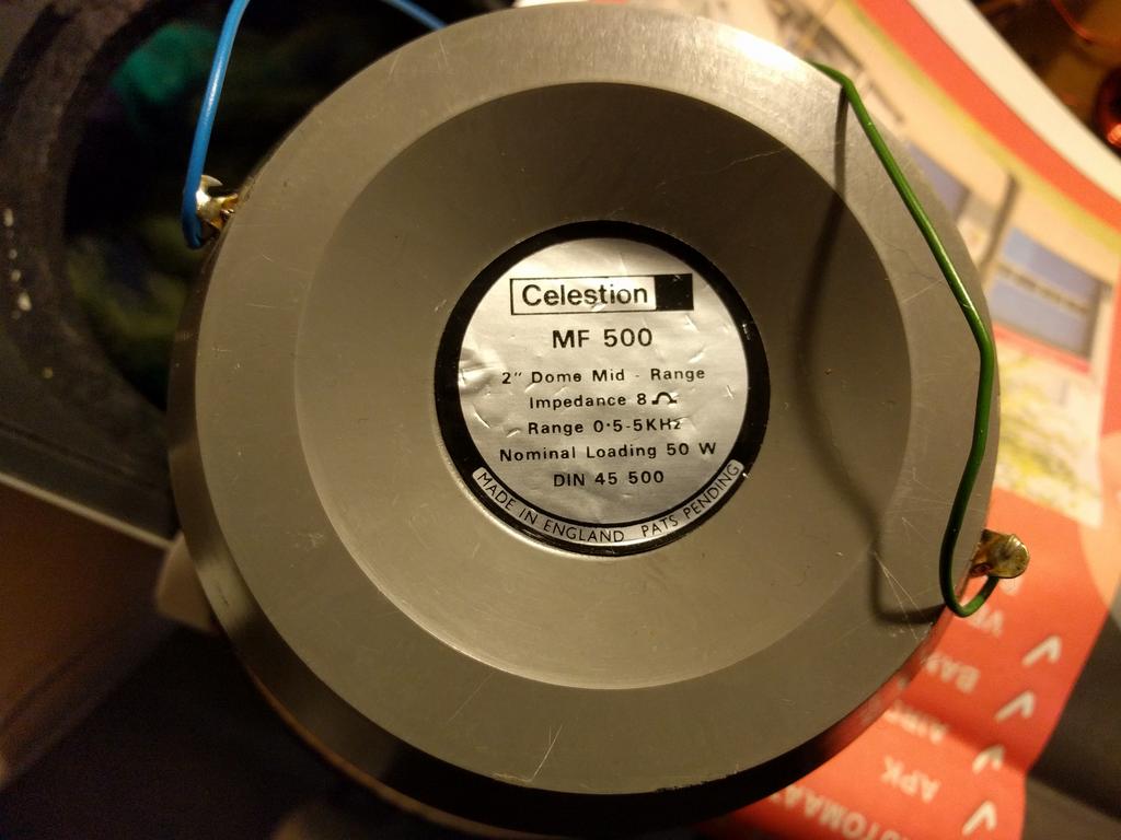

mid tone: Celestion MF 500
tweeter: Celestion HF 2000

Philips alnico woofer AD 1056 / W8

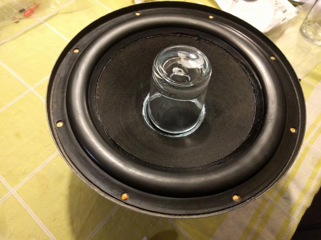

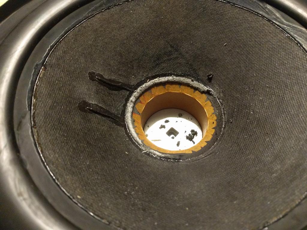

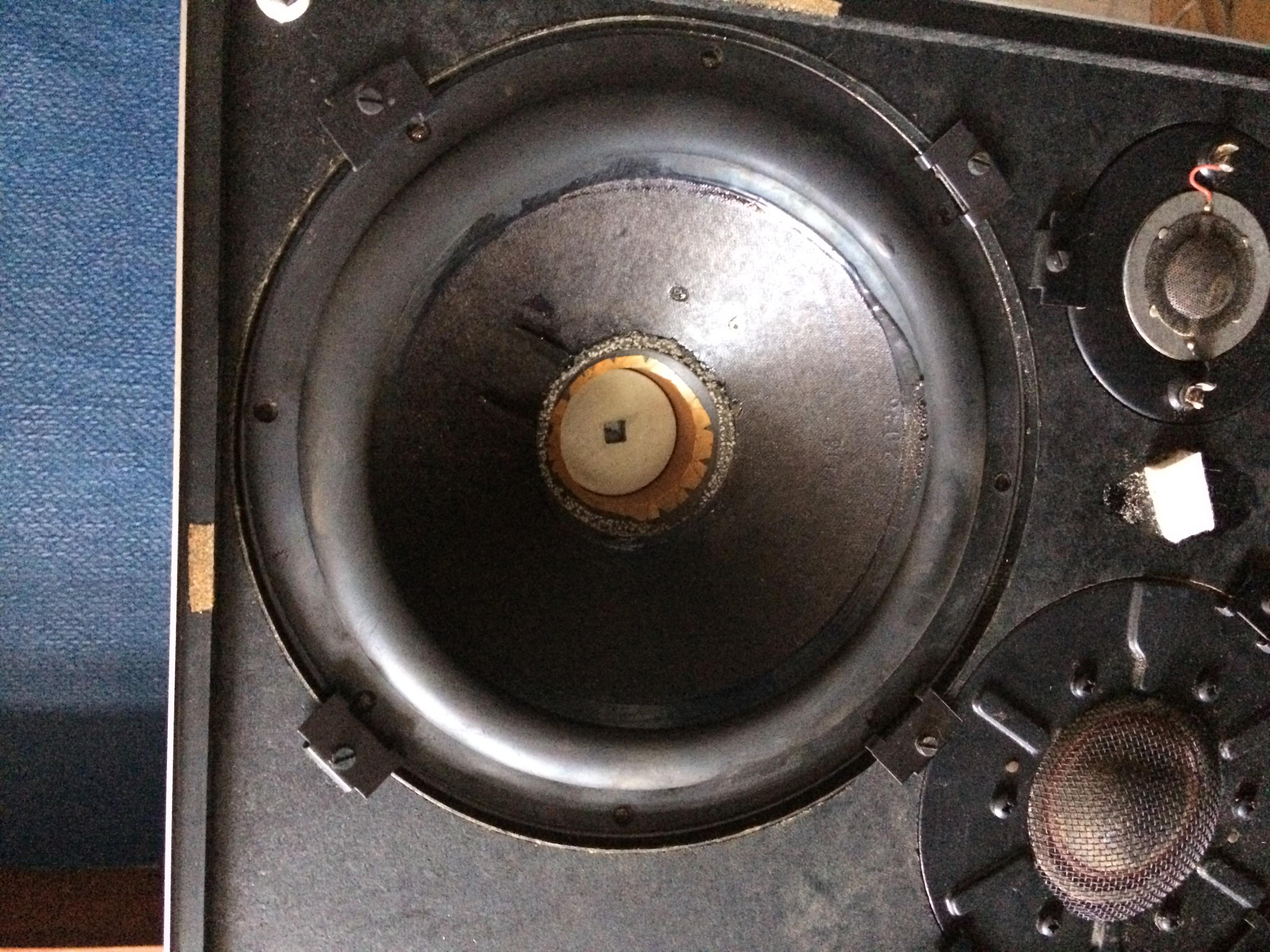

The philips AD 1056 / W8 woofer, the foam dust cover remnants for removal
New linen dust cover glued in, temporarily fixed and weighted with a glass
The crossover filter after upgrading with Jantzen Audio cross-cap MKP capacitors. The coils are rotated to minimize mutual crosstalk through the generated electromagnetic fields.
The old components, with the burnt-out / broken resistor of 22 ohms

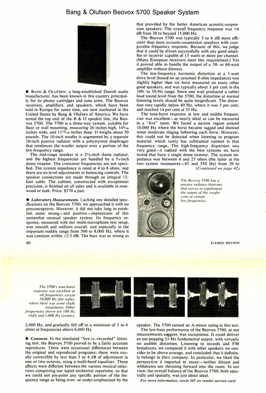

Above review of the speakers from the American magazine: stereo review, number 3 from 1972

- Crossover filters largely renewed / upgraded, all wrong value electrolytics capacitators of 44 years old off and replaced by Jantzen audio MKP capacitors that virtually do not age, and have much better specs (especially much lower ESR).
- The orientation of the coils adjusted to reduce crosstalk. To my surprise, Bang en Olufsen had not paid attention to this at the time of manufacturing.

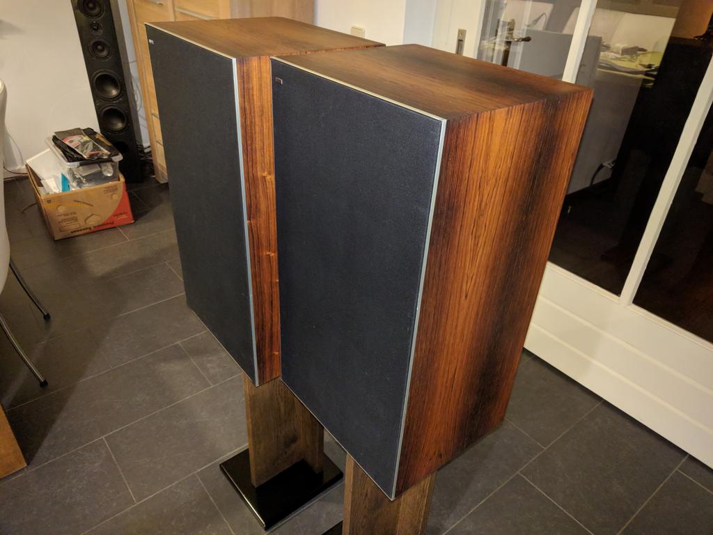

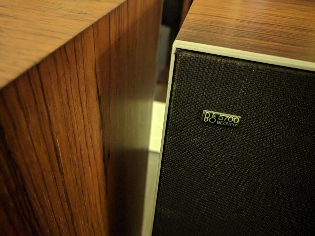

- The Rosewood veneer completely refurbished, all stains and the scratches and dirt removed, sanded and then oiled again. Sanded with grit 180 and grit 240, sanding only in the longitudinal direction of the wood grain! Treated the surface with hard wax oil from Rubio Monocoat.
- All units airtight fitted with new sealing tape.
- Mounted decent speaker terminals at the back, instead of the loose wires through a hole from the speaker.

They look absolutely stunning. Would be cool to give the grills a makeover as well. One note about the electrolytic caps: the higher ESR might very well have contributed to the low end sound as well as attenuation of tweeter and mid. It might be worth considering those influences.
I am aware that the ESR can influence the filter characteristic. But they sound good. Maybe the lows may be a bit more present. But I have the 2 electroytic capacitors for the low replaced by one electroytic capacitor. Comparable ESR is then plausible and the influence on the lows is comparable to the original.
Great renovation! Enjoy that retro sound!
Nice to see those quality Philips and Celestion drivers. I've opened three 70s B&O speakers now, only to discover drivers marked 'Made in Japan' and plagued with crumbling foam surrounds or softened, misshapen rubber ones.
The method of crossover board construction (coils glued to hardboard, NP electrolytics and slim wirewound resistors) was obviously standard for B&O during that era, regardless of the retail price of the speaker.

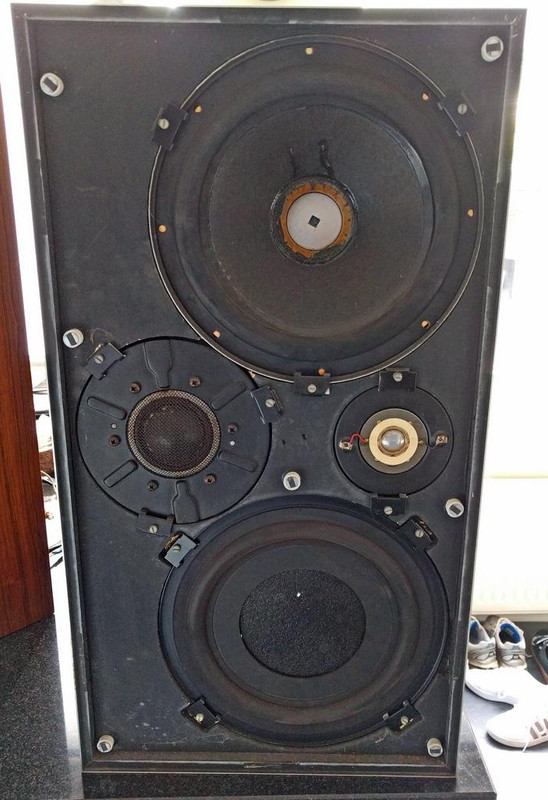

I was given a these exact speakers with one of them seriously lacking in midrange. The dust caps were also missing. I've since replaced those as well as the capacitors on both crossovers and they are now sounding brilliant. The state of the original resistors was frightening, burnt out and crumbling!
I still have to sort out the appearance of the speaker cabinet. Like your's, there are stains and various scratches all over the surface of both cabinets.

As this is an old thread, I'll submit an answer to your question.. . . when you spoke of sealing the cabinets, what do you actually mean? What do you seal?
If the drivers are not sealed to the cabinet using foam sealing gaskets then nasty noises can result as air blows and sucks through the leaks.
A sealing gasket can be clearly seen in the photo of the woofer. Foam sealing tape is commercially available.

Screwdriver is not a good idea. You need a glazing pry bar and always, always put something like a piece of wood between the cabinet and the pry bar. It gives you leverage and prevents damage to the cabinet. Also, if you can, run a flexible utility knife around the basket to see if you cut the sealant a bit first. If you just pry away, you can actually rip a bit of cabinet off.
The Red Devil one you see here is available in almost any hardware store.

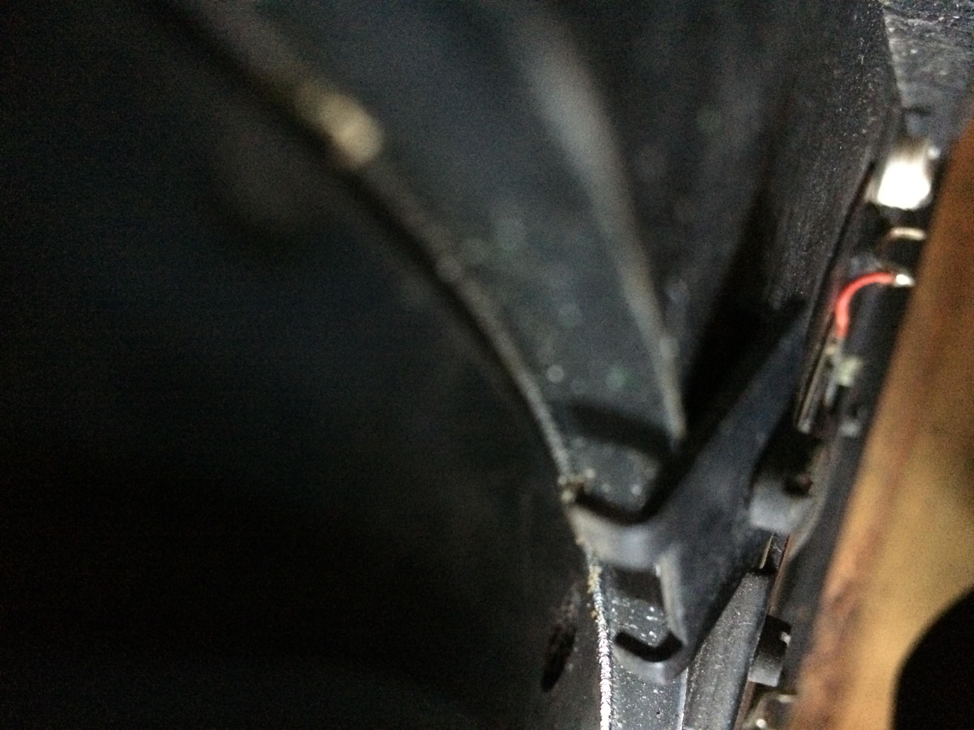

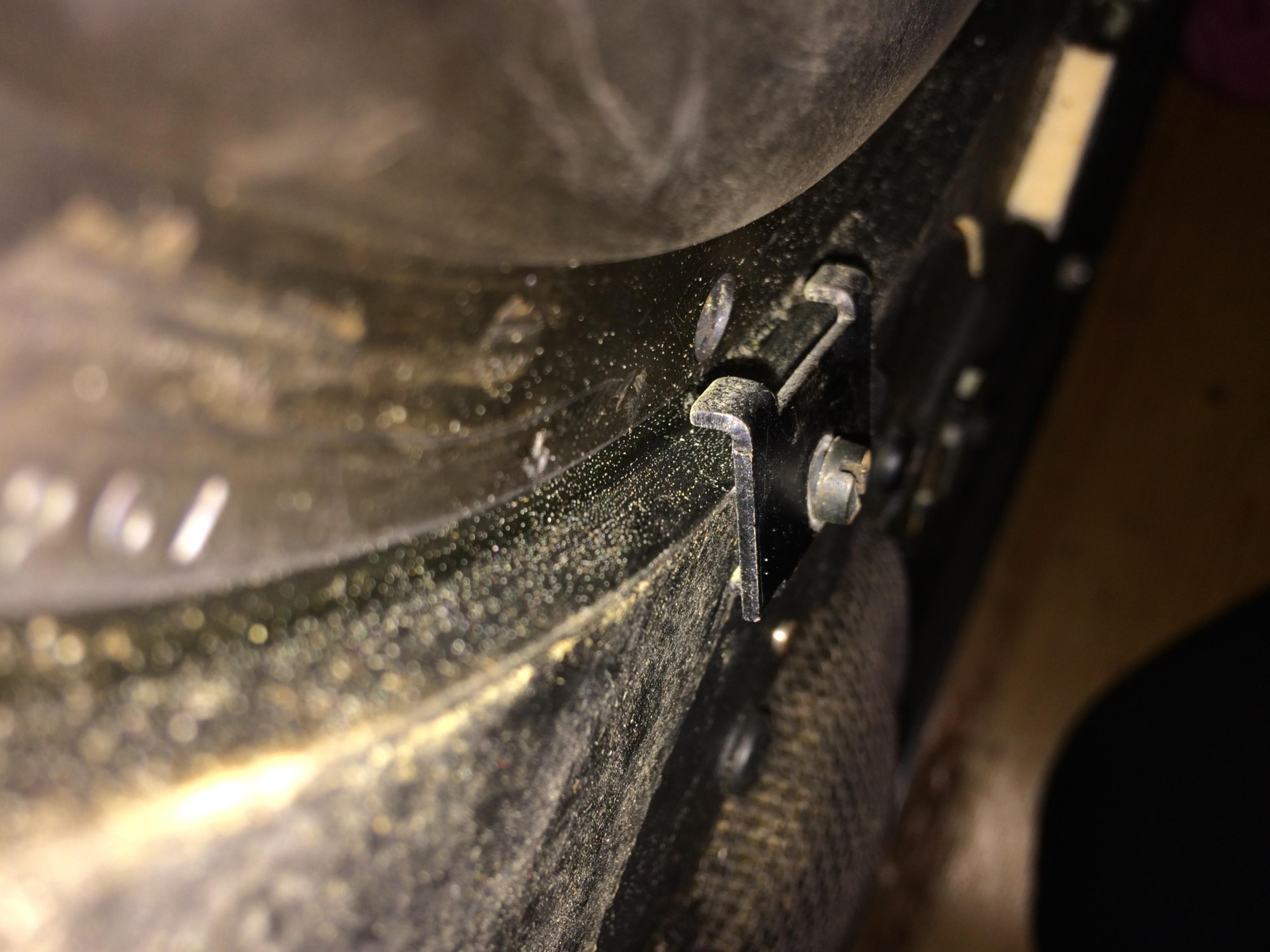

I have a tool like this and have just tried after running a knife around but it's still not budging. The drivers are recessed into the cabinet which makes getting any kind of outwards levering force v difficult.
I've also noticed that the clamps around the woofers seem not to be making any contact with the driver itself, with no other visible mounting screws (!). Is it really possible that they've just been glued in with no other reinforcement?
Pics attached hopefully.
