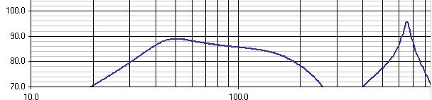

The vent is an open pipe, i.e. a 1/2 WL resonator with both even and odd harmonics, so can be quite musical when long enough to comb filter with the speaker's output: Resonances of open air columns
GM
Ok, I'm interested in learning how that peak and subsequent ones can be made less by a Helmholtz resonator. Are you suggesting a chamber off the tube? Would I need equipment or can it be done by math? I guess the chamber volume and where it would be placed in the tube would be what you need. How could we design an adjustable one where the reduction could be measured with a spl meter while playing a certain sine wave?
One other way is to add a resonator "stub" that's tuned to 650 Hz to the vent itself. I personally haven't tried this, but there is a thread across on the PE site somewhere where someone demonstrated how this was done for a small vented speaker with a long vent - he used a stub to tame the out of band resonance caused by the vent.

First, keep in mind that a Helmholtz resonator is a box and tube, like a vented speaker without the speaker driver. This requires some volume in and of itself, and that volume might be better used in the sub by increasing the front chamber volume.
If you want to try it just to see how it works, how effective it is, etc. then to answer your question about making an adjustable one, just use an adjustable port tube and have that sticking out of the box of the adsorber. As you change the port tube length you will also be changing the tuning.

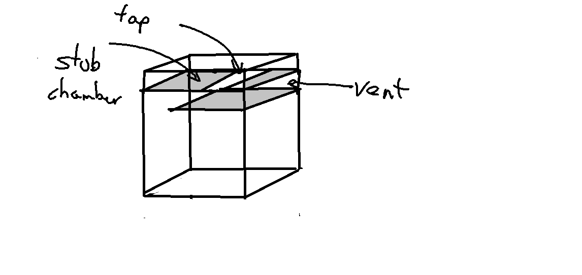

If you implement the vent as a shelf vent at the bottom of the cabinet, then you could include a resonance "stub" chamber there as well. If you design the cabinet with easy access to the chamber in mind (make the outside panel removable), that should give you a means of easily making changes to the chamber to see what impact that has on dealing with the out of band peaks in the bandpass sub's response.
I was thinking of trying a similar approach in my next TH build (converting the back panel into a stub chamber, so I could do the same thing). I haven't "run the numbers yet" though.

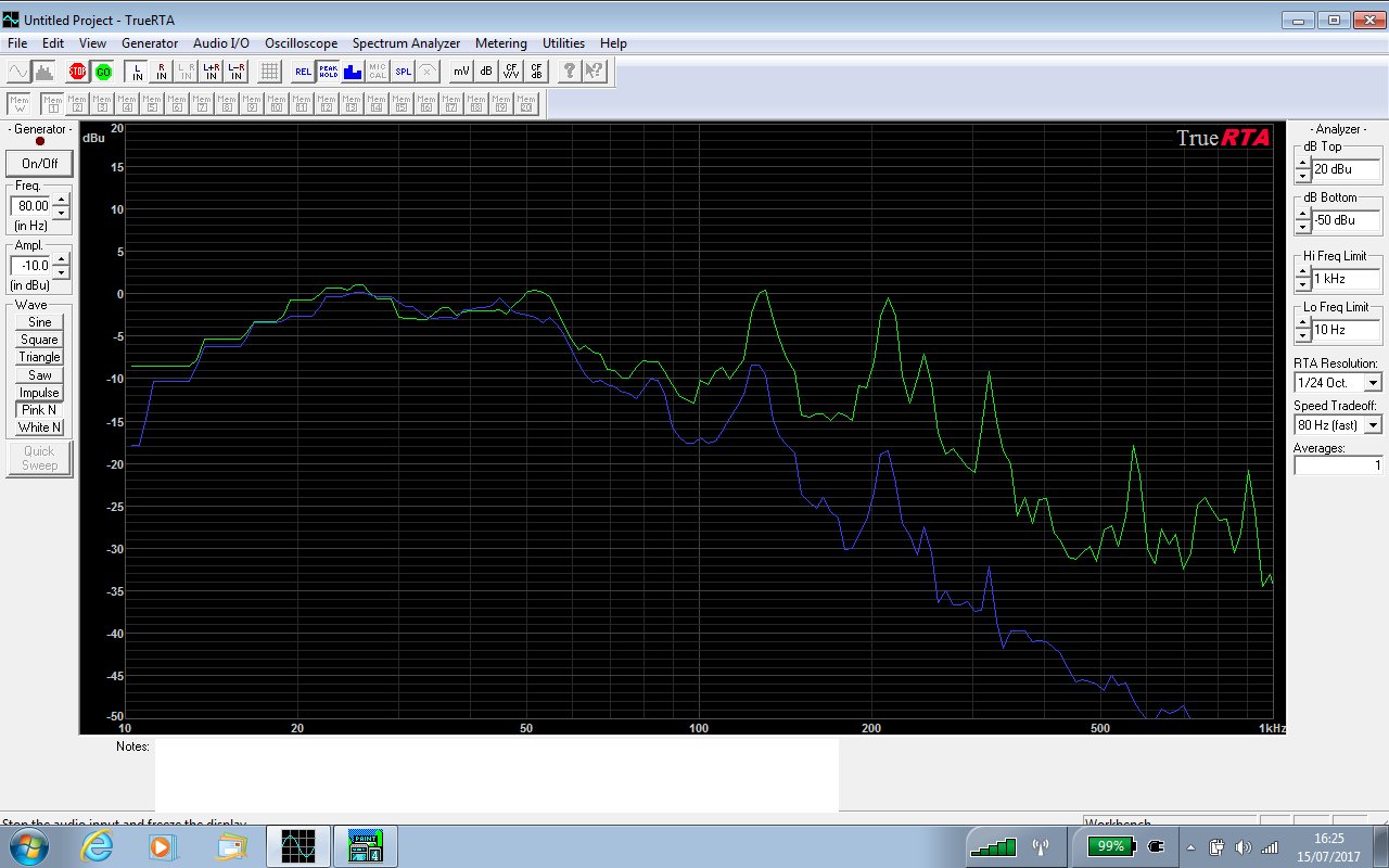

Do you also have a crossover that rolls off power to the driver well below the port self-resonance? I was assuming this was the case...
If not, then the driver's own output will also excite the port resonance and your EQ notches will reduce it. But the resonance can still be excited when there is low frequency input to the BP system causing lots of air movement in the duct. If you test using a sweep you will not see this, because by the time the sweep reaches the port self-resonance frequency the low frequency energy has dies out. You would probably have to measure with wideband white noise to see it in your measurement.
It's a physical resonance of the port tube, so any energy at the resonant frequency reaching the port tube will make it resonate.

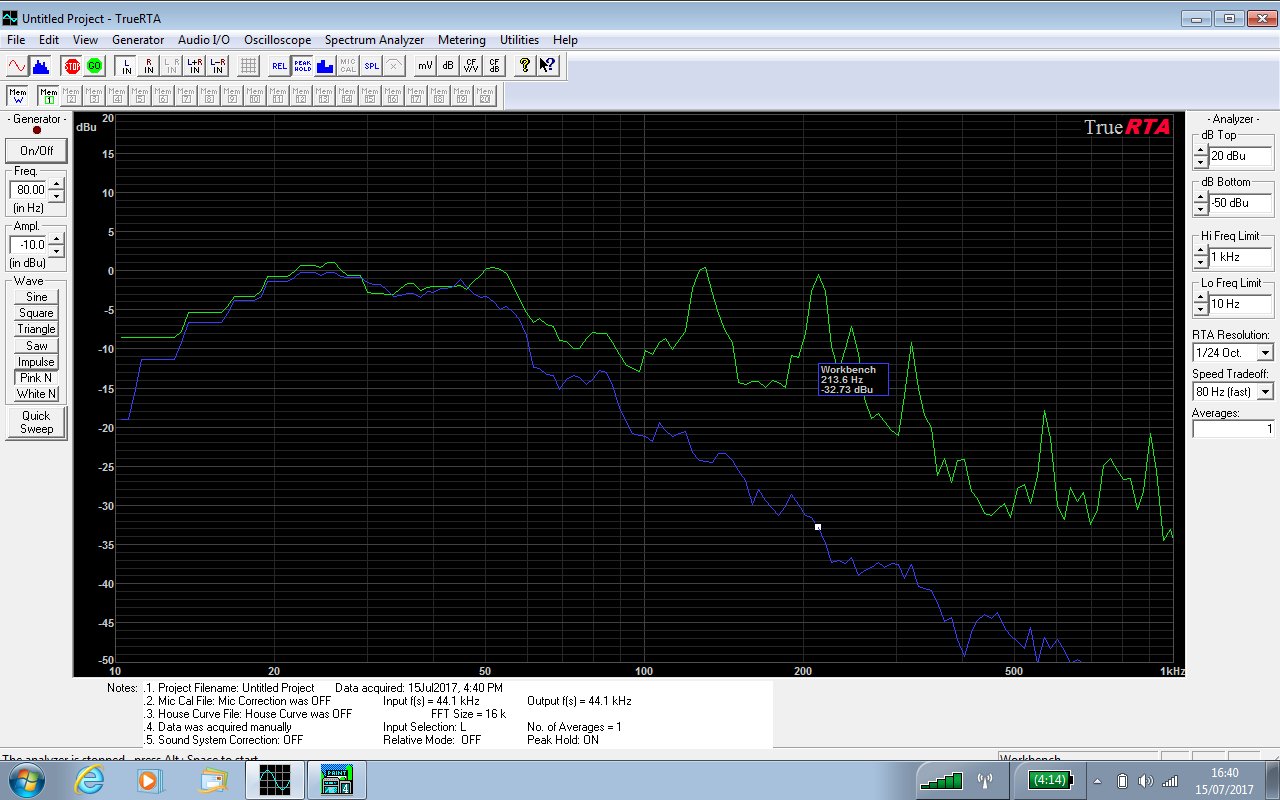

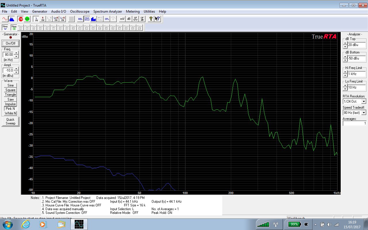

Here's 3 screenshots.
1st is unfiltered sub output with pink noise. (green trace in all 3 shots)
2nd is pink noise with lowpass filter (sub out) (blue trace)
3rd is pink noise with lowpass filter plus notch filters. (blue trace)
What are the dimensions of your port?
Here's the info for both ports. As you can see the measured resonances are pretty close to the predicted ones.

I think what is happening is that the resonances are so close to the driver passband that the driver's own output is still providing energy that is exciting the resonance(s) even after adding the LP filter. You can see that the area under the peak of the 110Hz resonance is about the same, and the 220Hz resonance is reduced slightly. The third one around 330Hz has been reduced in magnitude by about half because the driver output is 24dB down or more and this level is starting to be weak enough to provide to too little energy for much in the way of resonance to happen, but it's still there.
This is not quite the same as the case for the OP, where the first resonance is way up at 650Hz. Your first resonance is at 110Hz, and the driver is only down 10dB from your LP filter at that point. That's not all that much in absolute terms. -10dB = 1/3.16 ~ one third of the pressure. Even 20dB down, which seems like a lot, is only 1/10th the pressure.
By notching out the driver output at these frequencies you are probably killing off most of the energy from the driver output, much more than the LP filter alone. But like I mentioned before, there will still be some energy that can be generated by turbulent flow in the port at high output levels that can excite the port resonances just like when you blow over an empty bottle. This would be most noticeable on something with lots of LF energy (esp. below the F3 of the sub), where there is lots of air flow through the port. You can also use a HP filter there to reduce the electrical input at F<F3 if you want to prevent that kind of thing.
