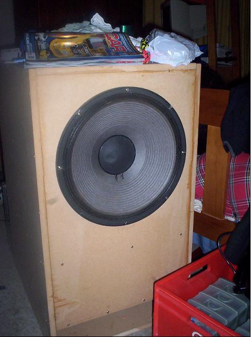

All these huge excursion CHEAP drivers have fine specs,but when the kilowatts are being applied and those woofers are flying about, theyl be distortion,and the tumult has a MEASURED THD unlike the others. And more distortion means you can localise it. In the end it comes down to using twice the volume of boxes for two cheepes to achieve the same SPL as one goodie.
Id be more interested in their spectral contamination[two tone etc] and steady state THD
[400 or 800litre horn soon]
edit:
Re: bass reflex
Note that people do a maximally flat alignment[modeled in 2pi space] So the moment you place this woofer in a corner its louder and boomier ![energising LF room modes more easily than sealed simply because it has more output]
Design the subwoofer with an overdamped alignment[impossible
with some] and better sound should result.
Oh come on paul,the subwoofers will have 70hz or lower lowpass wont it?I think the Ascendant Audio Atlas subs are worth looking at. They need less power than their avalanch subs and have the lowest inductance of any subs I've seen - 0.96 mH, which means superior transient response.
my 2226 hits 12m/s peak with the amplifier I have,The pressure at the port is quite nice* design for < 34m/s vent velocity
edit:
Build one.Itl be loud enough. Infact, dont build one because the FR has a bump in the midbass[seems to need adjustment imao,prolly reduce rear chamber abit]If you're looking at SPL at 30 Hz and more, you could build 2-3 Tempest Bass Horn for insane SPL, but not much response under 25 Hz.
Re: bass reflex
