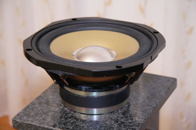

Is this a Type - 100SW/4A? Bass response looks good. How does it sound? Do you remember Bandora? In Poland they had a really good review - 8 years ago.

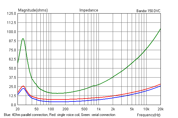

Impedance plot for different VC connections:
Single
Fs = 25.92 Hz
Re = 7.20 ohms[dc]
Le = 1886.43 uH
L2 = 683.03 uH
R2 = 11.21 ohms
Qt = 0.70
Qes = 0.97
Qms = 2.48
Parallel
Fs = 25.75 Hz
Re = 3.97 ohms[dc]
Le = 1766.56 uH
L2 = 721.27 uH
R2 = 11.89 ohms
Qt = 0.43
Qes = 0.52
Qms = 2.45
Series
Fs = 25.72 Hz
Re = 16.28 ohms[dc]
Le = 7326.46 uH
L2 = 2802.40 uH
R2 = 46.48 ohms
Qt = 0.43
Qes = 0.53
Qms = 2.43
