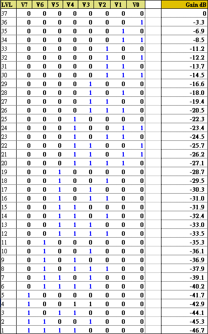

LVL01 is the maximum attenuation. Below LVL01 is mute state, and opamp output relay will open.
LVL37 is 0dB attenuation, all 8 shunt relays are open.
LVL38~39 are the active gain state, audio signals are rounted to the variable gain opamp, without passing through the shunt relay attenuator. The comparator is connected as non-inverting for these 2 levels.
