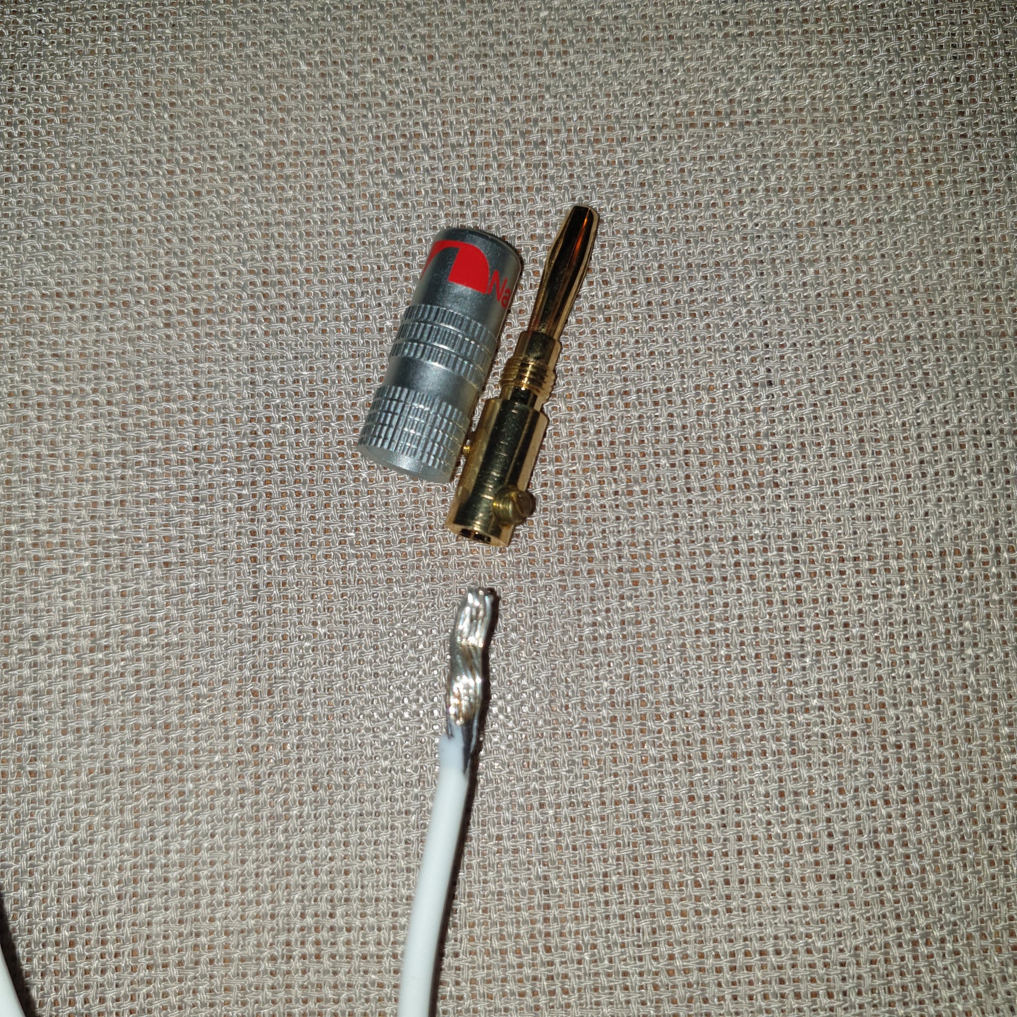

Hi.I am happy with Nakamichi banana plugs and i recommend them but i see that there is some oxidation with my 12 awg silver plated copper teflon cable.There is not much oxidation inside of plug but there is some in the beginning of the plug. For a more reliable and quality connection should i coat copper with solder or use endseal terminal for better connection inside of the plug? Maybe like these ones

NO! The reason for tinning the ends is two fold. One it readies the end for solder. You are not soldering.should i coat copper with solder or use endseal terminal for better connection inside of the plug?
Two to keep the end from fraying and corrosion prevention. It's not a good idea to put a lesser conductive
material BETWEEN two pieces of copper, copper silver or silver silver. Why would you put LEAD there or lead
with 4% silver at best?
You are trying to make a better cable?

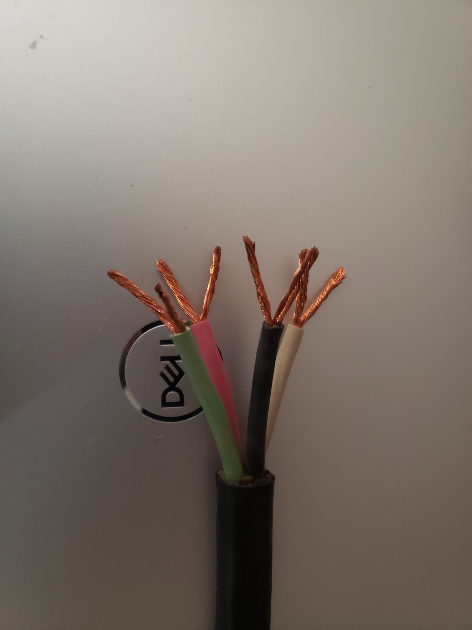

How to prepare a wire end with NO SOLDER.
You always split the number of strands in half, then split them again.
Now twist all 4 stands CW, now take two of the 4 and twist them CW, do that same to the other two
You now have two, twist those two CW into one. That is the proper way to prepare a wire to stuff in a barrel.
You can half the work for smaller wire.
Now dip the bare wire in any contact enhancer/corrosion prevention goop you want to use and stuff the
wire into the bore twisting CW until you hit bottom. Tighten the first screw (at the base) while holding
it tight in the barrel. Now tighten the screw closest to the banana. Go back and forth several times
retightening the screws. Add a drop of LocTite on top of the counter sunk screws. Let it dry.
Add your shrink tube.

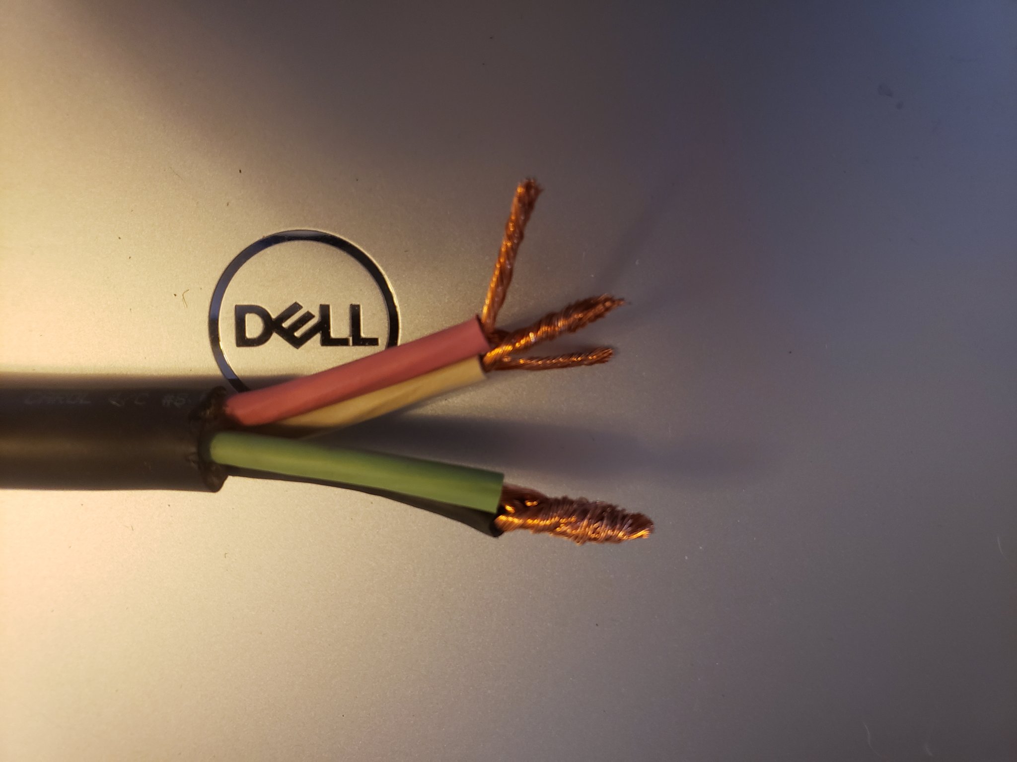

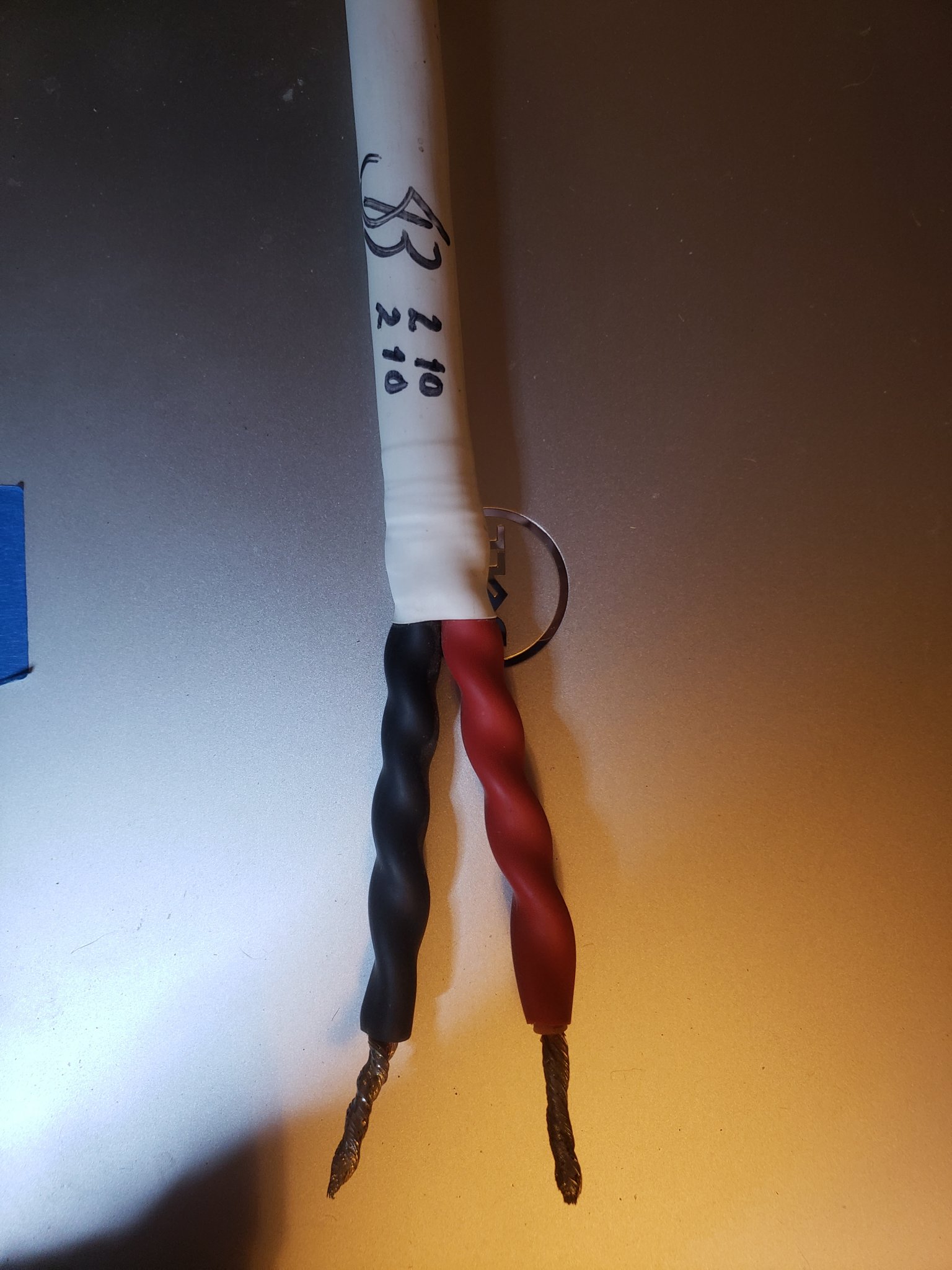

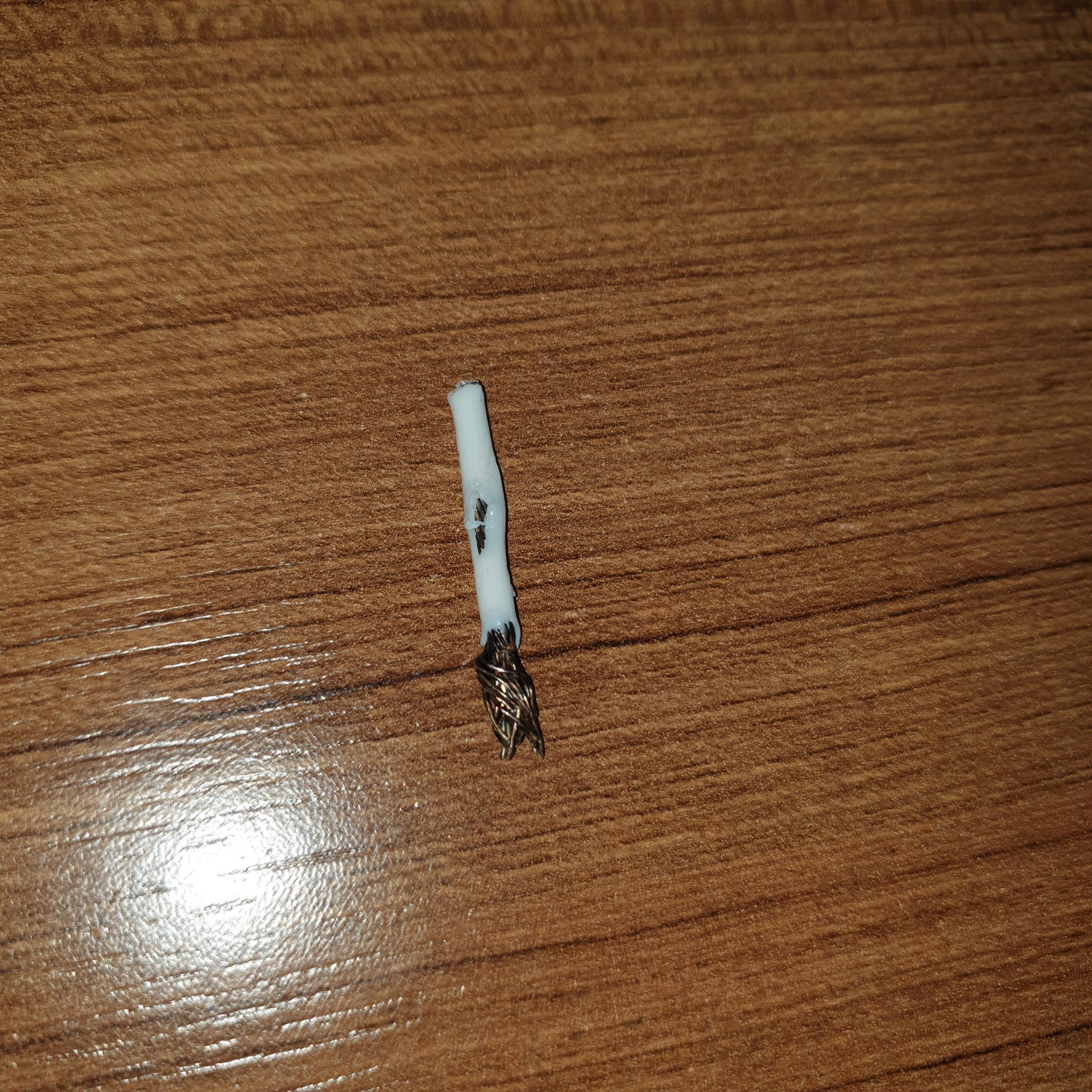

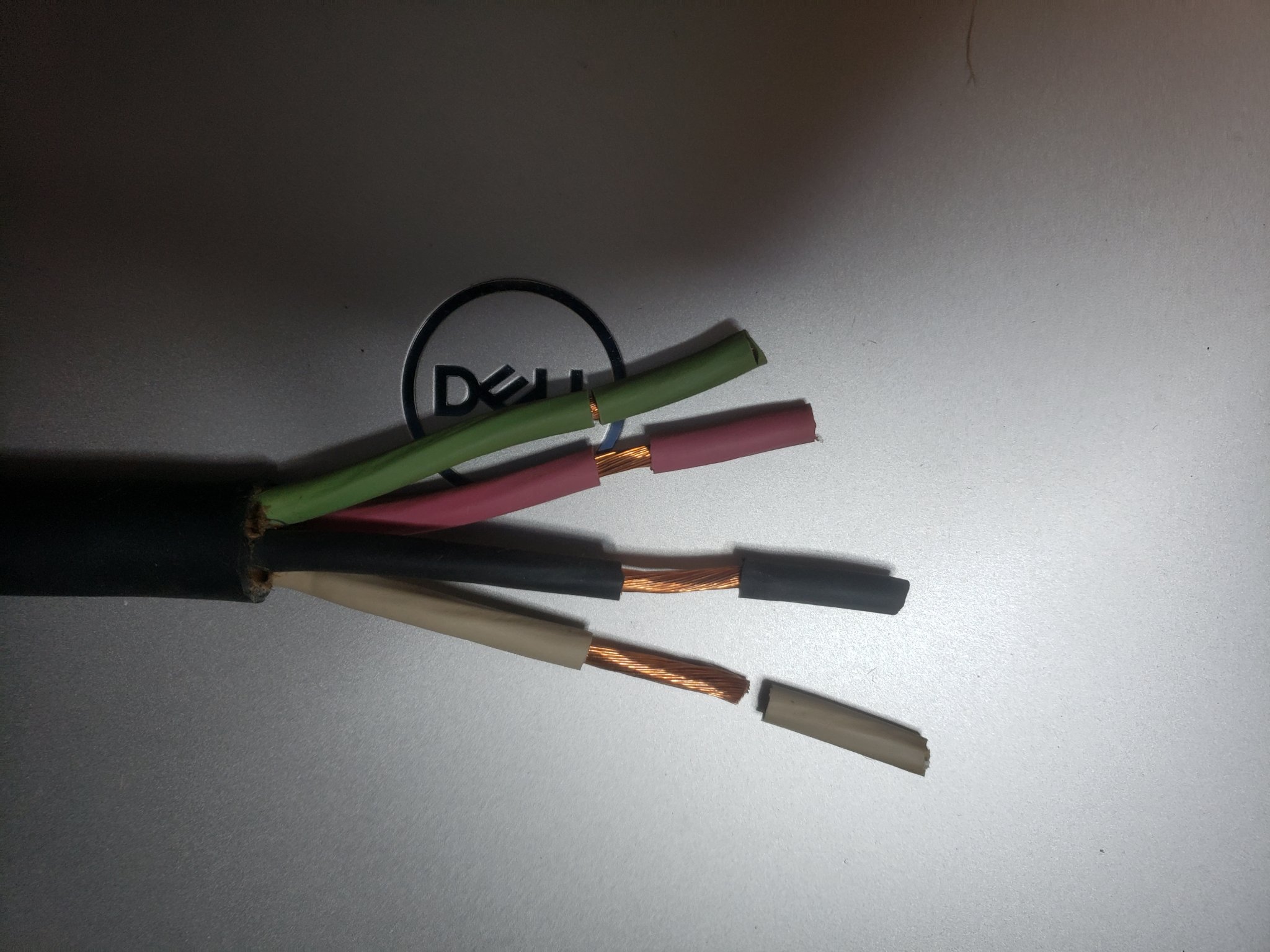

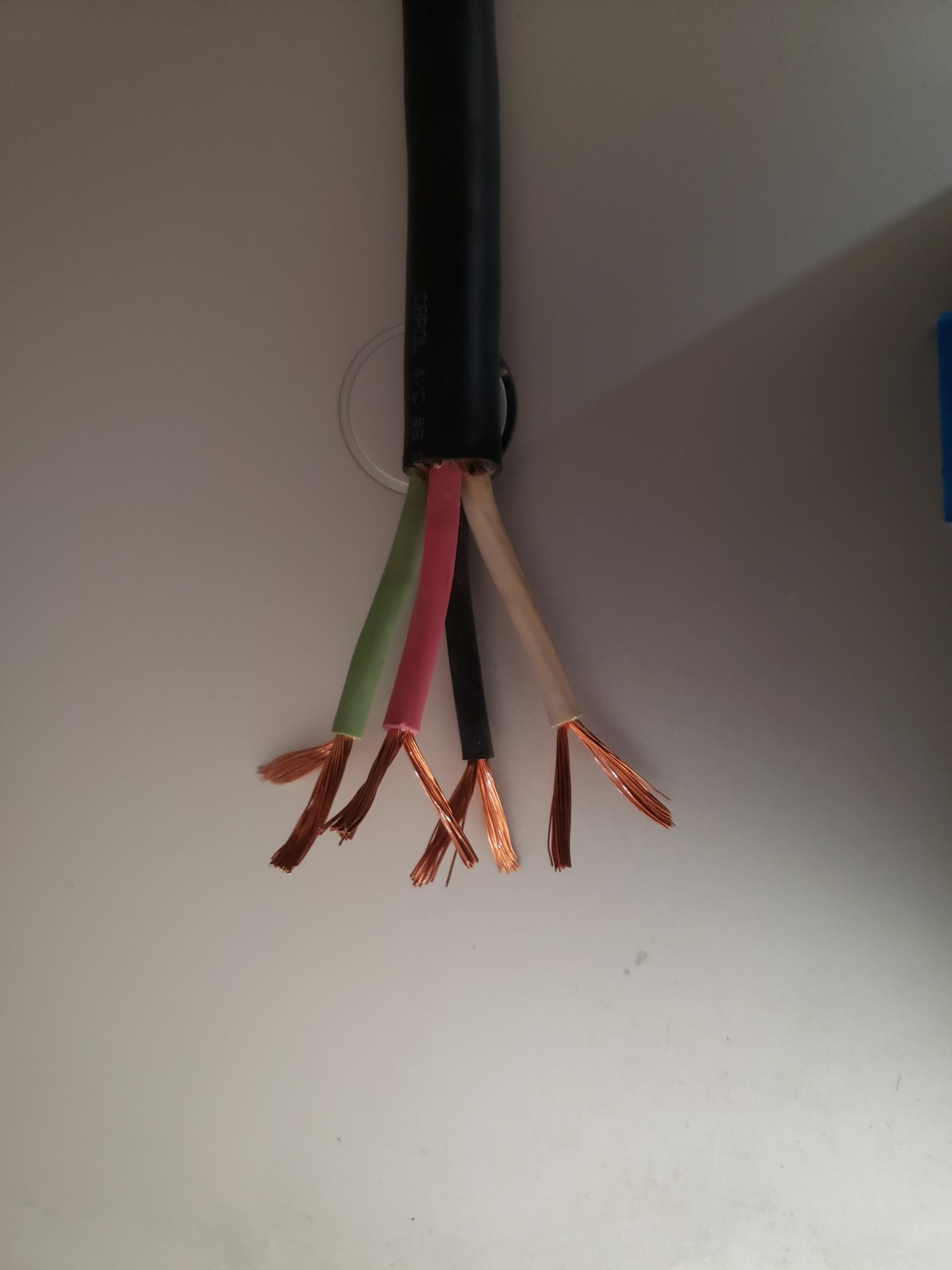

I did this quickly after I took some ibuprofen.🙂 This Is 8/4 SOOW (600vac). You can see it is not fine strands
nor is it easy to work with. Thin strands make this job a snap for a while. LOL
The end is ready to be treated with your favorite goop, dust, stuff or whatever else you can think up. I use
graphite dust. Stuff the 4th pic (green/black) in a barrel tighten the screws or use a compound crimper on
heavy barrels.
