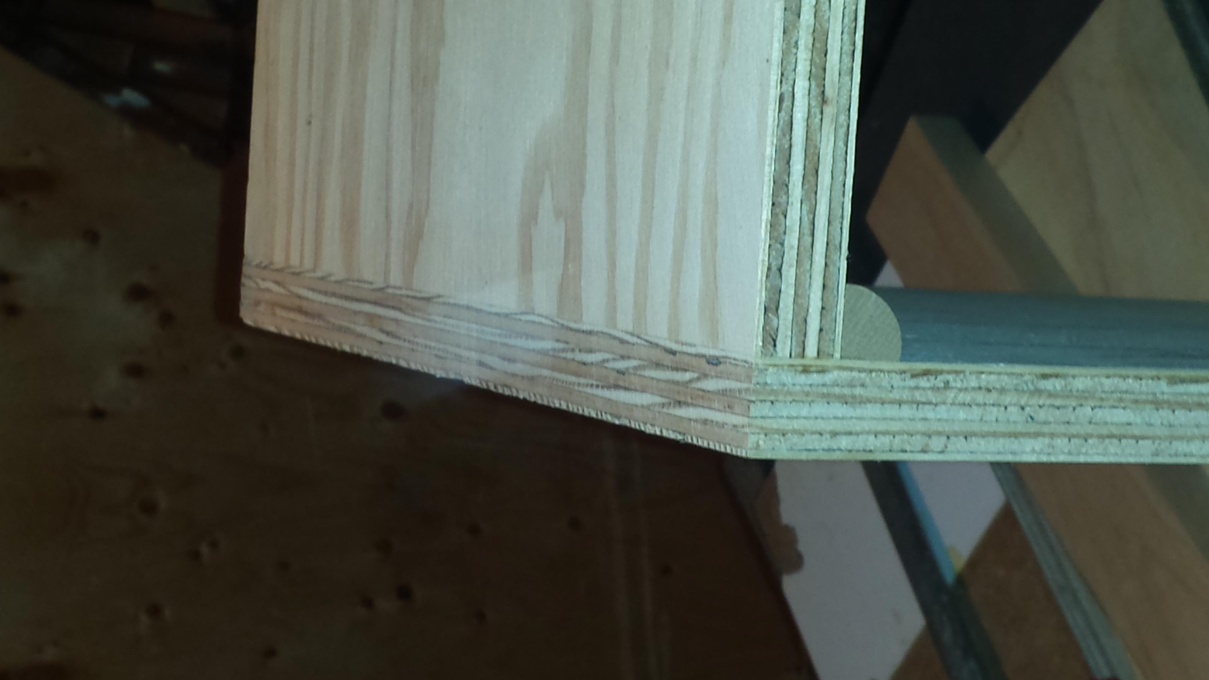

I really wonder if the issue is the panels expanding. Plywood and, especially, Baltic Birch is exceptionally stable along its face because of the alternating grain. Wood expands laterally more than it expands longitudinally. If the plywood was expanding this much, I would expect it to begin delaminating.
Here's my off-the-wall theory: The front and read panels were always oversized and the veneer covered the gap, supported by the glue underneath which has dried and contracted causing the difference to become visible.

I built speakers few months ago. I made the cabinets out of moisture-proof 18 mm baltic birch plywood
Did you use real baltic birch?
I ask because there is a 4x8 sheet of 13 ply sold locally that is from China. They call it baltic birch. Cheaper version for cabinet makers. Probably more warp resistant than 5 ply and that's what they care most about. It has overlapping plys and voids, splintery, doesn't smell right, glue is not moisture proof and it is whiter than real BB.
Real BB is 5 foot square, and has the purple stamp in cyrillic.
It is real baltic birch. I bought it from a good place, that is only selling baltic birch. I'm not sure what the moisture proof means, I thought it makes it more stable.
They do have big warehouses, so there must be quite big moisture difference, but I bought the material in the end of summer, so it was dry. Anyway the speakers were fine, and it took me long time to veneer it. After veneering they were fine for 2 months sitting at my desk. And the horrible Autumn has been wery humid for about 2 months. For me the strange part is, why did the panels move suddenly standing on my desk. That is a long time sitting in the same climate, and a very fast sudden expansion.

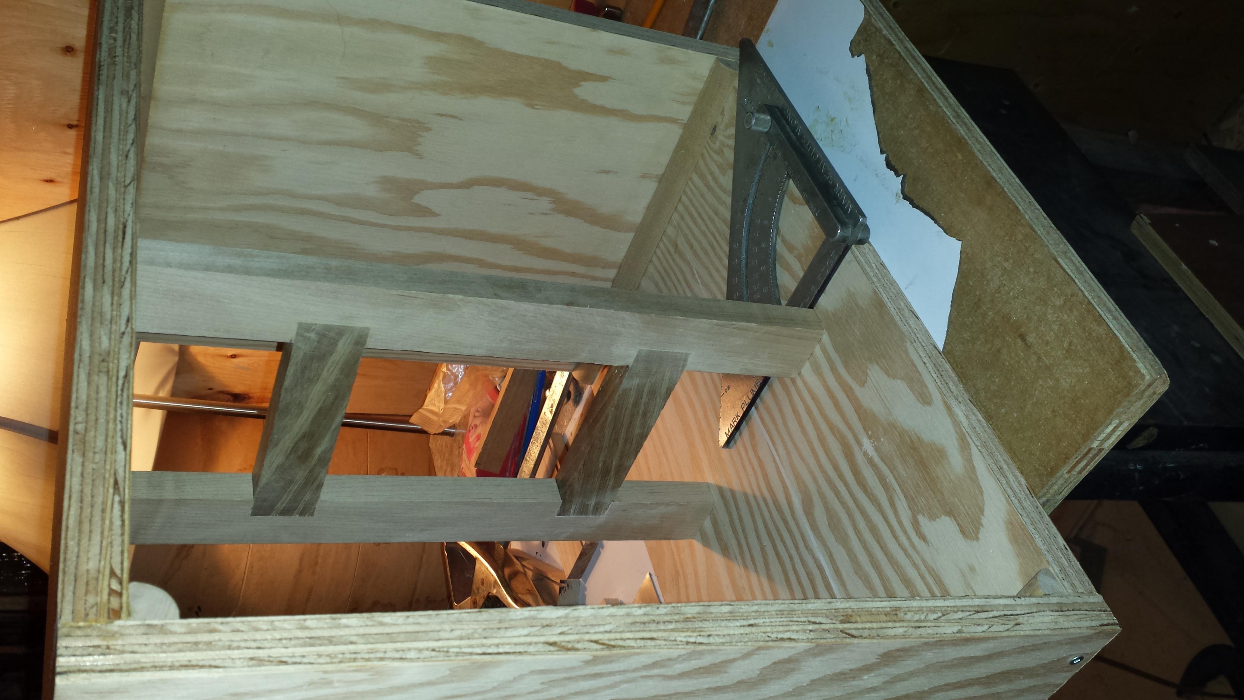

And yes it is panels expanding. Like I said, I did not veneer the bottom, and there can see how the panels are not flush any more. No cracking.
Next time I will use 45 degree joints, add a few screws and front, back panels will go inside the other panels. That would force them to move together. Probably will let them be unfinished for a long time, to see how they react.
Current speakers, I have decided not to fix them right now. I will probably wait for spring to see if it shrinks back. And there is a strange voice in my head that wants to build 2.5 out of these. Maybe I'll try to sell them for a break even price. So someone could enjoy great speakers for more than reasonable price. And the most satisfying thing about those speakers is, that I wanted smaller speakers, that would be as good as the Yamahas, that can be seen on the pictures ns-515f. And they came out sounding a lot better, costing 1/3 the price.
