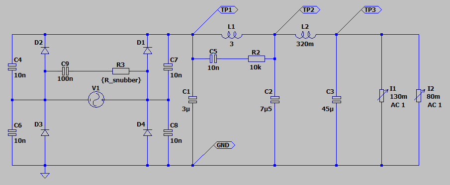

As per title, what kind of PSRR value is to be expected from a typical push-pull power output stage, say a 6L6 in regular transformer-coupled circuit without negative feedback, perhaps in a realistic situation where tubes age and the stage might not be perfectly balanced ?
I just need a rough ballpark figure to estimate how crazy I have to get on power supply ripple filtering; the input stage will be regulated.

When it comes to power supplies, I am a believer in Brute Force.
I not only consider rectifier ripple (2X line frequency), I consider the load signal current ripple.
Consider the capacitive reactance at 120Hz (full wave center tapped, or bridge rectification).
I use 200uF or 500uF to "power" the center tap of a push pull output transformer.
200uF @ 120Hz, Xc = 6.63 Ohms. (13.3 Ohms at 60Hz)
13.3 Ohms is probably good enough when the upright bass plays a 60Hz note
200uF @ 20Hz, Xc = 39.8 Ohms.
Suppose the 20Hz signal current is 70mA peak, that is 0.070A x 39.8 Ohms = 2.79 Volts peak 20Hz signal ripple.
Is that good enough?
Suppose the plate swing at 20Hz is 200 volts, and the 20Hz ripple is 2.79V.
20 Log (2.79V/200V) = -37.1 dB.
Want to reduce it by another 7.96 dB, then use a 500uF cap instead of a 200uF cap.
-37.1 dB or -45dB; 200uF versus 500uF respectively.

I'm more into lower capacitances figures as I use paper in oil caps (motor runs). My current design has only 45uF finals. If bass isn't satifactory I have the options to go to maybe 80-100uF or crank up the input cap to get more voltage from the PT and stick a regulator on the B+. BUT I want to try it without regulation first.Both 200uF or a 500uF are probably good enough, a 20 second long very loud 30 foot organ pipe will reduce your B+ anyway, but that is one extreme example for the average listener.
That being said I've pretty much given up hopes of having bass on par with solid-state from a tube amp. The figures you mention would required a hefty power supply... Still I try to get better chances with a PT having 3.7x the required VA rating and a low impedance filter chain (36 ohms series DC resistance).

Try 45uF!
A 6000 Ohm plate to plate output transformer; when one tube is cut off, the other tube is driving 1500 Ohms.
Consider a low frequency note of 30Hz.
45uF Xc @ 30Hz = 117.9 Ohms
117.9 Ohms is in series with 1500 Ohms.
That is 117.9 + 1500 Ohms = 1617.9 Ohms the increased impedance that the driving 6L6 plate "sees"
As a voltage divider at 30Hz, 1500 / 1617.9 = 0.927.
0.927 = -0.657 dB.
Of course, the output transformer's primary inductance may be attenuating the signal even further.
At 100H plate to plate, that would be only 25H plate to center tap, the 6L6 has to drive this too.
25H @ 30 Hz = 4712 Ohms inductive reactance.
Compare that to the 1500 Ohms, it increased the load by about 30% at 30Hz.
An average electric bass guitar plays down to just over 40Hz.

Oh I forgot to mention the output stage is class A. I'm not advanced enough to design a proper AB stage...when one tube is cut off, the other tube is driving 1500 Ohms.
This eases the power supply requirements a lot since the load is more constant and almost perfectly balanced hence better PSRR through common-mode rejection.
Actually, the j117.9 ohms adds at right angles to the 1500 ohms, so the attenuation is even less.
The way to look at it is the pole frequency between the load impedance and the cap. 45 uF and 1500 ohms is a 2.35 Hz cutoff frequency. You want this frequency to be at least 5 times lower than the lowest frequency you want to reproduce. Rule of thumb says this is half a dB down. For 30 Hz operation, you are doing quite well. Even if you consider the loading for two channels plus some for previous stages. Doesn’t take near as much cap with loads of a k or more, compared to 4 ohms for two channels of SS.

Suppose one 6L6 current ranges from 10mA (near cutoff, but not at cutoff), to quiescent of 50mA, to peak of 110mA.
(40 mA less than quiescent, and 60 mA more than quiescent) . . .
While the other tube is doing the opposite . . . going from 60mA more than quiescent, to quiescent of 50mA, to 40mA less than quiescent.
Those are merely approximations, but as you can see, the Class A load on the B+ is fairly constant.
Yes, wg_ski was right, it is a complex load.

The stage being class A, doesn't both tubes see the whole OPT primary impedance at all times at AC? My OPT is 5K P-P, should be easy to drive...

There are a couple of ways to analyze a Class A push pull output stage.
You probably know this, but let's entertain everyone, especially the Newbies.
To make calculations simple, connect the 6L6 tubes in Triode Wired Mode.
The 6L6 "triode-wired" plate impedance, rp, is about 1250 Ohms (actually closer to 1700 Ohms, but to simplify the discussion, 1250 Ohms).
Your 5k p-p primary is also 1250 Ohms from plate to center tap, and the other plate to the center tap is also 1250 Ohms.
Both tubes are always on in Class A.
We can easily find a Triode Wired Pentode or Triode Wired Beam Power tube at certain voltages and currents that has an rp of 1250 Ohms.
This thread uses 6L6, so we tweaked on the element spacings, and got 1250 Ohms rp.
1. "Parallel" operation analysis:
Class A operation only
Each "triode" drives 1250 Ohms, but one triode pushes up 1250 Ohms, while the pull triode pulls down 1250 Ohms.
The two tubes are Aiding Each Other.
So, consider two parallel 1250 Ohm triodes driving a single 1250 Ohm primary winding.
With 1250 Ohms rp in parallel with another 1250 Ohm rp, we effectively have 1250/2 = 625 Ohms driving 1250 Ohms primary winding.
That gives a damping factor of 2.0 at the primary, if we could have a lossless transformer, that would give a damping factor at the seondary of 2.0.
DF of 2.0, before global negative feedback is applied (or we could choose to Not use global negative feedback).

Here's the passive part of the PSU so far. The input capacitor is there to adjust the output voltage for two possible scenarios, either with output stage B+ regulation or not. The 3H is 26 ohms DCR and the little 320mH is 10 ohms DCR. C1-C3 are paper in oil motor run caps.
