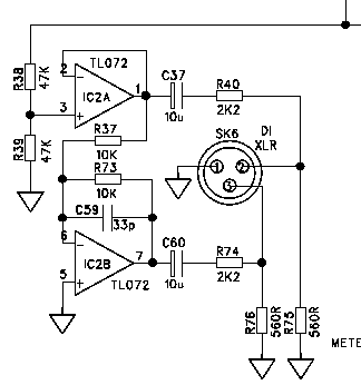

PRR, perhaps my eyes deceive me, but aren't those op-amp inputs incorrectly reversed? As drawn, the feedback networks loop back to the non-inverting inputs rather than the inverting. Also, the Hot and Cold lines to the XLRs would swing in-phase, rather than the correct anti-phase. Must be a drafting error.
Sorry, can´t draw so for now cut and paste only.
Later will show a single supply version if needed, please confirm internal voltages available.
This is the real thing, just needs slicht supply/biasing conversion .
IC2a straight drives XLR pin 2, IC2b inverts that and drives XLR pin 3
Circuit includes unnecessary (for you) attenuation but is what appeared first, next will be better 🙂
And much simpler.

Pretty sure Ken Newton is correct -- every dual 8-pin op amp I've seen has the outputs on 1 and 7, '-' inputs next to 'em on 2 and 6, '+'s on pins 3 and 5. Of course, both my brain and eyesight are well past their prime ...
Schematic is indeed in error. As drawn the opamp acts as a comparator generating square wave full-swing output.

That schematic has the op amp feedback going to the non inverting inputs...While the Jensen AN003 plan works, it does not increase signal swing, and that DJ mixer appears to run on rather low supply voltage.
