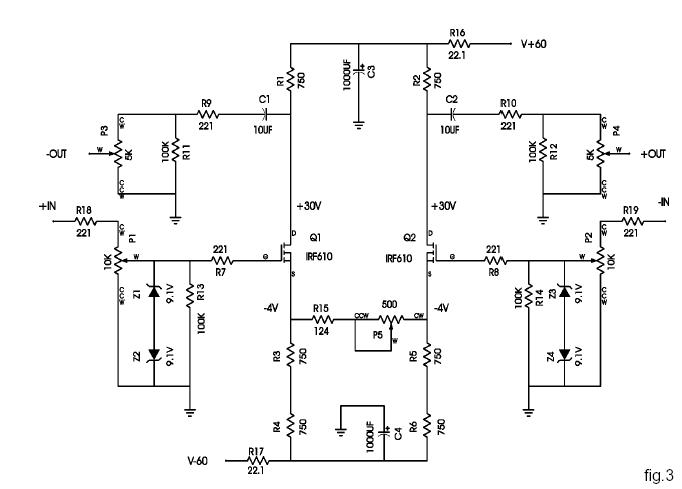

BZLS Cap
I am making my Balanced Zen Line Stage PCB now. In the article, Nelson suggest using 100+ Volt rating capacitors. I have both 1500uf/160V cap and 3300uf/63V on hand. If I use the latter one, will it works OK? or should stick on the higher volt rating one? (I like to pick the latter for better smooth out the ripple effect!)
Any suggestion?
Thomas

63 volts caps vs. 160volts
Unlike film (plastic) capacitors, anelectrolytic caps increase its lossfactor with its voltage capacity. Means qualitywise you better use the 63V caps, but note that the voltage in the Balanced Line Stage PS is about 80V after the rectifier!
You may use them after regulation, where the voltage is about "only" 60V per rail.
- dan

Lossfactor in caps
No, Electrolytics increase their Lossfactor with the voltage increase. Film caps decrease[/] their lossfactor with the voltage increase.

Lossfactor in caps -2-
We have to relativilize this though: a cap from a same manufacturer in a given capacitance and a voltage of f.e. 63V has a better lossfactor than the same capacitance (and construction) than a 100V or 160V. In a case of two different types (brand, construction, size...) you have to check from the manufacturer's datasheet which one is better.
Note: a cap with lower loss factor (and ESR) will heat up less at its limit of voltage than a worse lossfactor, means can be driven harder to its limit.

how to test bzls main board
I have completed my Balanced Zen LS boards. So far, the PSU output is good at +60V and -59.7V according to the design. However, I blew the Main board once due to wrong wire! I think I have replaced the bad one; however, when I check each parts, I don't know what's best way to check the circuit w/o connecting the power.
For example, the Z1 and Z2 in the schematic. I use the multimeter diode test and they are both alive. However, I use switch to Ohm check and both channel's reading is different. One channel is 3 times the resistance than the other channel. Is my testing method correct? If not, how do I test the baord in the right way?
This is my first project and I am ME and Computer Science major. I am picking up my EE knowledge lost in college!
Thanks for all comments!
