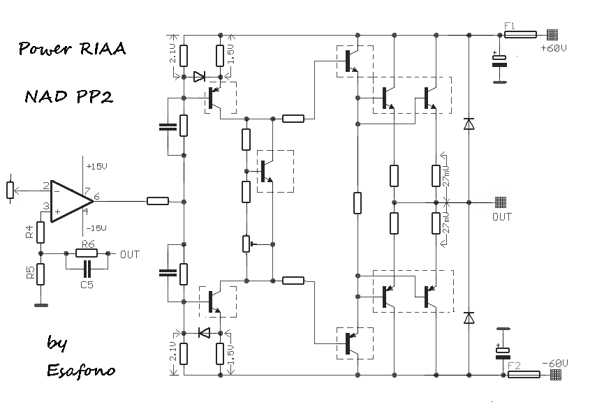

Stee said:
Just A Picture
NAD PP2 VER.5 IS MADE WITH
A970 C2240 -->A PAIR FOR EACH CHANNEL (there is MM/MC in)
PLUS ONE OPA NE5532P
SEE PICTURE ON MY SITE
http://www.esafono.it/NAD_PP2_VER5B.jpg
if someone is able to make schematic from PCB picture ...
i can do that
for this project you need double preamp (four channel HOT/COLD)
i can do that
