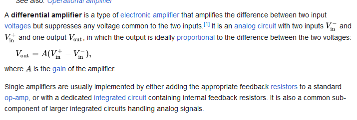

Isn't what is called a "balanced input/output" in audio just a differential input/output? Two wires carrying the same signal with opposite polarity and a shield?
From my modest experience with 3 differents balanced amps (with true balanced source), they tend to "sound" clean, little coloration.
Is it directly related to a different harmonic distorsion spectrum or isn't it that simple? I don't know.
Balanced, either between different boxes or within the same device has also the advantage of not using ground as a signal carrying conductor. Which not only eliminates the obvious hum producing ground loops, but also improves sound in more subtle ways.
Of course, as with everything else audio related the devil is in the details. Turning SE circuitry into balanced and back for the sake of adding a label is imo counterproductive and moronic. It is probably justified in profi audio but a bad idea with 60cm long interconnects. A number of reviews of dubiously designed equipment mention inferior sound quality through the balanced inputs/outputs.
jcalvarez So enlighten us or at least me. What is a balanced input/output in audio? I guess I really need to know this since I have been working with nothing but balanced I/O here in my recording studio since the early 80's!!! How do you think you get Common Mode rejection other that through the defination I just posted?

Errr, I'm not contesting anything you said. I'm asking why it is really called "balanced" instead of just "differential". If somebody uses the term "differential input", then I don't have to think, I know what is that. If called "balanced", my mind translate that to "differential".calvarez So enlighten us or at least me. What is a balanced input/output in audio? I guess I really need to know this since I have been working with nothing but balanced I/O here in my recording studio since the early 80's!!! How do you think you get Common Mode rejection other that through the defination I just posted?
I don't know about inferior sound quality since it is the main stay of all recording studios and broadcast stations. Also if you look at the attachment, you will notice the the ground is connected on both sides. It is technically a part of the signal path because it is the return termination on both end. If you don't believe me try lifting the ground on either side of an XLR cable and see what happens.Balanced, either between different boxes or within the same device has also the advantage of not using ground as a signal carrying conductor. Which not only eliminates the obvious hum producing ground loops, but also improves sound in more subtle ways.
I believe what analog_sa is saying (and I have seen the same thing) is some "Hifi" gear using XLR/balanced connections are doing a poor job of converting the output of the device from single ended to XLR to have than connection to market to the XLR connection only crowd. The one pre-amp I was talking about tested great on the RCA out, it was a disaster testing it on the XLR out jack. It's not saying the the connection technology is inferior, it's the implementation of it.
Ok, thanks for the clarification. That I can understand. I have seen a lot of really poor Engineering in this field. The truth is I have seen it in the Pro Audio field as well and that troubles me. It is almost like some Design Engineers have the attitude on some construction workers. They don't worry about the proper completion of the job because to quote... " You can't see it from my house"...

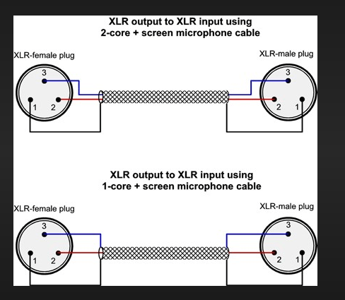

It’s interesting to me that there would be XLR equipment that is not expecting a differential signal. Wouldn’t sending a differential signal to equipment not set up for it cause problems? In all my years I have never heard of XLR based audio equipment being incompatible with each other. The comments here make it sound like you’re more likely to get bad sound or have problems if you mix random XLR equipped gear.
To go back to my amplifier, it accepts a differential signal over XLR (what we mere audiophiles refer to as a balanced connection). Each phase of that differential signal is fed into its own driver and then on to the output tube where the push pull signal is combined at the output transformer. Did I get that right?

wg_ski, Your post # 5 is my point exactly, XLR output eliminates the need for any kind of phase splitter within the tube amplifier; instead it puts the phase splitter in the signal source.
For those who misunderstood me, I never said there was no need for a phase splitter, but I alluded to the fact that the location does not have to be in the tube amp.
