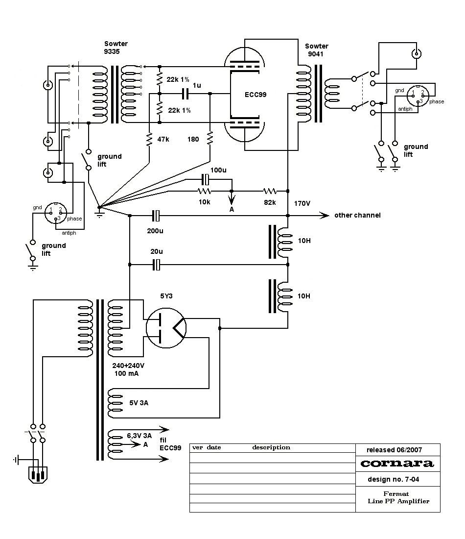

Te most popular solution for bal/unbal (and vice versa) is the transformer.
The truly balanced (symmetrical) implementation is rare, mainly due to the cost.
"Semibalancing" (unbalanced/balanced input, and symmetric tubes and output) is more common.

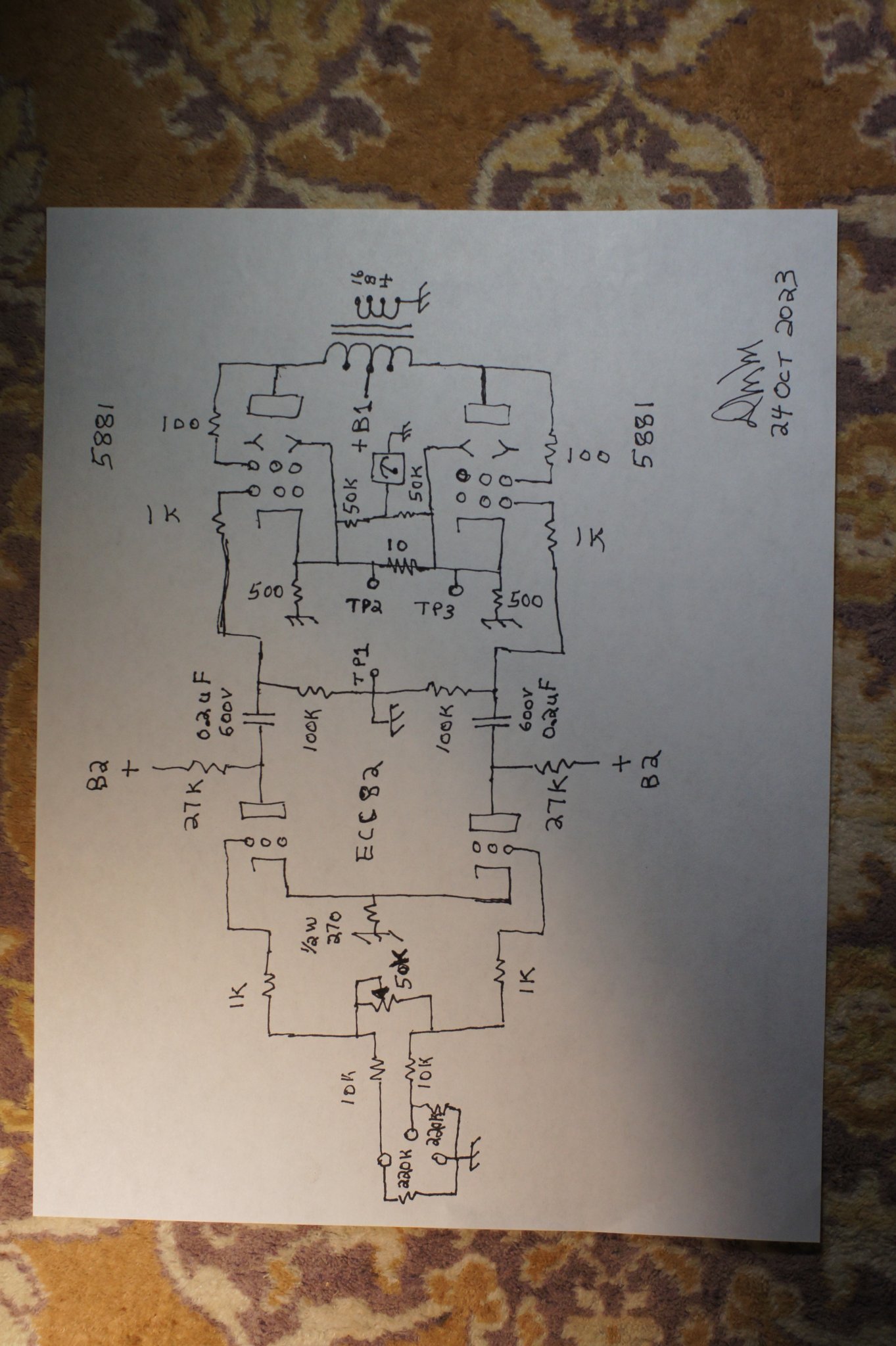

stephe, euro21, and wg_ski,
I am sorry for the sideways .PDF attachment, just print it out and turn the paper 90 degrees.
I decided to eliminate the input transformer in my balanced amplifier.
7 resistors at the input, but the shunt attenuator is only 3 resistors, the rest is 2 Rg to ground, and 2 grid stoppers.
A quality output transformer could be connected with the 4 Ohm tap grounded, and the 16 Ohm tap to the 'common' tap would give a balanced output.
Op amps, what op amps?
What is the difference? (pun intended)

I designed and built a balanced amplifier, 2 triodes driven from the XLR signal, those triodes drove the push and pull output tube grids. No phase inversion in the balanced amplifier.
Because I had good results in controlling input stage ground loops from un-balanced CD player to un-balanced amplifiers, I decided that I would not have to use a balanced input transformer. $ave money, and the frequency response was smooth and flat.
And there is no ringing from a resistive input circuit and volume control (no input transformer).
Hopefully that explains how I finally ended up with balanced amplifiers.
