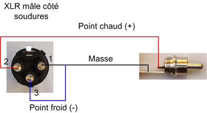

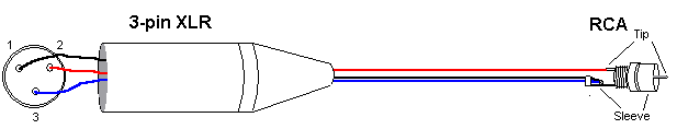

I ordered parts. Whats the best way to wire them for noise elimination?

without identifying the noise source you are trying to eliminate recommendations for how to best wire your "adapter" cable without more information about the devices to be interconnected could lead to creating new "noises".

Option a.)
if your XLR output allows the pin 3 signal to be shorted direct to ground then:
Take the screen/shield from pin1 all the way to theRCA/Phono Signal return tag.
Take the pin2 to the RCA signal Hot pin.
Take the pin3 to the RCA signal Return tag.
Option b.)
if your XLR output does not allow the pin 3 signal to be shorted direct to ground then:
Take the pin3 to a current limiting resistor to then feed the RCA signal Return tag.
