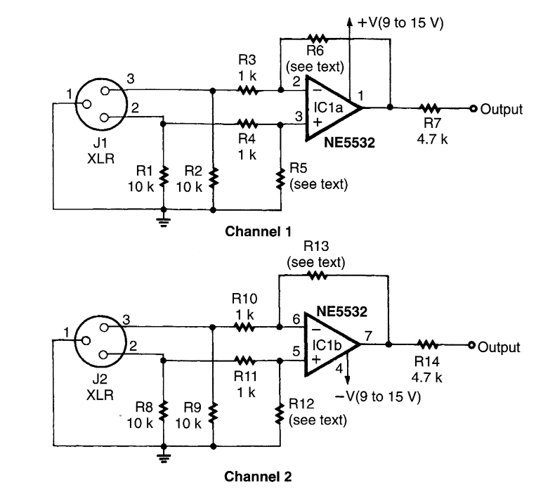

Then what you actually need is to build this signal chain:how one would convert a guitar pedal from an unbalanced signal to a balanced signal?
1) Microphone which is weak "microphone level" (say ~10mV) balanced to stronger "instrument level" (say, ~100mV) unbalanced.
That is done at every PA mixer channel which provides Balanced Mic + Unbalanced Line inputs.
Mic goes into a typically 10/20X (20/26dB) gain, balanced input extra stage, which then continues into the main Preamp channel or, in your case, a "Guitar" pedal.
Practical example,you build just the upper preamp, make R5 and R6 10k each:
2) the actual Effects Pedal, your choice.
3) its output will be now "guitar level" and unbalanced.

b) IF longer distances are involved or your mixer has *only* Balanced XLR input, then you use a 2 Op Amp "Balanced Out" circuit, such as:
popularly called "Direct Box", used to send regular Music Instruments straight to faraway Balanced Inputs.
Note: you are now running ~100mV signals instead of original ~10mV ones.
Personally I´d use as-is; 99% of Balanced inputs handle that very well and you keep an improved S/N ratio advantage (the louder the Signal the lowe the induced noise ) BUT if you are plugging into a dated weak signal only "Vocal Amp" from the 70´s, you may attenuate signal again by 10X.
Mentioned just as a curio, doubt you´ll need that.
