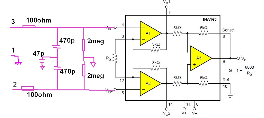

So what I tried to do here is show the two stages I built. On the left is my 'instrumentation amp' which I am hoping will operate as a balanced line receiver. So in balanced mode, my hot output goes to Vin+ and the cold output goes to Vin- . The two input IC's are the two halves of an INA2134 and with the resistors I used, I think the gain of this bit is =2. The differential amp is an INA137 with a gain of 1/2 so overall my 'receiver' has an overall gain of close to 1.
I have not tested this with a balanced input yet. BUT......
I did test this with the guitar (listening at Vout so without the 'buffer' cct that I have also drawn) and connected my TR cable tip to Vin+ and the Vin- to ground. So not a balanced cct obviously. And it sounds great!
The attenuation and 'muddiness' is gone and in fact I get a nice 'buffered' tone. Not surprising I guess, since I now have a nice high-Z input!
The circuit drives all my pedals so responds well and drives loads with varying input impedances of their own. So all good so far.
The buffer cct I have drawn was not used in these tests, to this point as I say, but sounded very good when I did add it after the 'receiver'
So I guess my question now becomes, do you think my 'receiver' circuit will cut it as a balanced line receiver when I do plug a balanced input into it or have I in someway compromised the whole thing? Assuming the answer is that it will function as a basic balanced receiver, does anyone have any suggested improvements?

Zero D thank you for your circuit btw. What you are drawing of course makes sense, but my goal is to have a single jack device with no manual switches.
So if I plug in a TRS lead from a balanced output, I get the benefits of a balanced receiver, and if I plug in a TR cable firect from the guitar, then ok it is not balanced, but I basically get a gain=1 signal out of the receiver. (and if fact a bit of a buffer based on the fact that I have a good Hi-Z input now.)

Is your IC1 and IC2 actually an INA2134, or an OPA2134? As you cannot use an INA2134 in that scheme due to its built in resistors. Also, the hot and cold inputs will need some resistance to ground to bias them.
If you graft on the buffer circuit to the balanced input it will unbalance the circuit.
If you do not want a switch, I think your only option is a traditional balanced input using the resistor values I posted earlier. But looking at your circuit you have more gain for the guitar input, this can't easily be accomodated.
Hi Richie, yes it's definitely an ina2134 I am using. I don't have anything connected to the sense or reference pins, so I figured that whilst I do have a small resistance on the negative and positive inputs it wouldn't be too big a deal. I did toy with using an opa2134 but don't have one handy.
The circuit is definitely working in some way shape or form. Without the buffer circuit attached, like I say I get close to a unity gain through the ina2134 and ina137 stages, which is what I thought I had calculated.
I am not grafting the buffer circuit onto the input of the balanced input, I have only used it on the output side of the balanced receiver, and really I only did this to see what happened. When I did this it all seemed to behave. I actually have a pot in the feedback of the op amp which acts as a gain control and then the pot on the output is like a volume control and as I say it seemed to sound ok. I think I may have confused the issue by making reference and drawing my buffer circuit, for now I probably won't use it and want to focus on the balanced/unbalanced hi-z input stage.
Back to the receiver itself I got a little confused when you said I need to bias the hot and cold inputs to ground. Could you explain why I would do this with different values? Also when you refer to a traditional balanced input, is what I have with the two ina chips significantly different to a traditional balanced input circuit?

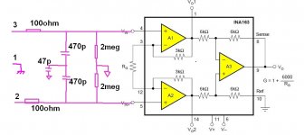

I think a INA163 instrumentation opamp is what you need, with an RF filter and some biasing resistors on the input. The gain can be adjusted from 1 to lots! The INA163 is available from Mouser and/or Digikey for about $9.
See attached (poor) drawing.

OK. You just won't be getting full potential with the inbuilt resistors being there.
All op-amps need a DC path to ground to meet their input bias current needs. When you plug a guitar in it's fine because the pickup is connected to ground, but once you connect something with a balanced output - which will have DC blocking caps - the circuit will go wild. It will also go wild without any input connected.
Figure 13 is what I would recommend you try as it offers a lot of the features you need.
Paul, I like the idea of the INA163, and thank you for the sketch (your drawing is far better than mine btw 🙂 ) Your proposal looks like a similar but neater and more compact version of the circuit I had stumbled towards but also with the additional information on filtering and biasing, this is an enormous help! Thank you again, can't wait to try it!.
Richie, that makes sense in terms of the bias, and I think Paul's proposal has this drawn in.

I ordered an ina217 Paul, it was a toss up between that and the ina103 so fingers crossed. I also ordered samples from That Corp of their equivalent.
well after getting together with my friend this weekend, the first test of Paul's circuit (but using an ina217) were very successful. The balanced line out from my buddies multi-effects unit sounded perfect into the receiver 🙂 and then when I unplugged the multi effects and went straight into the circuit with the guitar, again it sounds bang on the money 🙂

In Paul's example circuit of earlier, do you think I am correct in assuming he input impedance will be 2m ohms? (I suppose I could always measure it 🙂 )

It is likely that the 1M resistors are to signal ground.
If so, then they are in parallel to the actual Rin values.
The Rin values are more likely to be 2k to 100k depending on the designer's intentions.
