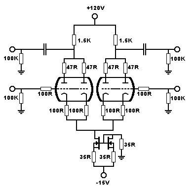

have anybody built it or tested it? i cant read out all of the component values but i made i cleaner picture of it
can the ecc88 take higher voltages? i got some 0A2 tubes that could be fun to use. i thinkt they can handle about 30mA so i nead one for each channel right?...
or does anybody know of any other BALANCED tube linestage?....
(preferably something that could live from a dyaco Pas transforer and 12x4 rectification 2 x 10h and quite a lot of capacitance...

Looked at your pix, i don think paralleling high-G_m tubes is a brilliant idea. It may work, but it probably doesn't sing.
Paralleling eats up the detail.
Have one tube per side and maybe you manage to find tubes with system 1 matched to system 1 and 2 to 2. Then you could use them for left and right channel. Or simply waste them. use them for a tape output buffer or use them paralleled as tube current source which can handle the current.
Otherwise methinks this is a pretty decent circuit.
