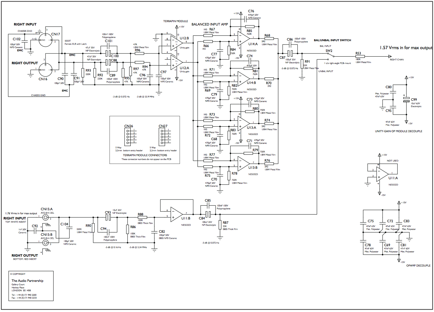

Thank you for your response. I understand and agree with you in general. My question was about this specific design, as I've read about some circuits that lower the noise by only 20 dB and others that can do much better.
I've also read about transformers being the best way to ´unbalance´ a signal, but this is a supposedly good amplifier (Cambridge 840W) and was wondering if the balanced input was also well designed, on the opinion of the knowledgeable people around here.

Would you say the balanced input of this amplifier has better noise rejection or any advantage over its RCA input? I understand the amp is not fully balanced, but my preamp is, so what do you think?
Thanks in advance.
No.
The shield is connected to signal earth and therefore all external interference/noise is directly injected into the audio path.
What you want is a separate path for the interference/noise as is described in the AES48 standard. Iaw shield to the chassis!

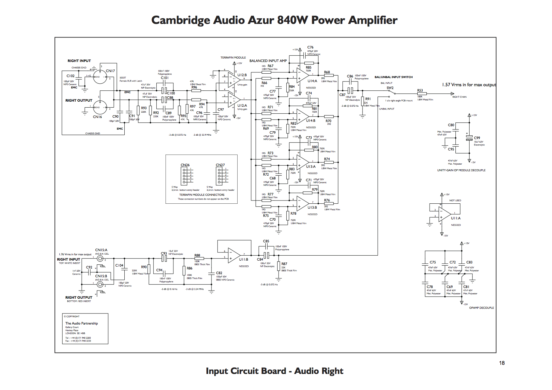

Rich:
Thank you for your response. Actually, what I posted is the schematic for a 840W amplifier, straight out the service manual. I posted it without the title to make the file smaller, but here it is complete:
I would first ask why pins 8 and 2 were left floating
rather than 52K returns from the output? Has some
mission critical information about this "terrapin" been
left out?
Kenpeter, thanks for your input, but at what pins are you referring?
Edit: Never mind, I found the pins you talked about. Thanks
You'll find a discussion of this circuit in Douglas Self's Small Signal Audio Design book - he designed it, the whole 840W in fact. Essentially the point was not only matching, but even exceeding unbalanced input noise specs since people usually (if mistakenly) expect balanced inputs to perform better. The mysterious "terrapin module" must have pretty good current drive capabilities.

I have to clarify some things.
If the shield of the interconnect cable is connected to the signal earth you inject all interference into the audio path. So in that situation there is no benefit in going balanced. Unfortunately this is the case in 99% of all situations. So the first step of improvement in noise rejection is connecting the shield directly to the chassis so there is a separate path for the interference to go. This interference will always be there because of the voltage differences between the connected devices.
Second step in reducing interference is making sure the impedances of the positive and negative audio cables are the same across the audio frequency band. Best way to do this is using trannies. But you can also bootstrapp the input so differences in impedance are not important any more, the That 1200 series is developed for this purpose.
For a device to be AES48 compatible (What means that the device is immune to outside interference), you do not need it to be fully balanced. Just the input and output need to be balanced. The PDF has some good drawings that shows how a device should be wired.

I agree with you that it is good practice to connect the shields of balanced audio cables according to the AES48 standard, but I think you are exaggerating a bit when you say that balanced connections are useless when you connect the ground to the internal signal ground. Sure, stray currents through the internal signal ground will cause interfering voltages that the circuit can't reject when it is internally single-ended, but at least you are still insensitive to the voltages across the shields of the cables.
Balanced connections are useful when you have large ground loops, like when you have three studios that are all connected to each other, or when you have a home audio set that is grounded to the mains safety ground and to the cable RTV ground. In this latter case you can usually just as well break the ground loop by blocking capacitors or a tiny transformer in the cable connection.

Dirk:
Sorry for the newbie question, but why do you say the shield is connected to signal earth? What I see in the diagram is pin number one of the balanced input connected to chassis ground.
Your correct, I misread the schematic and made the wrong assumption that 99% of all equipment is not AES48 compatible.Dirk:
Sorry for the newbie question, but why do you say the shield is connected to signal earth? What I see in the diagram is pin number one of the balanced input connected to chassis ground.![]()
But then you have to make sure all the rest of your equipment is also AES48 compatible or else a very loud noise will be heard.

The shield to chassis earth is key to reducing noise.
Then you must make sure CMRR is low to. This is not so eazy to do and puts great demands on interconnect dimensions and tolerances. Here you can find info on how to get the best CMRR: http://www.jensen-transformers.com/an/ingenaes.pdf
