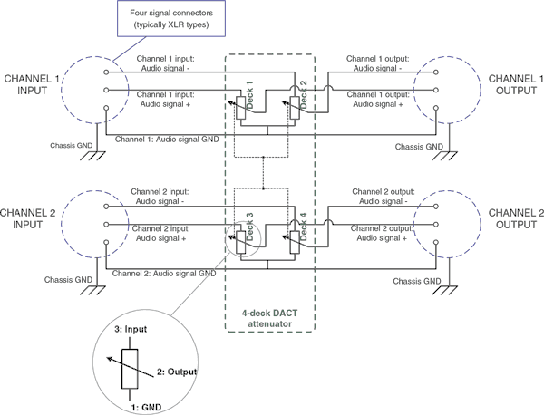

YES yes and yes.my 2 cents. A balanced input is supposed to work on the difference between the two input signals and should not be connected to ground. Whatever common mode interference exists on the ground connection is now part of your intended signals. See Bruno Putzey's article regarding the "G" word, which is his attempt at trying to denote that ground is not an absolute. You will need to implement a balanced attenuator that does not rely on a connection to ground.
The attenuator ( post #4 schemaic ) using XLR pin 1 is non sense.
XLR pin 1 is not an "audio signal ground".
Take a cutter and cut that connexion at the pots to "ground". Here is a balanced attenuator.
Let the pots float --> Noise gone.
In case the pots have a metal case, connect these cases to chassis XLR pin 1.

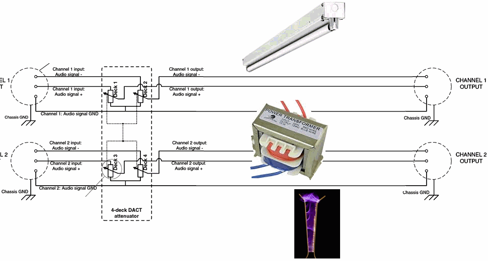

balanced attenuator using two DACTs
Here's an illustration of what I was suggesting in post #15. Two single ended DACT attenuators connected to form a balanced attenuator. It does assume that the DACTs are pretty closely matched and set to the same setting as you would have with a dual version. I assume a quad if you're dealing with stereo.

My noise problem is solved. It was a fairly trivial oversight in assembly. I follow AES 48-2005 (s2015) standard on grounding/EMC. My balanced stuff always has mains safety earth (equipment ground) , pin 1 to chassis, shielded internal cabling. This time something went wrong and I got noise from the DACT balanced attenuator. I checked again and found one end of the signal cable shield unconnected. Pin 1 from the input XLR is always grounded to chassis (and chassis to mains earth). Pin 2 ("+") is hot / non-inverting, Pin 3 ("-") cold / inverting. On the inside the cable ( I use mic cable) takes the signals with two internal wires and the shield must be connected to ground too. The Neutrik XLR socket has a special ground connector for the internal shield. I cut the isolation to exchange cables for the Canare star quad experiment and...the shield was not connected. On both channels. I connected them and voila! No noise. Perfect sound.
Connections are as per the DACT drawing I attached earlier. Some of you criticized the drawing ground lines. But it works. When I have some time I'll take one deck apart and check how it is built internally. Perhaps the ground does not connect with the signal line at all? Anyway, the proof is in the pudding. Now I am moving to my next project: BTL stereo amp with an autoformer volume control (balanced 4-gang). I already checked with oscilloscope on the bench that it gives nice phase/antiphase signals on the speaker outputs. Can I call this amp balanced differential, balanced or just differential?
Thanks everybody for your input, this always moves things forward. Special thanks to PRR who
inspired me to check the cabling which resulted in the disconnected shield discovery.
I'm glad you got it working. I still maintain that it would be more quiet if the attenuators were not connected to common. The DACT website shows them as a simple series connected set of resistors and the wafer switch connecting to the intermediate taps in the chain. In a perfect world the low side of the attenuators connected together would see no variation in signal if the two input signals are of equal amplitude and opposite phase. So connection to a quiet ground would be of no consequence. As soon as you connect to something other than quiet ground, such as the shield of the balanced input, you will affect the balanced signals coming in.

How to best wire up a balanced attenuator is an interesting subject. I think it was either Bruno Putzeys or Bill Whitlock who pointed out that connecting the midpoint to ground actually tends to yield best performance, as counterinituitive as it may seem. This configuration will attenuate both differential mode and common mode signals equally. By contrast, common mode will pass through the floating midpoint configuration essentially unimpeded - so the more attenuation you need, the more disadvantageous the common mode to differential mode ratio becomes.
This is in contrast to the feedback network of a following instrumentation amp type receiver, which is in fact best left floating, as that keeps common mode gain at unity no matter how large differential mode gain may be.

The 'correct' way of attenuating the input signal to a balanced amplifier is to use a single deck attenuator across the two inputs, and connect the wiper to the cold end. Actually a series attenuator (not stepped) is best for the application, with a series resistor on each input, sized to provide good attenuation steps.
You do need an additional buffer if you need to match gain and impedance of each stage correctly, but this attenuation method is actually the most optimal (IMHO).
