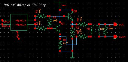

Could anyone help me get somewhere with this? Any thoughts or ideas? Here is a copy of the circuit MWP suggests, but using transistors...:
Jocko Homo said:
Why do you think that you need to amplify it? The output is supposed to be 0.5 V p-p, not 50 V p-p.
Jocko

HarryHaller said:
I have used the 74HC86 as a phase inverter for driving balanced digital out for AES/EBU interfaces. It works real well. Jocko said this circuit was too good to give away for free!
Uh..........the output is CMOS level..............5 V p-p. You need to reduce it, not amplify it.
As for reclocking F-F..........put it in front of the '86, and only use one ouput. Yeah, too good to give away for free, but what the hey............
Don't use the Lundahl. They make good audio transformers, but SPDIF onrs are totally different. I would not use them. Or any designed for AES-SPDIF conversion. Or 2:1 ones, either.
Jocko
Aah... I see... Then why would WMS use transistors in his example schem? Reducing voltage can be done purely resistive...?! He uses them to battle impedance transients of the '86 rise fall? could I use a no-gain OPA627 buffer for this purpose? (627s are probably overkill but I have spare chips laying around)

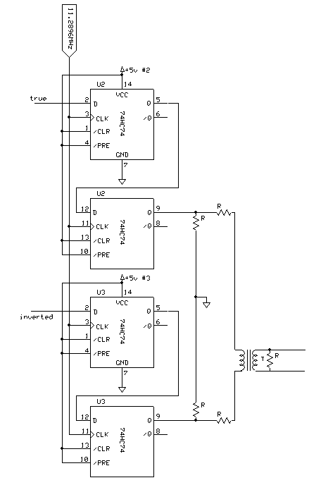

Yes, reclock on the TX side. On the RX side, you need to come up with a seconadary PLL, and use that to get the recovered clock.
Whow, I'm getting an overdose of digital language 😉 Let's assume for a second that my setup will be the reclocked 74 flipflop, into the 86 as digital phase splitter, resistive network, opamp buffer, then the tranny...
Would I feed the 74 on the TX side 2.8MHz, and then 44.1KHz for CS8412 FS output on the RX side? If so, could this be done as simple as using one clock, say 11.289MHz, and use a binary counter or other suitable logic to divide by 4 and 256?

Get rid of the buffer..........
You will use 11.2896 MHz as the clock for the F-F. No dividers/counters needed. Worry about getting the TX side working first. Your guesses on the RX side still need work, so forget about them for now.
OK. My stuff is battery powered, so I shouldn't have any jitter problems using a low-jitter XO-1 (to keep things simple)?
Now what..? Will i use a '86 for phase splitting, or should I get rid of it and make the '74 flop take care of this..?

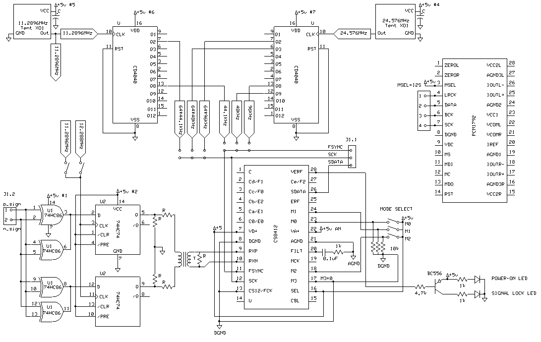

Regarding the SPDIF antijitter measures, I've been reading som datasheets and tried to understand the glue logics involved here, and what I've come up with is drawn in the attached schematic. The SPDIF input uses a 86 xor gate wich splits the digital signal into inverted and non-inverted logic signal. These signals are then reclocked in a 74 flipflop, before being tuned down to 0.5Vp-p SPDIF standard for the pulse transformer driven in a balanced setup.. Will it work? any comments? I guess the suggested 11.2896MHz frequency was based on regular 44.1KHz sampling frequency (256Fs)..
Should the flipflop be clocked to 256Fs if switching to 48KHz or 92KHz sampling frequency?
Regarding reclocking of the CS8412, I've set up options for FSYNC clocking at 44.1KHz, 48KHz, and 92KHz. I got the impression that SCK should be clocked at 64Fs, so that is what i've drawn in the scematic.. Sampling frequencies will be jumper programmable I guess...
CS8412 provides three outputs, the DATA, FSYNC, and SCK... PCM1792 recieves I2S on LRCK (pin 4), BCK (pin 6), and DATA (pin 5)....
wich goes where? and should clock the PCM1792 SCK?

I would like to be able to switch between 16 and 24 bit operation of the PCM1792, just as I'll be able to select sampling frequencies.. that means as far as I've understood switching the FMT[2:0] bits in control register 18 of the PCM1792, between 100 (16bit I2S) and 101 (24bit I2S)... Ehm.. do I need an MCU here? or can I get away with glue logic?
rfbrw said:
As I understand it, this is the input to a DAC. That being so, what signal do you intend to clock the FF with?
it will be clocked by the 11.2896MHz clock as far as I've understood.. But as you can read in this post I am not quite sure..

Sure that you wanted comments.........?
What good does it do to reclock the incoming data, when it will go out with almost 1 n Sec of jitter, from the PLL????????
Why stick all those XOR gates in there to get differential, then put a transformer after it?
At least you have something between the '8412 and the line. Just the wrong stuff, in the wrong order.
Jocko
I realize the '86 was messed up in the 1st schem... I've got to xor signal with +5V to invert, and xor signal with ground for non-inverting...? I'm thinking 1100 xor 1111 = 0011, 1100 xor 0000 = 1100....... right? but Jocko.. can you give me a clear hint on how to do this? will I reclock first, then split, then step down voltage (resistor network), then transformer?
I realize I ask alot of really stupid questions, but this digital stuff is all new to me... I'm really trying to learn.. 🙁
NO!
Put the reclocker on the TX side, where you already have (or should have), a good, clean clock.
On the RX side, you add a secondary PLL. Some guy who sometimes posts here sells one. (I know from personal experience that it works. Drawback: cost.)
Those chips may not like driving a resistive load................
The simple RX circuits that you can find on the web work ok. The TX ones do not.
Jocko
