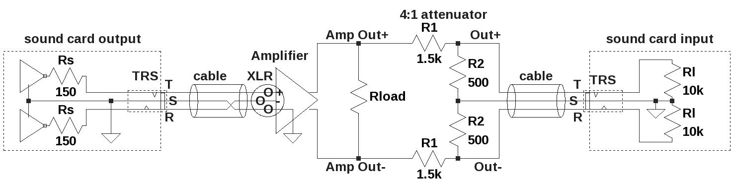

This thread describes a simple interface to an M-Audio Audiophile-192 (AP-192) balanced soundcard for measuring the distortion of balanced and unbalanced amplifiers. Equivalent results should be obtainable using other high-quality soundcards. Although the results shown are for the Pass F5 unbalanced amplifier, the same circuits are applicable to balanced amplifiers.

In order to protect the AP-192 soundcard input from overload due to the full output voltage of the amplifier, a 4:1 resistive attenuator is placed between the amplifier output and the soundcard input.
Requirements for testing the F5:
. Unbalanced inputs and outputs
. Maximum output signal of 20V peak for 25W into 8 ohms.
. Amplifier Gain: 6x
(Note: 6 x 2.8V = 16.8V attainable from AP-192 output)
Note that the F5 channel being tested was built using Cviller V1.1 boards and matched Toshiba 2SK1530 and 2SJ201 MOSFETs. This F5 channel also contains the P3 potentiometer described in http://www.diyaudio.com/forums/pass-labs/121228-f5-power-amplifier-1086.html#post2667669, which was adjusted for minimum 2nd harmonic distortion.

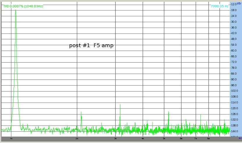

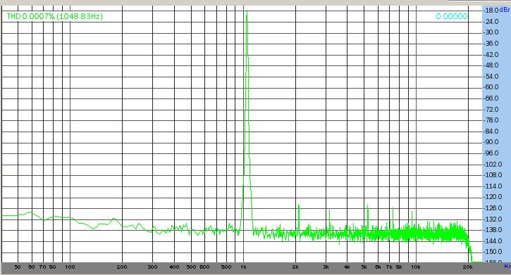

Shown below are schematics for both a balanced and unbalanced amplifier, and a spectrum measurement of the F5 output at 1.05KHz 1 watt output into 8 ohms.
Final warning: Since there is no protection against overloading your soundcard input, be careful to provide an appropriate attenuation ratio the resistor dividers.

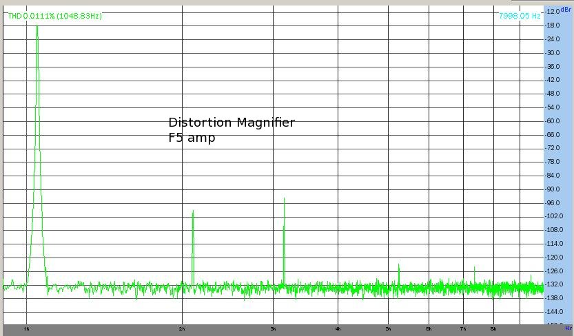

Some of you who know better are suspicious (or should be) of the .0007% THD measurement shown in the spectrum plot in post #1. I have made distortion measurements of the same F5 board using the Cordell Distortion Magnifier (DM) and measure a THD of around .0011%. Both sets of measurements are repeatable. I do not believe that these results are due to random measurement error.

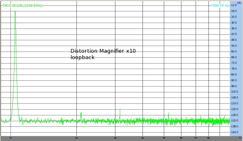

Shown below are 4 measured spectra for the F5 board. They provide the soundcard loopback measurement and
combined amplifier measurements using the soundcard interface in post #1, and using the Cordell Distortion Magnifier (DM).
MEASUREMENTS USING THE CORDELL DISTORTION MAGNIFIER:
The DM measurements were made using x10 magnification, where the harmonic components (other than the fundamental) are multiplied by x10 (+20db).
Thus loopback THD of .0010 becomes .0001.
THD_loop = .0001
THD_total = .0011
.0010% <= THD_amp <= .0012
Soundcard caused distortions are attenuated by a factor of 10 using the DM in x10 mode, thus THD_total is
mostly influenced bt the distortions of the amplifier.

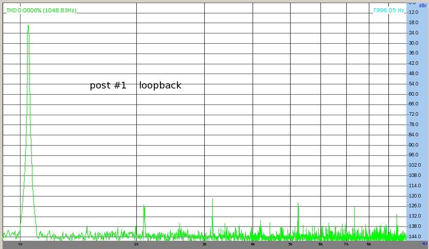

MEASUREMENTS USING THE RESISTOR DIVIDER INTERFACE OF POST #1:
THD_loop = .0006
THD_total = .0007
.0001% <= THD_amp <= .0013
Thus using the interface of post #1, it appears that the soundcard distortions are out-of-phase with the F5 amplifier distortions, thus causing significant harmonic cancellation.

Because of the way that the Cordell Distortion Magnifier does its nulling of the fundamental test frequency, distortion components from the DAC are also subtracted. This means that the loopback measurements thru the DM are measuring mainly the distortions due to the ADC. This suggests that the difference between the loopback measured without and with the DM might be a reasonable estimate of the DAC THD.
Using the data given above, that gives THD_DAC in the range .0005 to .0007.

By doing loopback tests of the M-Audio AP-192 I found that noise and distortion was much reduced using balanced outputs and inputs rather than unbalanced. My impression is that until amplifier being tested (DUT) has noise and distortion levels approaching those of the soundcard, the soundcard can be largely ignored.
Since the soundcard interface presented here is only intended for measurements of the low impedance amplifier output (usually 8 ohms or less), and is of a totally resistive nature, there should be no calibration issue other than overall signal level. It you accurately know the resistor divider and the soundcard levels you should be good, otherwise you need to calibrate by some means. For THD measurement, the absolute signal level accuracy is less important than the ratios of harmonic levels to fundamental.
