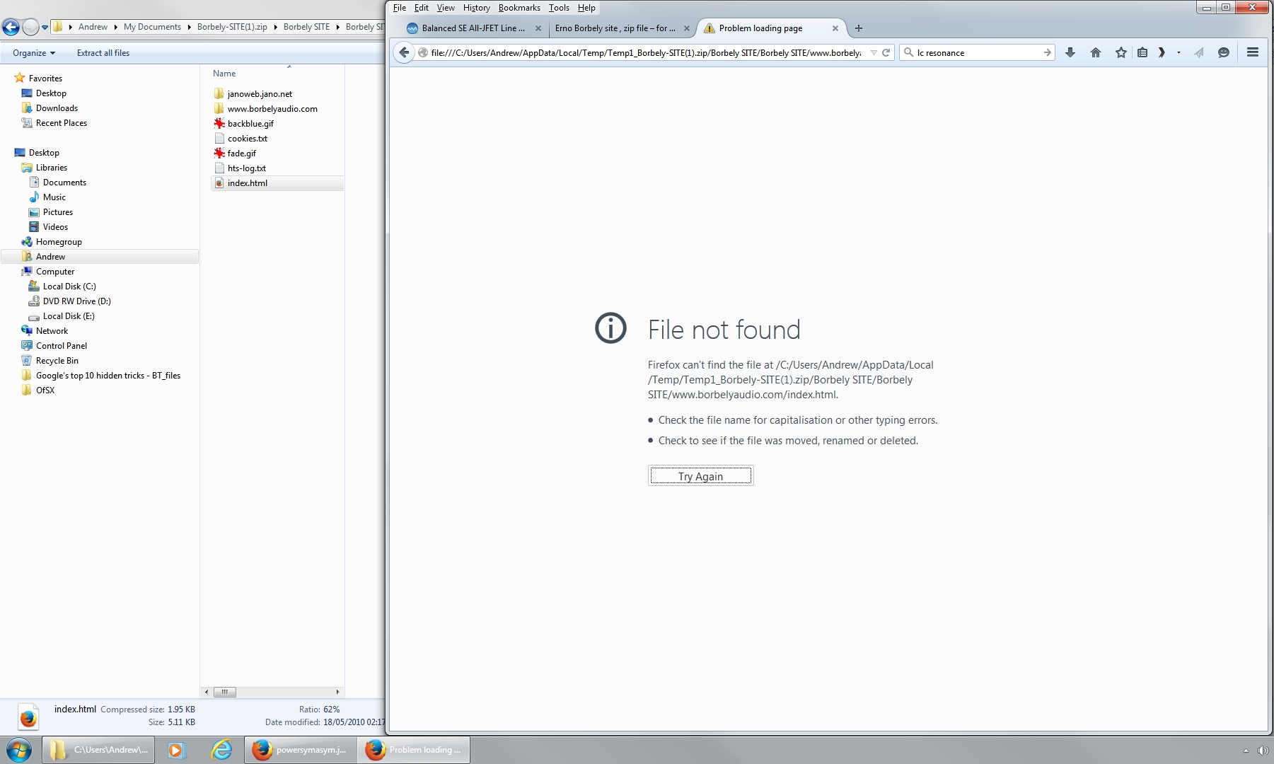

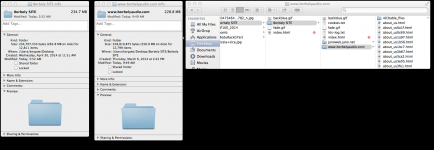

I tried that a few days ago. Today I get the same message.
File not found.
