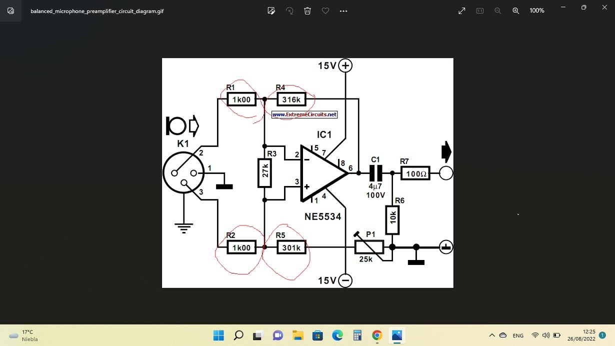

But since the Marantz PM6006 amp doesn't have balanced inputs, I have to make a pre from balanced to unbalanced with gain 1.
can be done with this diagram, putting correct values in R1, R2, R3, and R4 for gain 1.
O usaar el SSM2019 con ganancia unitaria.

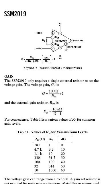

Yes, exactly. I would use the SSM2019 for this purpose, since that's what it is designed for.
It has internal laser trimmed gain set resistors that track well.
And if you do need more gain, which I doubt, you can change the gain set resistor.
For 0dB gain, you just omit that resistor.
Build carefully on a pcb, with suitable bypass capacitors. This is a low noise, wideband device.

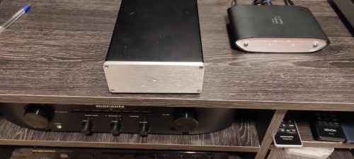

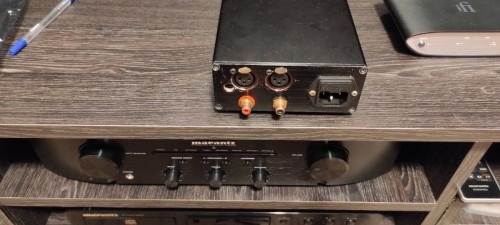

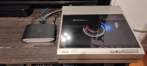

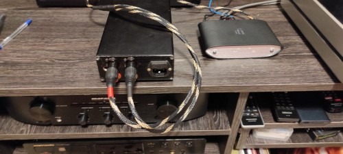

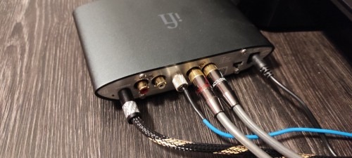

Hello again. In the end I have built a preamplifier with balanced input and RCA unbalanced output.
I have used an assembled board sold on Aliexpress and bought a 4.4mm to 2 XLR cable, with Audio Canare cable.
Result, as Rayma said, a considerable increase in the output level and I don't know if it's subjective, but it seems to me that the registers sound better.
