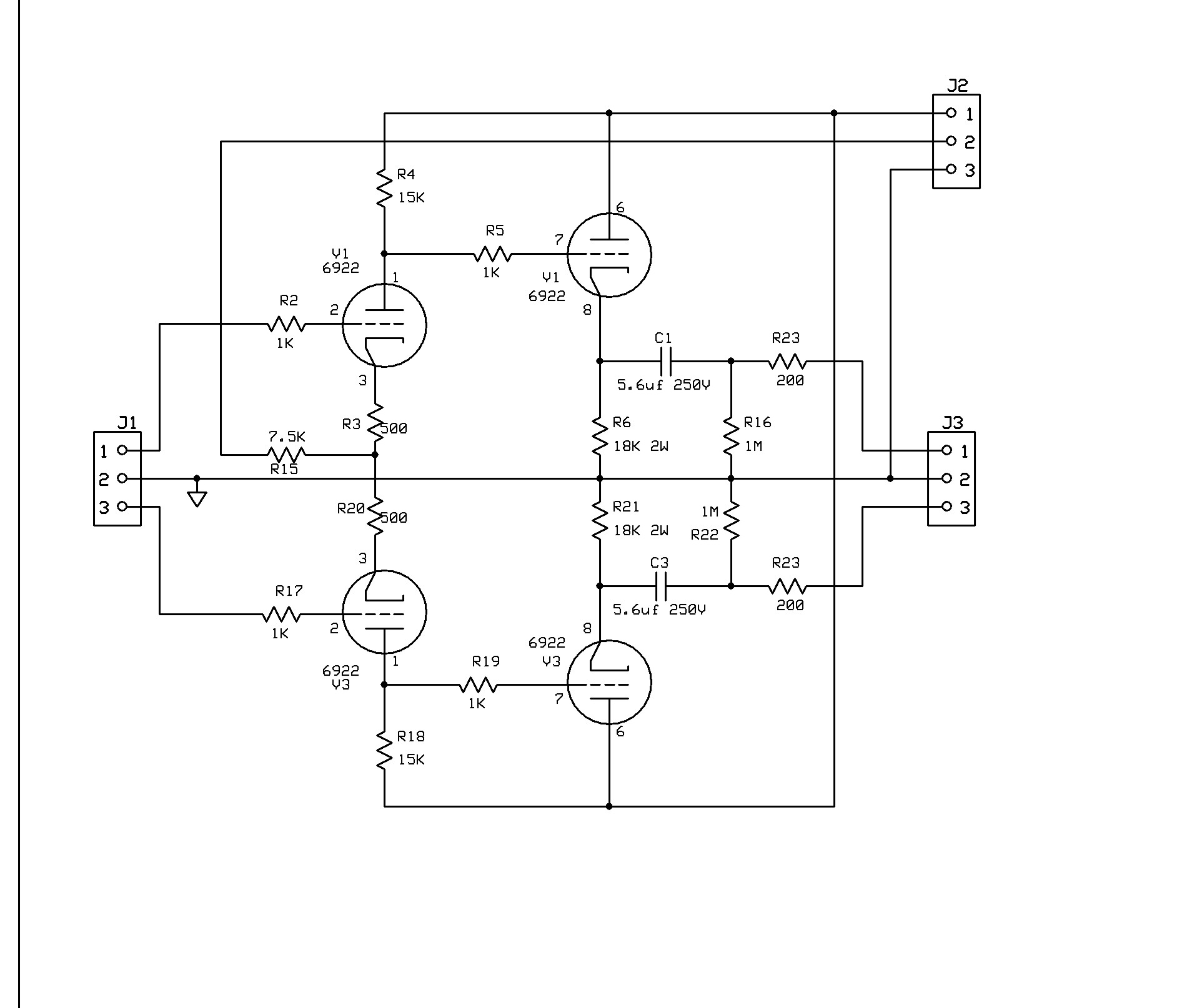

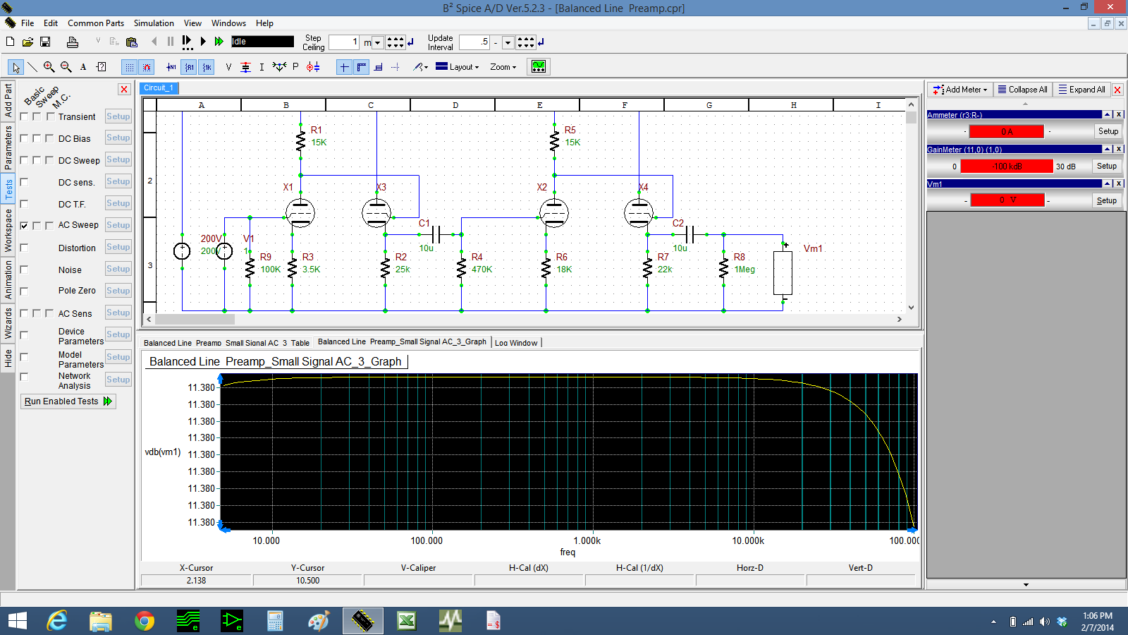

Wanted to try my hand at a balanced preamp using 4 6SN7's, the first two being the gain stage, the second two simply a buffer stage. Below is a pick let me know what you think. It was simulated single ended, just to do a basic AC sweep, I tried to spice the balanced topology, but I kept getting some quirky readings. The gain single ended seems to show around 11.5db.Thanks

With that scheme, you basically throw away the main advantage of balanced-mode operation: common-mode rejection.
It would be better for me to post a complete schematic, I'll try to have that up in the next day or so, I'm not sure if the benefits of a balanced design outweigh the cost of additional tubes. I may be just blowin in wind on this one.
