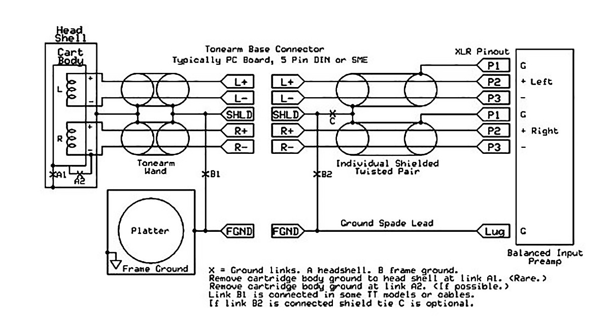

Can't remember the source for this file, but I think it covers it. (Possibly https://www.proaudiodesignforum.com/forum/php/viewtopic.php?f=7&t=753&start=34). Well worth exploring both for some MMs and MC 🙂.
Yeah I guess you will get balanced if you terminate the coil with equal resistors to GND. As for where (or if) to connect the cartridge GND/shield is probably up for experimentation.

BTW every MM cart I have be it AT, Shure or Stanton can have the shell grounding clip that's attached to one of the "-" terminals removed. It's press-fit between the plastic terminal frame and the metal case. A fine point scribe or sewing needle can be used to lift it off the terminal. Its designed to be removed and they can also be reinstalled. This has to be done or one channel will not work properly.
Balanced operation requires shielded twisted pair. I've never had much luck using single conductor coaxial-shielded leads though I've been made aware that some RCA-terminated leads are actually STP and terminated in an RCA which will likely be wired balanced all the way from the cart up to the RCA. Most people, myself included, have been reluctant to cut them and simply wire a new harness to the arm base.
Modifying as an example an SL-1200 for balanced is super-simple. I did my ADC arm and posted it on LatheTrolls. https://www.lathetrolls.com/viewtopic.php?f=9&t=5876

Hi, thanks for making the illustration - (I kept a local copy for reference, forgot the source). I'm familiar with your phono transfer system, "the Wayne", as it's called by my friends 😀. Really attractive, have to say.
