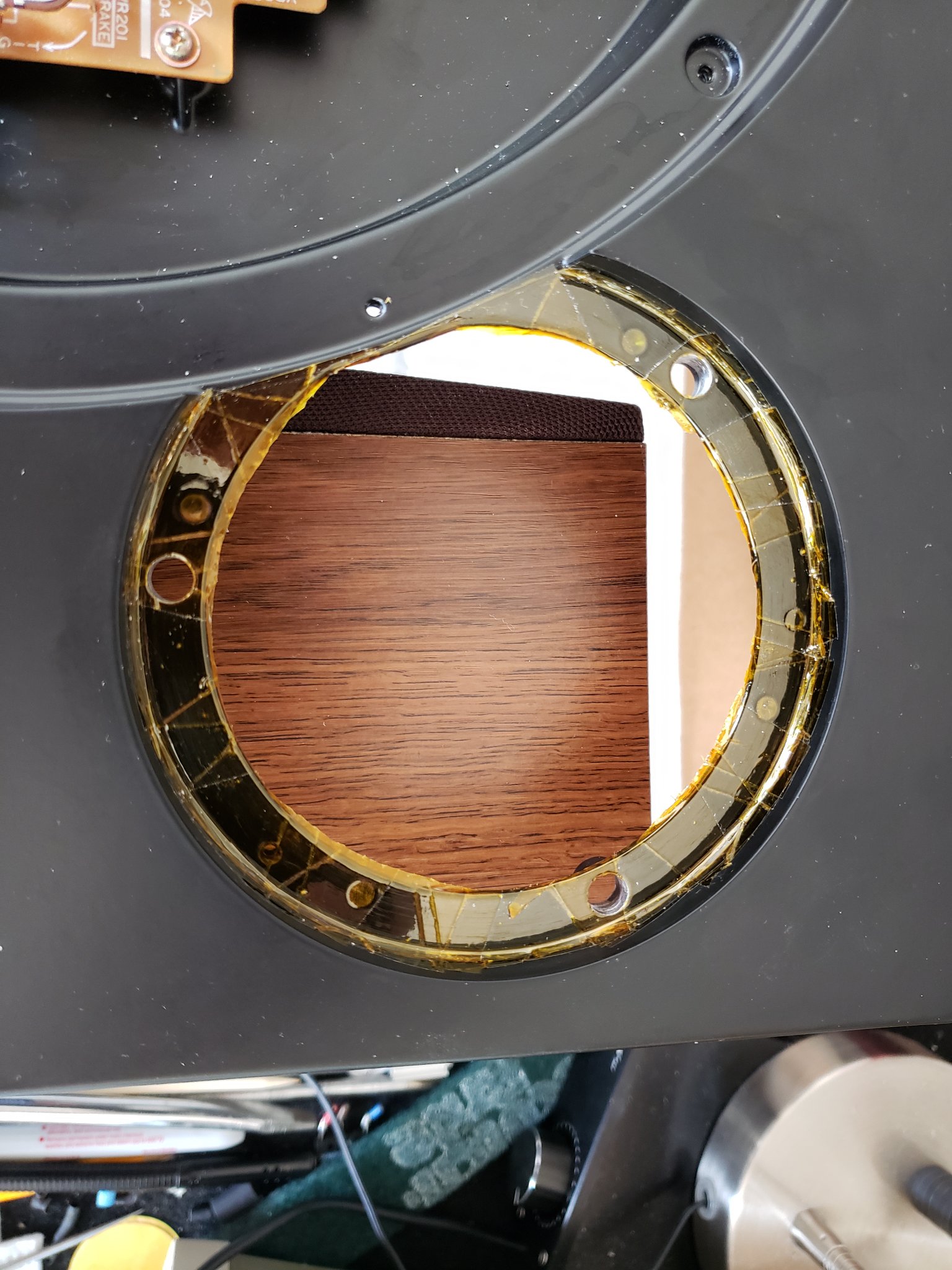

I'm not going to use Teflon for insulation, as it has problems with static fields wandering along the surface where it acts as dielectric. Creep is a whole different issue. Nylon doesn't do any of this stuff and is far easier to work with. Im using 2 layers of 1 mil Kapton polyimide to isolate the arm base flange to chassis flange. Its very tough stuff and versatile.

Here are the fruits of my labor. Its not easy to get an evenly thick application if you don't have a large flat surface. I applied 3 layers of 1/2 mil kapton tape and drilled out the locating holes to .280". This is to receive the insulated threaded standoffs from the arm base.
Crossed fingers it works. Don't see why it shouldn't. It really doesn't need to be a good insulator - anything over 1k would lprobably be quite adequate. It would be interesting to do some calculations to refine that wild "out of the air" figure.
The arm is back in and well isolated. I measured in excess of 30 meg ohms with my HP meter's highest setting.

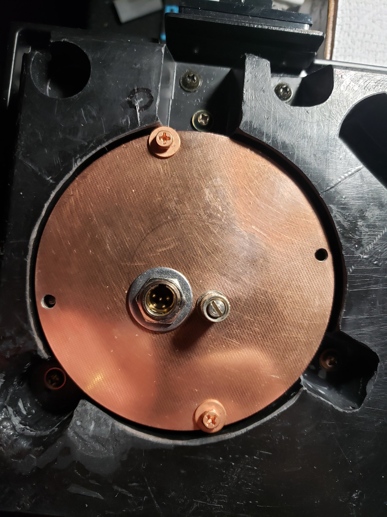

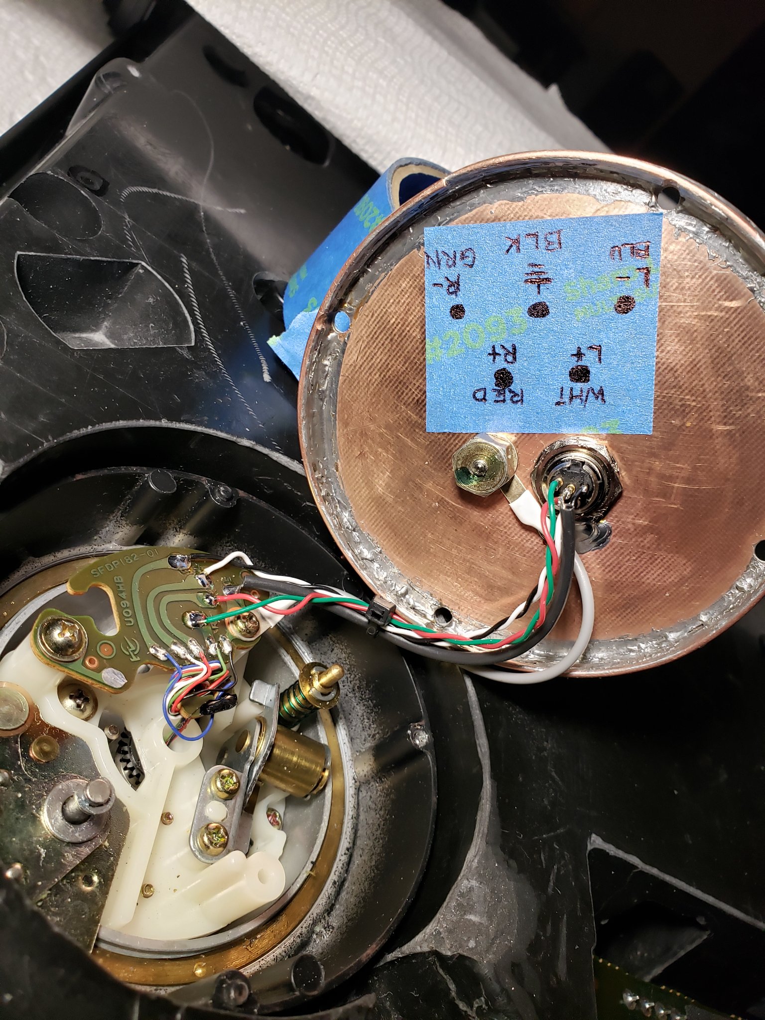

I ended up building a copper end cap to install a single 5 pin mini XLR connector and extra earth terminal. I chose a single connector because of the grounding scheme, so it didn't loop a second ground run back on a second XLR shield. The earth originates from the phono pre PS and runs down the cable length, TT and splits to returns to the input XLRs local earth. I used mogami shielded wire, as it only has 8 pF capacitance per ft.
