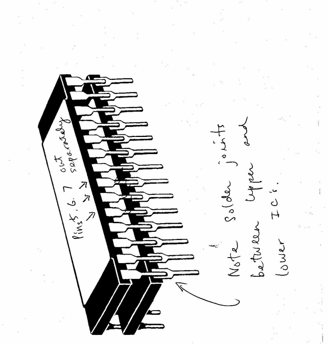

PiggyBack
Did you try "the Monarchy Audio" way?
(they used only output from the "piggyback" chip)
Attached: PCM63-K)
Arne K
"paralleled" DACs, as stated by Mike, can enhance s/n) by
3dB for every doubling of the number of converters.
(this concept is very appealing to Burr-Brown/TI and Analog Devices...)
However, unlike what some have said (including an
audio converter guy, Bob whats-his-name at ADI),
distortion is NOT reduced, in general. To reduce distortions
would require that the nonlinearity errors in the various
bits be random. In practice, any bunch of converters
you buy for this sort of project will likely be from the same
lot and thus be very likely to all have their errors skewed
in the same direction. Thus they'll be highly correlated.
On the other hand, buying the premium grade of any DAC
is a very good guarantee of getting better linearity and
hence lower distortion.
