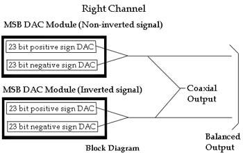

What is supposed benefit of either method? Reduce LSB error
by averaging the output of two DACs??

Well, I guess the question comes down to which configuration is most important for percieved reproduction quality...
I am not an expert but as you indicate I've read that the logic for parallel dacs is the they will average linearity errors but on the other hand is that not what a balancen configuration will do as well?
Besides linerity errors I can see a balance configuration being able to supress noice induced in powersupplies and cables.

I can't quite see how parallelling DACs could do more than
reduce errors due to individual variations between the DACs.
Howver, perhaps we'd better clear up what we mean with
parallelling DACs, so we avoid confusing each other. I have
taken the term to mean that two DACs are fed identical data
and the outputs are summed/averaged, but perhaps that is
not what others mean? Similarly, balanced DACs would in
my understanding be two DACs where one is fed the
complement of the data to the other one, so we get a
balanced signal between the two DAC outputs.

Correct, the paralel DACs will average LSB errors and will help randomize quantization noise. The overal effect is less distortion and probably a better signal to noise ratio. This tweak is performed by soldering one DAC on top of the existing one.
If you want to do it, better strive for the average of two excellent Dacs, for example BOW uses the selected, more linear PCM 1702- K suffix. I see no point in paralelling non-select DACs, it may even sound worse.

You can only parallell current output DAC's without problems. Voltage output units need to share load through resistors which is not optimal.
Parallel DAC's will have many advantages such as dynamic range, noise, lower bit distortion, output impedance etc.

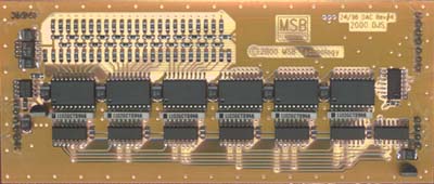

If you mean the PCM 1702 DAC, BOW technologies advertises that the latest version with parallel chips sounds much better than the early version with one chip per channel.
I borrowed a BOW ZZ Eight from a friend for a week, I was in heaven!

One should expect n times dynamic range for parallell operation.
Random noise should theoretically go down by sqrt👎
Noise should also be possible to reduce given that one needs lower value resistors to obtain the same IV characteristics
If one were to shift the units by say a few clock cycles one would also get a filtering effect which would be cool. I have looked at this extensively and it is relatively easy to do.
With parallell units one might also be able to get by without buffer stage which saves at least one amplification stage with it's inherent distortion.

Connecting DACs in parallel will only improve the dynamic range if the noise limiting the dynamic range is uncorrelated between the two DACs. If the DACs are quantization noise limited, then no improvement would be expected because the quantization noise between the two DACs is completely correlated.
Shifting the input to the second DAC does indeed produce a filtering effect similar to a rectangular FIR filter with two taps. This would tend to reduce quantization noise at higher frequencies, but it will also filter the signal.
Possibly two oversampled (noise-shaping) DACs would benefit from being paralleled if their reset times are staggered. Staggered reset would to a certain extent break the correlation between the quantization noise in the two DACs.

Well my DAC started of with 1 TDA1541 then 2 x TDA1541 and then 2 x TDA1541s1.
The way i've done it, is a by having 2 seperate identical dac prints which get the same input.
In my setup there is a big difference between a singel dac and 2 dacs parallel, there is way more details and control with 2 dacs.
Some day when I get the time, I plan to build 2 dac prints more to see if the gain is just as big as from 1 to 2 dacs.
I also considered balanced, but droped the idea because it's way more differcult than non balanced and also because non of my other gear is balanced.
