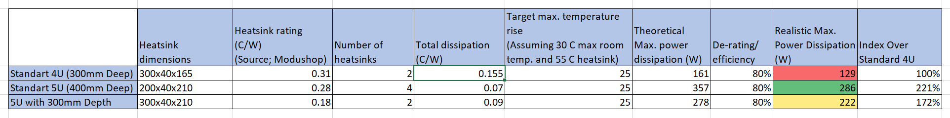

Zen Mod, I was thinking about the chassis, 500mm deep will be a bit on the bigger side, difficult to position it in the room. I ran numbers with 400mm deep (see attached table), it looks like OK;
i) With an efficiency/de-rating of 80% and
ii) Target heat sink temperature of max 55C in a 30C room
Per chassis they can dissipate 286Watts, which is very close to 288Watts dissipation need from 24V rails and 1A bias per device.
What do you think?
5U/400 is already darn big
from my experience with 4U/400 and I just once made an amp with 5U/400 ...... I believe 140W per side is too optimistic
however , I can't be sure 100% , just because I didn't make any notes
so , when you finish it , let us know 🙂

Regarding the 5U case dissipation, I had one with an F4 running 30V rails and about 0.6A per mosfet. So I had about 108W per side being dissipated. temperature was a nice 45º on the sinks with about 25 room air temperature.
Thanks a lot MASantos!
Have you also tried a bit higher bias?
With 30V rails, moving from 0.6A to 0.8A bias (33% increase) would end up having 144W dissipation per side (as opposed to current 108W)
With that 33% increase, 20 degrees C temperature difference in heatsinks over ambient would increase to 20X1.33 = 26-27 degrees C; which with a 25 C room temperature, ends up being 51-52 C heatsinks.
I wonder whether you have tried and it did not work out or you haven't tried at all. 🙂

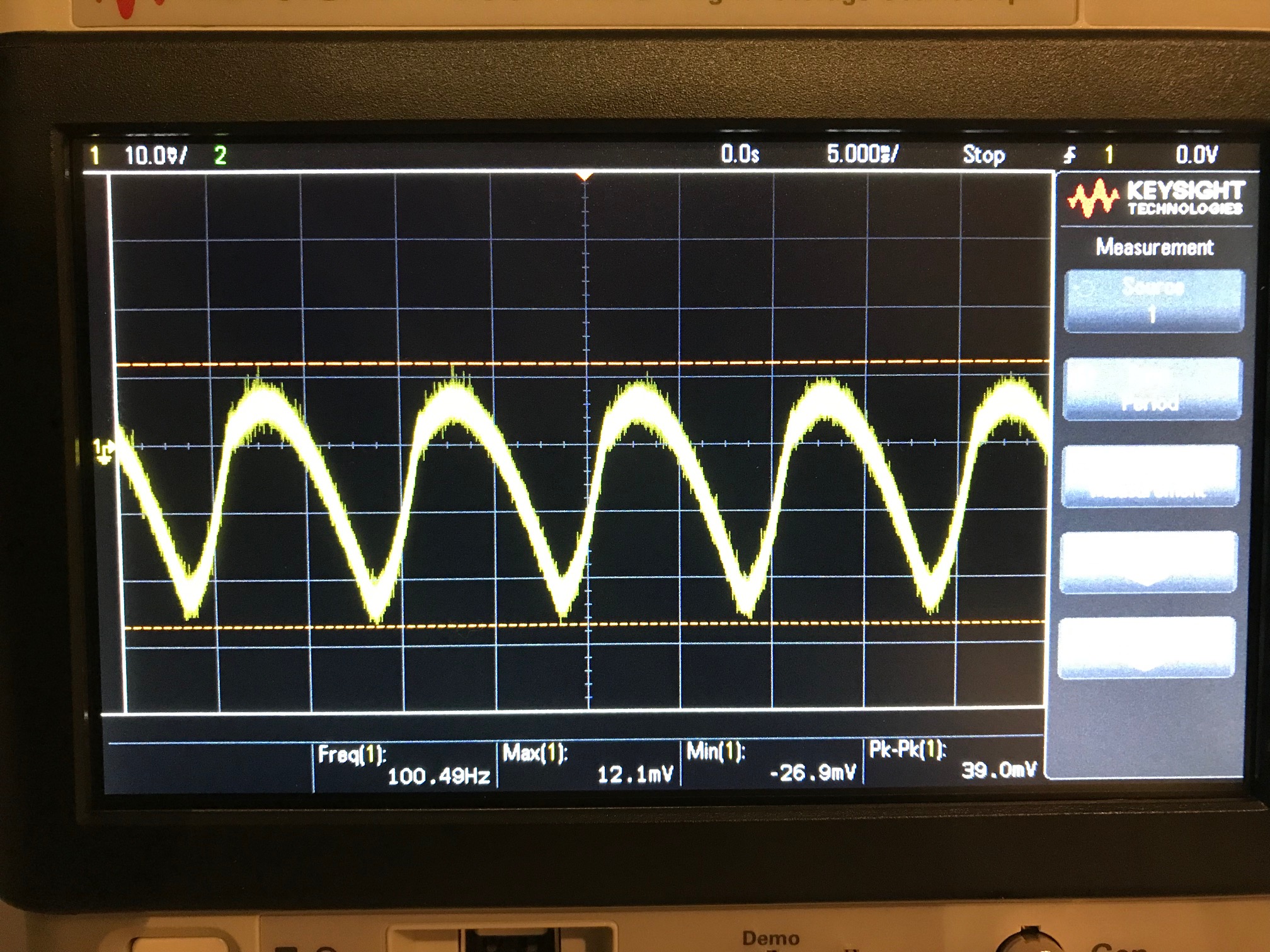

1) My F5 has a ripple of 39 mV (see the screen shot); It has Antek 4218 (400 VA, 2 x 18 V secondaries), Vishal 35A square bridge rectifiers and 8 x 47000 uF capacitance in CRC setup (R = 0.12 Ohm inline with NP’s paper)

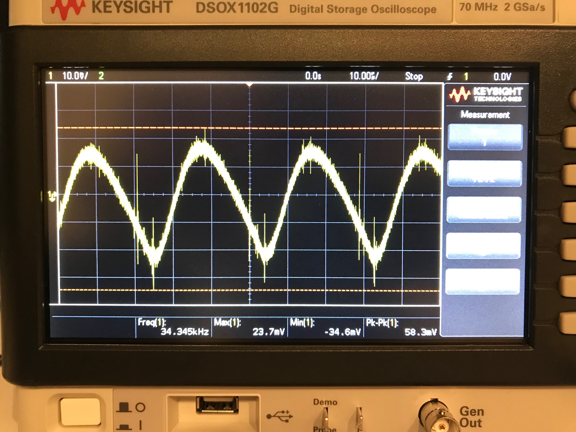

2) I also checked my ACA, it has a remarkable 59 mV after warm up (screen shot attached); It has the Stock 24 Volt 120 Watt Meanwell switching PSU. There is a capacitor in the amp side which acts like a coupling cap, yet I found this result quite remarkable as it is close to my F5.
Another difference is the fundamental freq. of the switching power supply is in 34 kHz as opposed to linear supply which is 100 Hz (in this side of the pond..)

My sims (which are just that: sims) show the FirstWatt production PSU (as used in F4, F5, etc.) at about 160mV. The notable exception is the F3 with about 6mV due to its c-multiplier.
Thanks! I believe this is broadly inline with my measurements. Stock First Watt F5 psu has 8x15000 uF capacitors whereas psu for my F5 build has 8x47000 uF: a bit more than 3x of the stock version.
Hence, ripple going proporationally down (given constant class a bias) would make sense.
