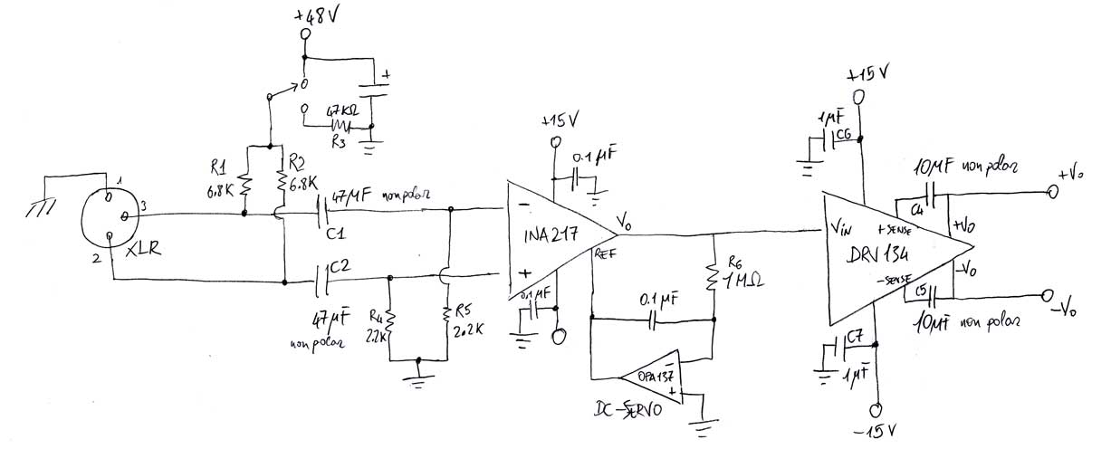

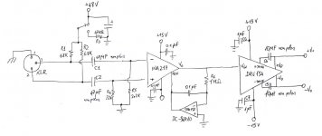

I'm building a microphone preamp based on an INA217 chip.
I'm trying to get a balanced output with the DRV134 line driver. I just followed the drv134 datasheet schematic (see the attachment) but I'm getting a lot of noise (a sort of white noise).
The output of ina217 is pretty quiet, all the noise is generated by the drv134.
I tried to remove C4 and C5, and to use different bypass capacitor but... nothing!
Is there anything I can do to solve this? Do you suggest other solutions to get a balanced output?

Hi, I'm not sure on this one as the output of your INA217 should be faily low impedance but could your problem be injected noise from the 1M servo resistor.
Also what gain have you set the INA217 for as you want to gain it up at this stage, not pass it to the DRV137 at a low level. The DRV is intended to operate at line level not at microphone levels. Your diagram shows no gain resistors if this is the case then you have a gain of 1 which is not suitable.

Looks like he copied most of the schematic from page 7 of the data sheet but he omitted the 4 protection diodes. It would be better to have them in, especially when turning on the phantom switch with no mic plugged in and probably take out the INA217 in the process.
I didn't omit the 4 protection diodes, I haven't just draw them on my sketch...

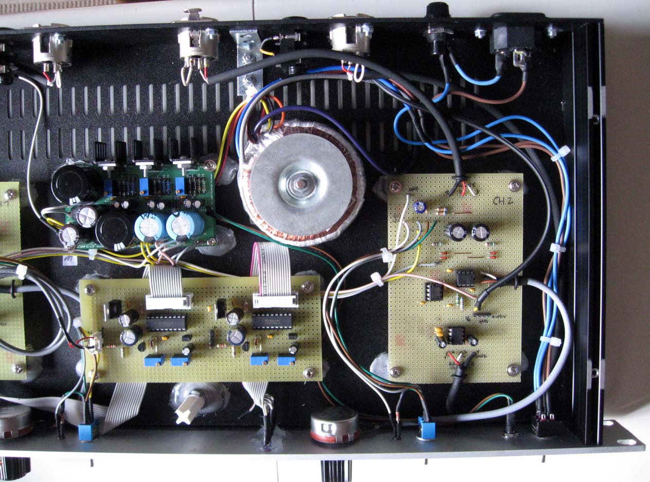

I must admit that the preamp hasn't got a real "layout", I didn't use a serious pcb but I arranged the components on a stripboard (as you can see on the photo... the preamp is on the right side, on the upper left there's the power supply, and the vu-meter on the lower left). Anyway, this is one of my first projects!

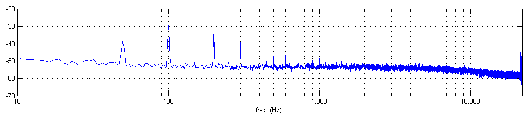

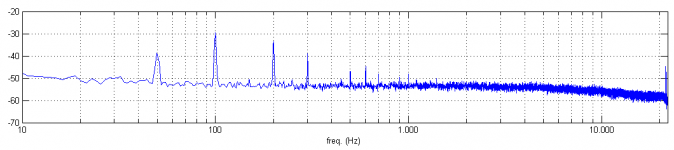

I've also attached an mp3 clip of the (amplified) noise at the output of the DRV134 and the FFT spectrum: it is almost flat with some peaks on 50Hz and its harmonics... When I record it is more than perceptible over the signal.

Very good, for one of your first projects!
I think that what you are hearing should not be called "noise". It is probably "50 Hertz hum" (plus some harmonics of 50 Hz).
One thing that might be contributing to the hum problem is the close proximity and the parallel proximity of AC Mains and signal wires, to each other.
If you can route the wires so that the AC Mains wires (and the transformer secondary's wires, which are also 50 Hz AC) are not close to any other wires (such as DC, signal, or DC or audio ground), that might help a lot.
Also, at the same time, if you can tightly twist together any wire pairs, such as the AC line and neutral, and the transformer secondary wires, and any pairs of corresponding signal and ground or DC and ground wires, that might also help a lot.
If any DC or signal or ground wires "must" cross near any AC wires, they should cross at a right angle (90 degrees/perpendicular), and should never be be close to, and/or parallel with, each other, the AC wiring.
Another situation (partially included above) that can contribute to inducing hum in the audio portions of the circuit is when a signal or DC path and its ground return path are separated, so that their "loop" contains a significant geometric area. Any DC or signal and its corresponding ground return should be run very close together, so they don't "enclose any area" by having space between them. Otherwise any changing magnetic field, such as the ones from an AC transformer, or even AC wiring) can much more easily induce a corresponding AC current in them. That is why I suggested twisting-together any DC or signal wire and its corresponding ground wire, above. But you also need to check whether any pairs like that have been routed far apart from each other, and try to route them together, instead.
If you can correct and thereby eliminate those possible causes of the hum problem, then we can proceed from there, to see if there might also be a grounding-architecture situation that is contributing to the hum.

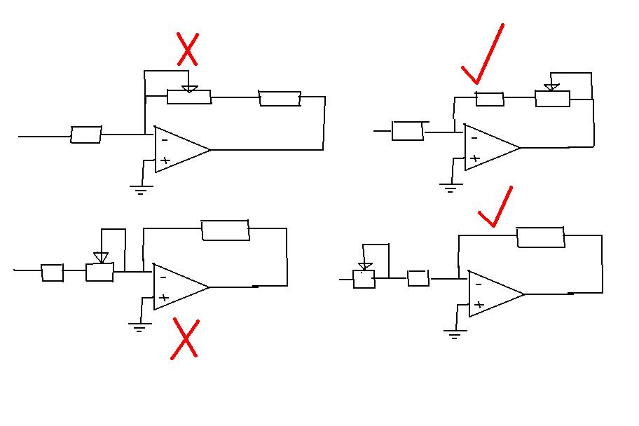

The gain of the INA is regulated by a potentiometer. For recording guitar with a condenser microphone, for example, I set a gain of 65 (150 Ohm resistance).
These instrumentation amps are sensitive to stray capacitance presented to the gain set resistor terminals (inverting input nodes). You sometimes only need several pF here to induce enough phase shift to casuse oscillation.
If you're setting the gain with a potentiometer (presumably) located some distance for the chip, it may be necessary to isolate the lead/track capacitance by adding two small value fixed resistors in series with the pot, each resistor being located right at the IC pins.

Actually, this is a hell of a good point raised by GK. Back when I started a few decades ago, I wondered why my LF356 preamp was noisy, oscillated and seemed to pick up all sorts of crap. Well, my feedback resistors were located about 6" from the actual op-amp inverteing pin and I had a long pcb trace making the connection. Always keep the feedback resistors, and especially the junction point, right next to the inverting pin - and I mean right next to it. Ditto for any feedback amplifier.
