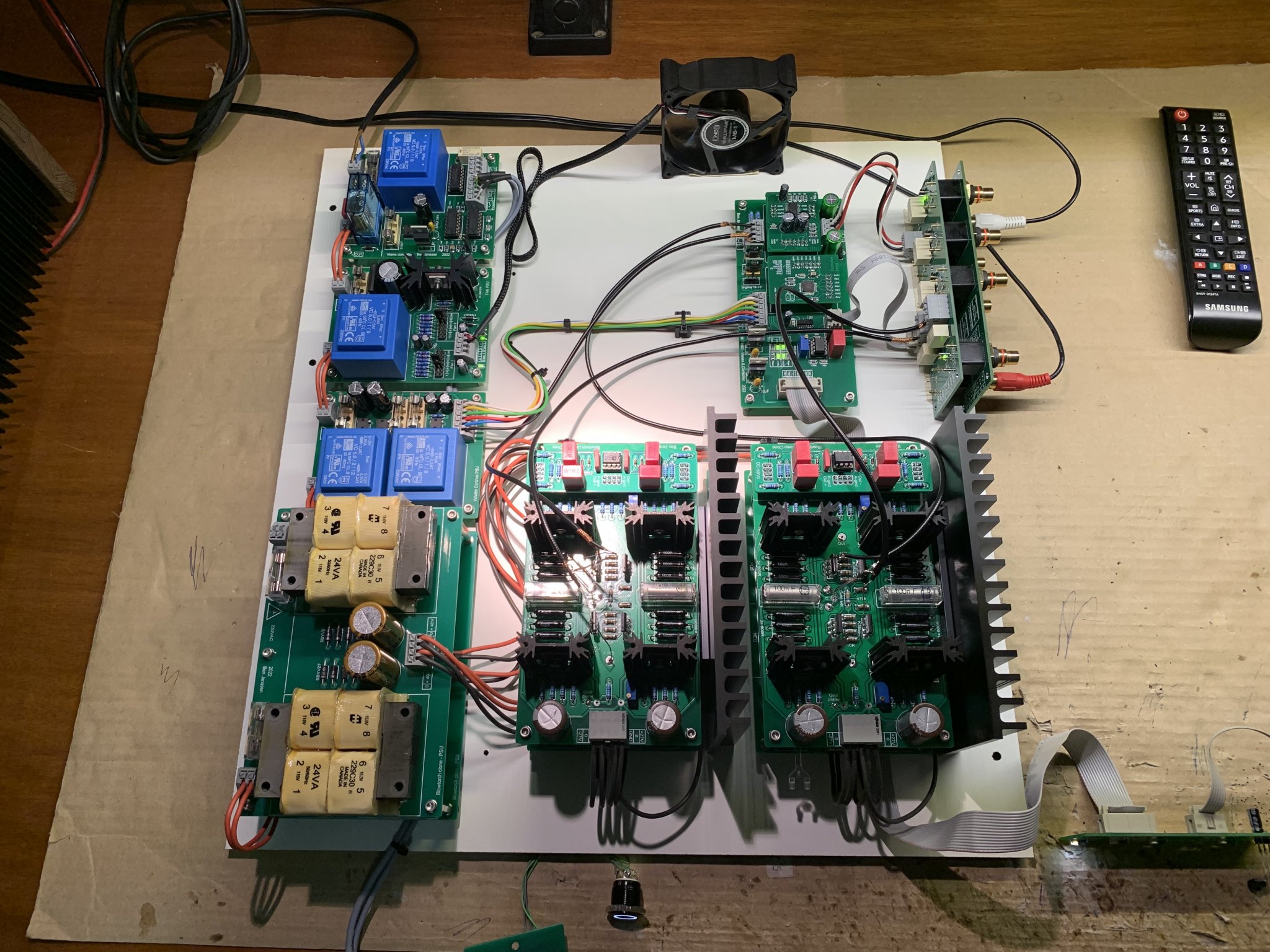

I’ve build a clone Blowtorch line amp. See picture of build and circuit below.
As I’m busy with the actual assembly of the PCB’s on a bottom plate from the enclosure, I was testing with different wiring layouts and wires itself (twisted solid core and microphone coax).
During this testing I noticed that one of the 2 balanced line amps generates a Hiss / white noise on the ‘+Out = OUT_P’ output. Taking the signal from ‘-Out = OUT_M‘ gives no noise. Noise sounds like: Analoge ruis - Ambient Reel to Reel Bandrecorder Hiss & Hum - YouTube
I don’t have the knowledge to tell whether a Jfet or a mosfet can generate this as a failure mode due to a static decharge for example. And before I start to remove and change parts, I would like to ask here for experience.
Which part is highest change to resolve this noise issue?
Thanks in advance

Problem found when probing with the signal wire running to the power amp and trying to find origin of noise.
One Jfet inside the 2SK389BL of the noisy side of the balanced line amp was the issue.
Luckily I had another 2SK389BL with about same IDSS value. Difference in IDSS is 0.08mA.
