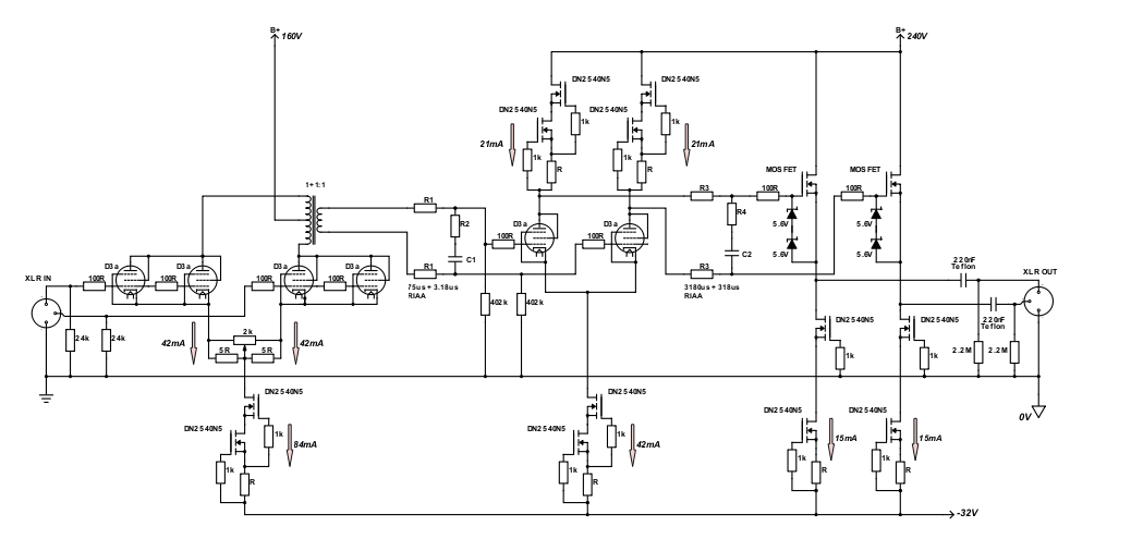

This is my first post and I would like to show you the circuit and concept of my balanced phono preamplifier (MM), and ask some advise. It is mostly based on the design of Morgan Jones and SY's His Master's Noise preamplifiers. For low noise the tubes are high gm D3a-s with split passive RC equalisation networks. The balanced design is 3dB noisier than the single ended, at the first stage there are 2 paralelled tubes, that decrease the noise by 3dB, so the first stage is as noisy as the single ended version. The first stage is transformer coupled to the second stage. I think at the first stage, where noise is the most critical, transformer has some advantages.
- Lower DC resistance and lower Jonson noise (but I know this is marginal)
- Lower HT is lower noise from the power supply (I will use the Morgan Jones statistical regulator)
- CMMR of the transformer decrease the common mode noise from the HT and long tail CCS
- No need of high value coupling capacitor
Do you think I am right or do I miss something and it does not worth it? Lundahl or Monolith magnetics IT transformers are a bit expensive. Because of the low signal level I suppose, I have to make a mumetal shield as well. I have to balance the transformer for zero DC imbalance by a trimmer potmeter in the cathodes, that inject some noise, but I would use a trimmer made from SMD resistors, like any volume control, so I think it would be not a problem. I have not calculated the exact values for the RC network yet, I have not decided what capacitor I will use.
Here is the circuit, the pdf file is nicer.

Why not simply amplify the 5(?)mV input to a sturdy 1V with a couple of low noise FETs? A summing amplifier made from a coupled cathode triode pair can act as a buffer. Or, first run the RIAA correction to have over time stable Rout.
SYs equal opportunity MM is a much nicer approach to balanced phono. You must minimise capacitance for MM use.

I did not mentioned, but I will use the MM preamp with MC cartridge and MC transformer, so input capacitance is not a problem. But the D3a-s has about 210pF Miller capacity, 2 in parallel and they are in series by the balanced design, so the input capacity is 210 pF.
I have couple of D3a-s so I would like to use them, that's why I made this tube circuit.
In the second stage the 3 ccs should work, the 2 ccs in the anode just an active load, making the loadline horizontal. But it could be BJT or current mirror also. I do not know the high voltage current mirror works better here, than the ccs.
First I just do not know if the transformer (1+1:1) is a good idea or just waste of money and a resistor or ccs is the same good?
I read in this thread, that Vinylsavor likes transformer coupling for LCR equalisation network. (But I know RC network does not need 600 Ohm impedance and step down transformer.)

OK, I understand. I just did not want to make the second stage too difficult.
I was thinking to make the second stage a mu-follower, but I have to use just too many tubes and elevated heater power supply.
But then a gyrator loaded differential pair would be a good solution? The low output impedance would eliminate the change of the plate resistance with tube ageing.
