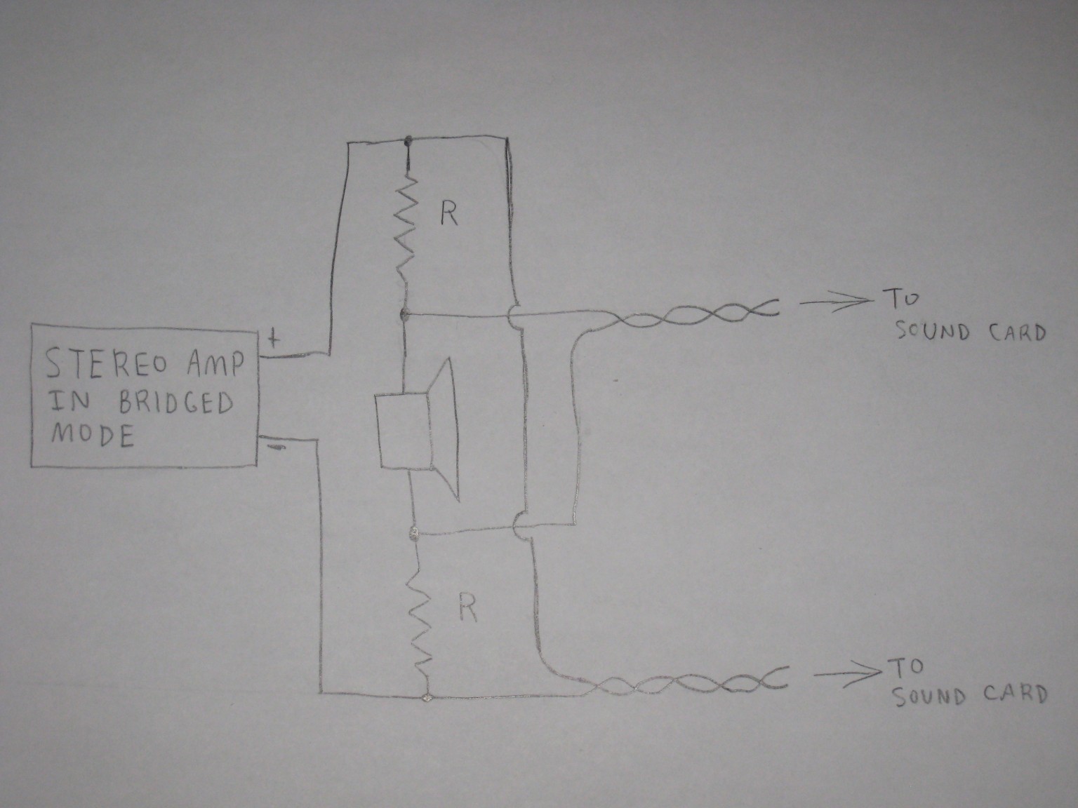

How I would envision a balanced speaker tester:
Voltage divider consisting of R+DUT+R.
Like this, there's no need to mess around with active circuitry just to create a balanced outputs.
Connect one input pair across the DUT, and the other input pair across the entire R+DUT+R divider.

I am getting somewhere passively. The issue is the power amp output is at chassis ground. I had made the old stupid mistake of connecting 2 to 1 on the wrong end of the cable. By lifting the jig chassis bu 1K, I got the signal ground and chassis a little separated, so I got about 6 dB out of those. If I put balanced input receivers in the test amp, that will allow further chassis from signal ground. I am really looking to get actual balanced inputs as in signals 180 out of phase. That takes either electronics or a transformer.

A setup like the following (see pic) will give real differential pairs that your soundcard can record from, with no common-mode voltage I wouldn't expect a non-transformer soundcard to handle. The only thing is you need well matched resistors. This is just for the impedance measurement aspect; everything depends on the functions you want your gadget to do, which are unclear so far.
You can even do the bridged thing using a regular stereo amplifier and a transformer with dual secondaries.

My current test amp is not bridgeable, but I may have one in the shed that is. That does solve the problem of getting a true floating differential signal.
I don't get what you mean about bridging an amp with dual secondaries. I thought all you needed was a phase splitter on the input, half the gain, re-compensate, and be sure the feedback does not go wild.
