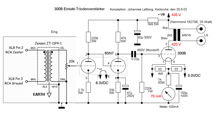

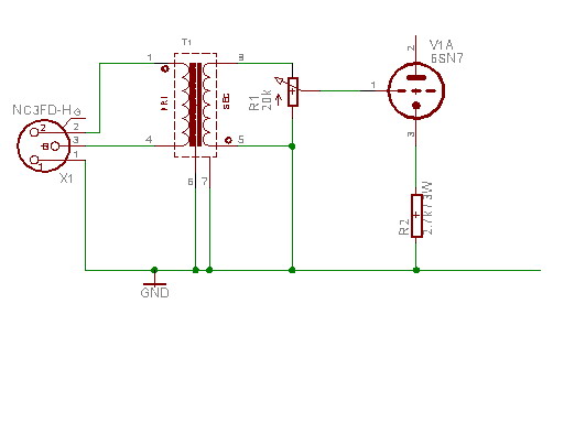

if you want to go all-out and throw in two tubes I'd use a LTP with pentode tail. The electronic equivalent except it has some gain to boot.
i know about a LTP as a PI, but how do you use one for coupling the two ballanced signals together??? i've never seen it done before, but i'm very intersted to learn.
cheers.
Just the opposite of a phase splitter: feed the balanced signals to the respective grids (remember, the circuit acts like an op-amp with very limited gain) and take unbalanced output from one of the plates.
Tim
Tim
Since both plates will present an amplified signal with opposite polarity with respect to its input, choose the one you require.
Something like this:
Cheers,😉
Cheers,😉
Steve Eddy said:
You can even go a bit further and have ALL of the amp's voltage gain done passively using transformers. 🙂
se
Sounds cool! Can you give more details?
grataku said:Sounds cool! Can you give more details?
Pretty simple. Basically just the use of a step-up transformer coupled to a voltage follower.
There are some practical limits however so you're looking at a rather low power amp. The one I've been working on is about 8 watts. Not that that's necessarily the upper limit.
