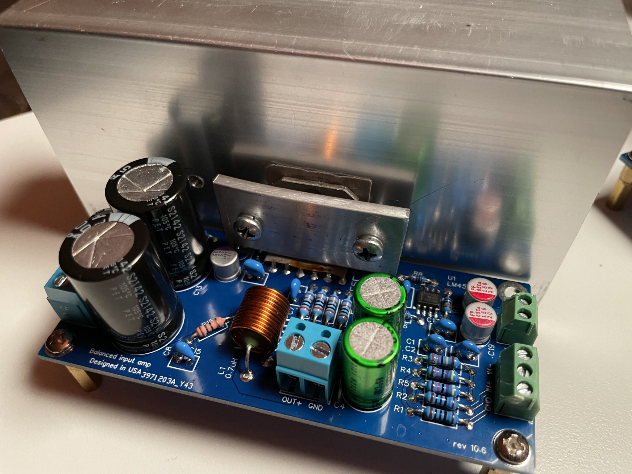

Balanced input LM3886 design and PCB layout
Swapped few opamps today to see if there is a difference in sound.
Opamp is loaded with 1k and has voltage follower or buffer topology.
OPA2134 - my favorite - sounds warmer and connects all of the sound stage together. Clear sound.
LM4562 - my second favorite - very accurate and spacious sounding - every instrument or sound is there to the point where it seems that you can stretch your hand and touch it (or point on it). At moments it felt like the amp was "singing" - such clear mids.
NE5532 - did not like the sound - it was blended and little messy, though clear when not many instruments were playing.
TL072 - similar sound to 2134
While going through the OPA2134 datasheet I noticed that it's THD is dependent on the supply voltage. 18V dual supply gives the lowest THD.
I therefore proceeded to increase opamp voltage from 14.85V to 16.95V. Doing so improved the sound even more.
Running it at 18V or close is something I'm little afraid of as it is the max rating for the power supply voltage for this chip.

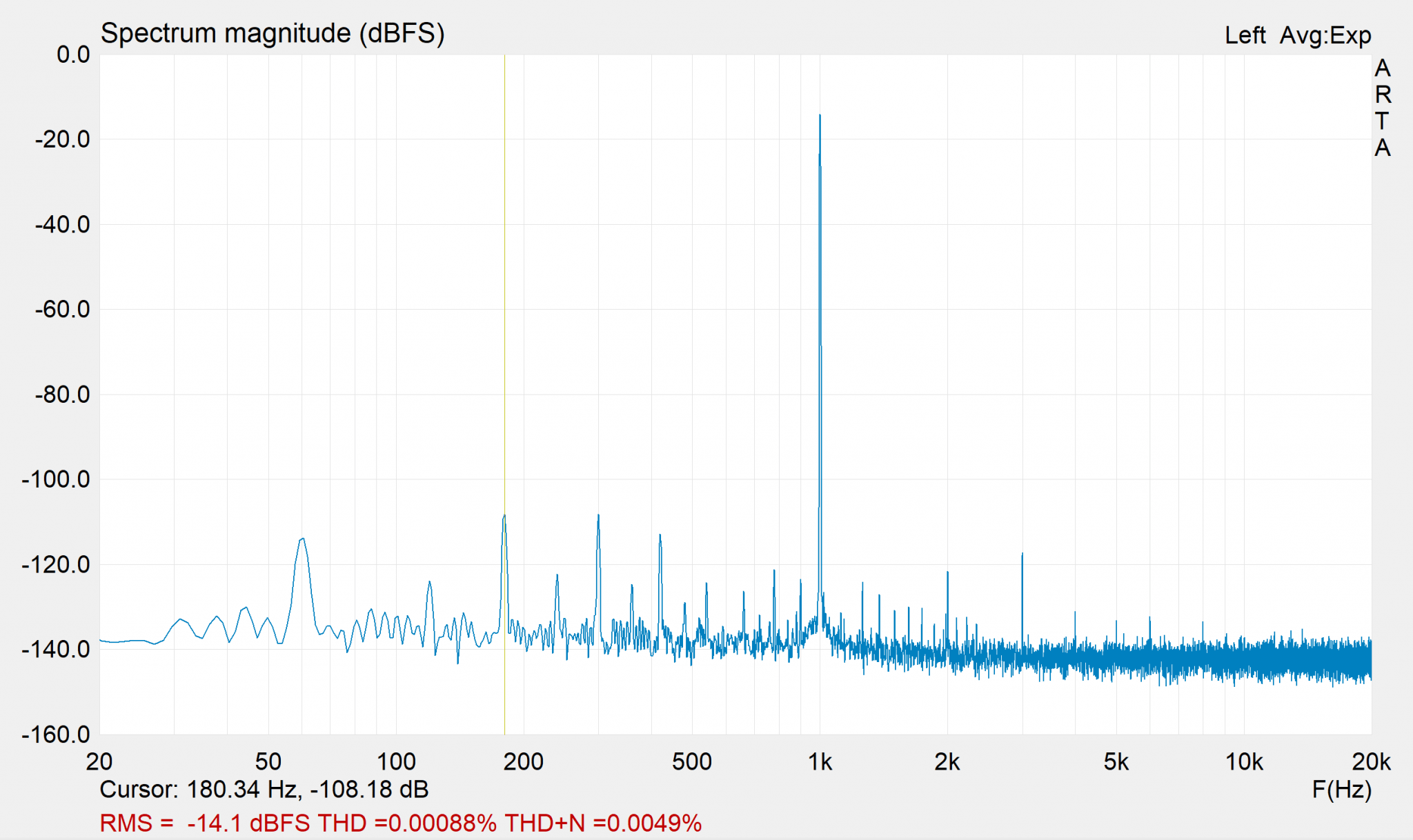

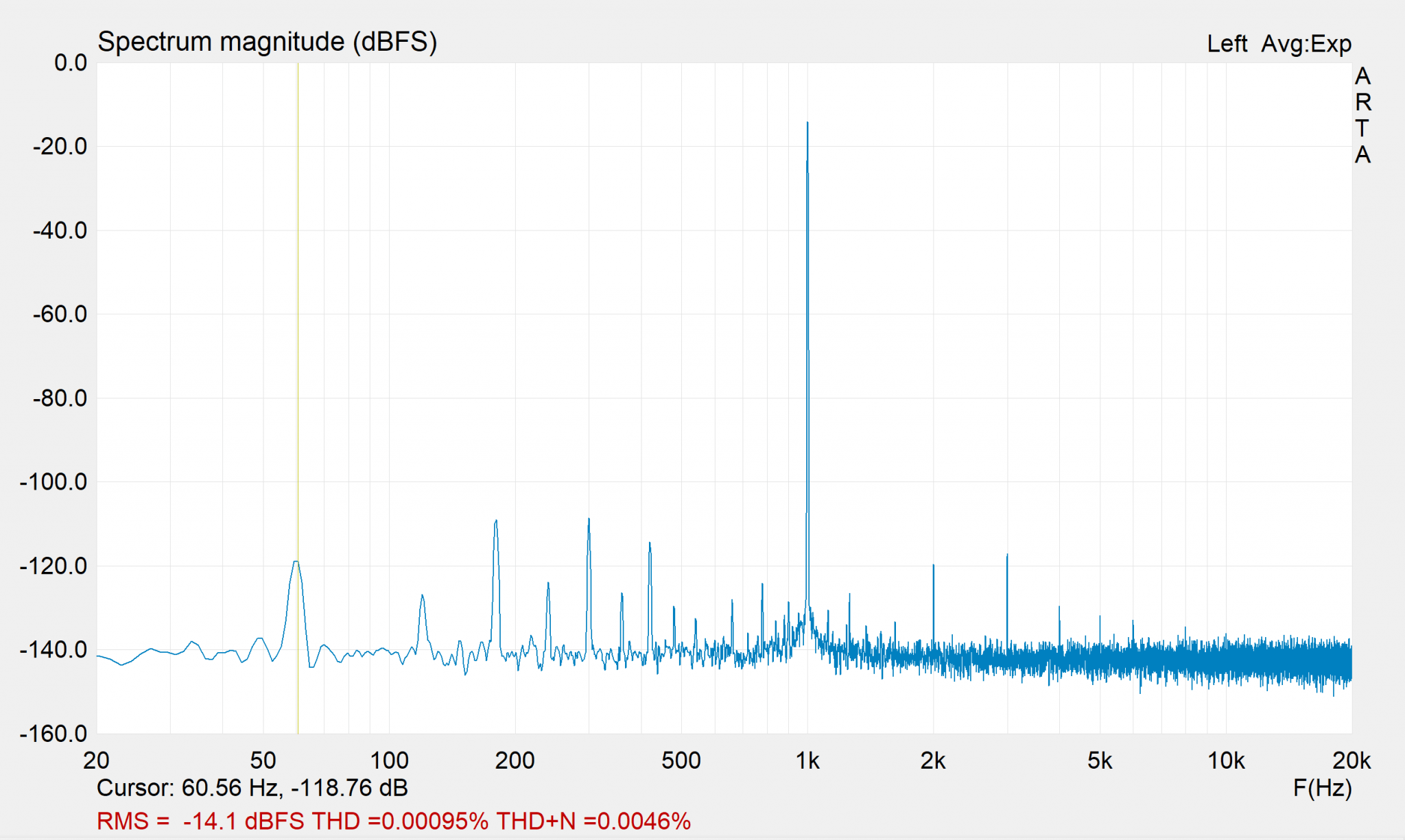

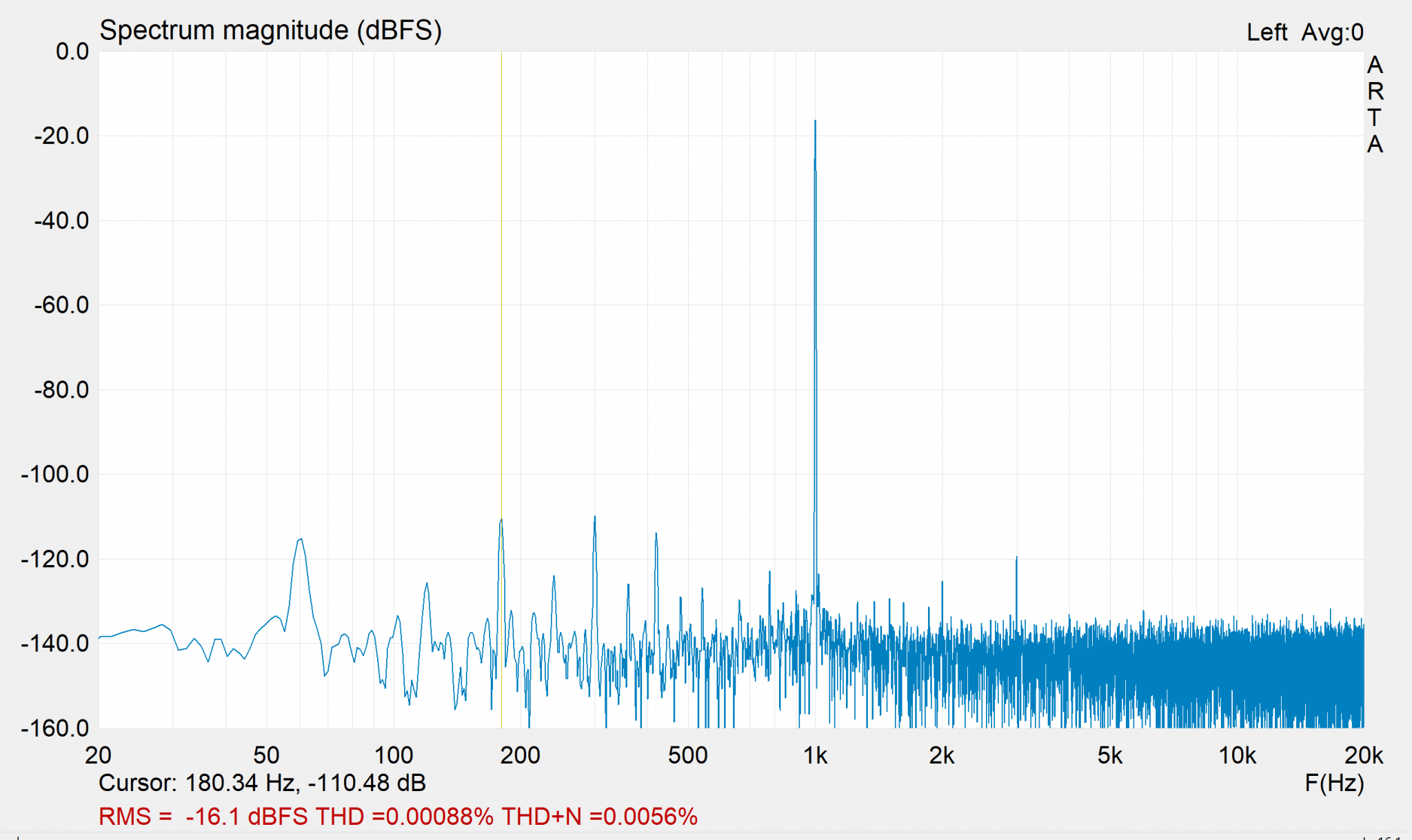

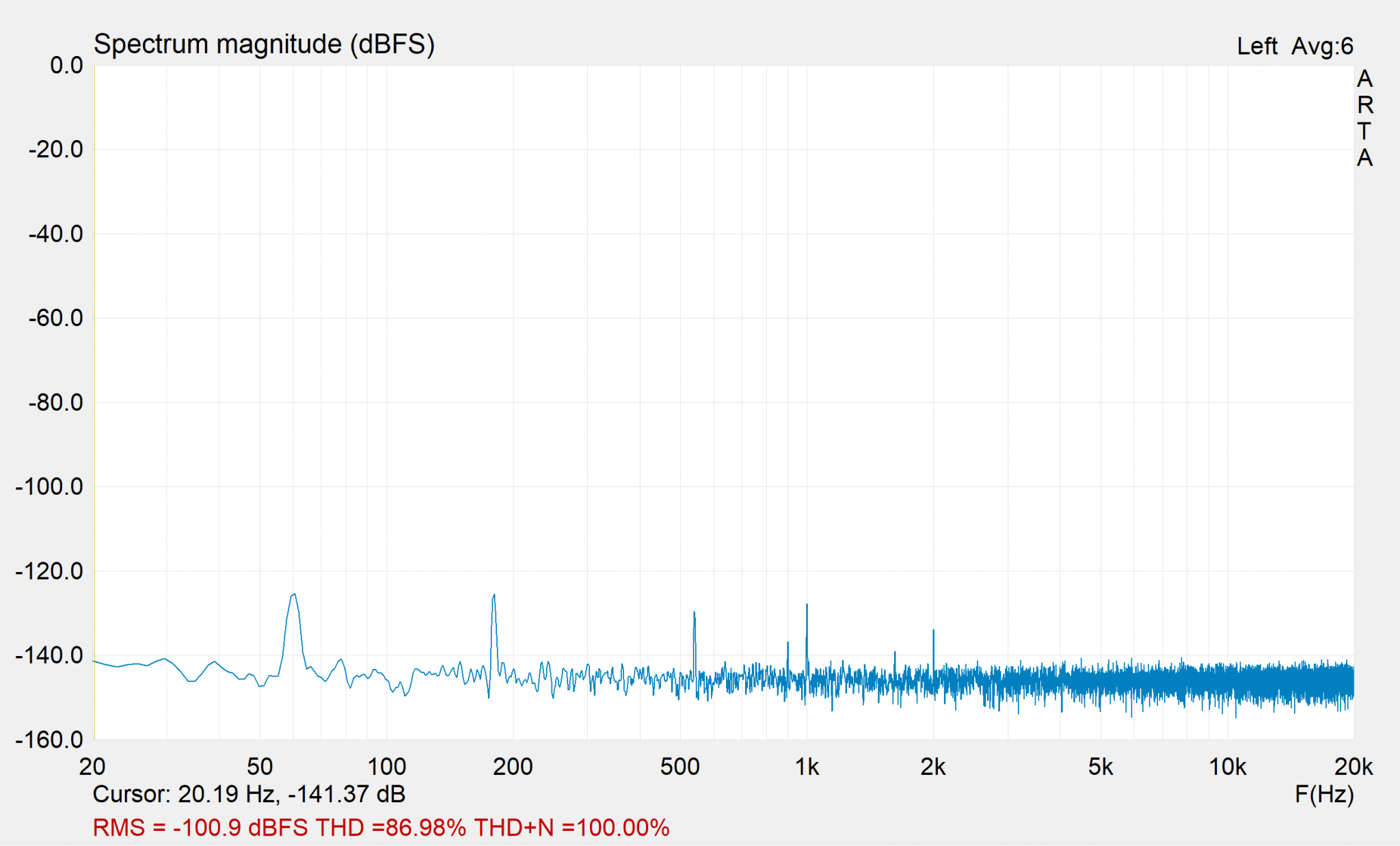

Update on the project:
There was a mistake in the layout for the LM337 negative voltage regulator. Pins IN and OUT were swapped. Had to fix that.

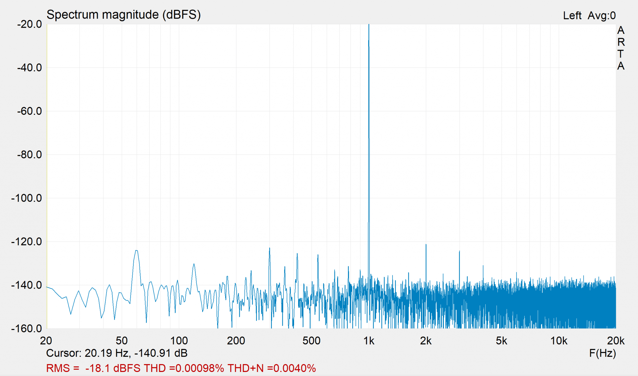

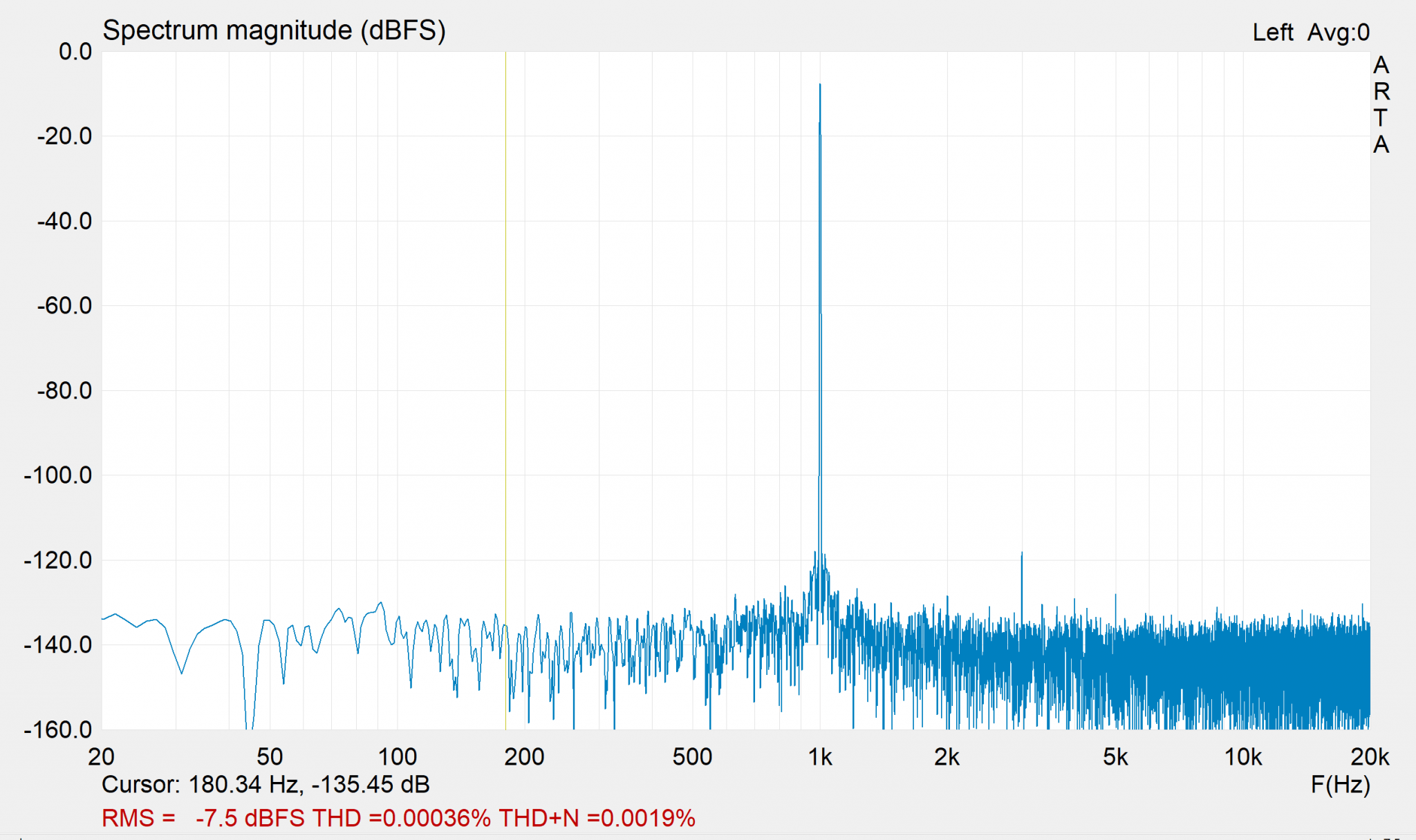

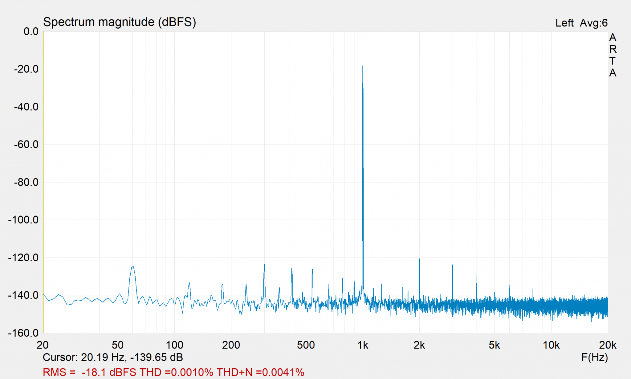

Also measured THD and THD+N using modded w OPA1612 Focusrite audio interface. My guess is that I actually need to get better power supply - possibly regulated PSU using LM338?...

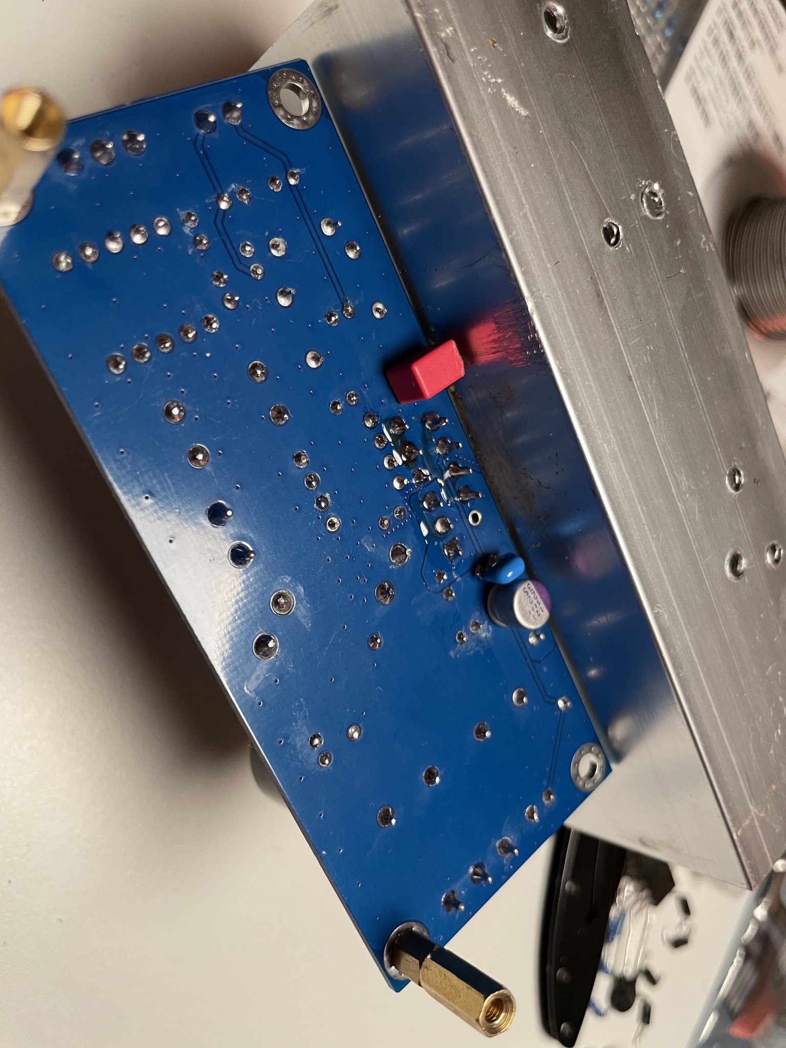

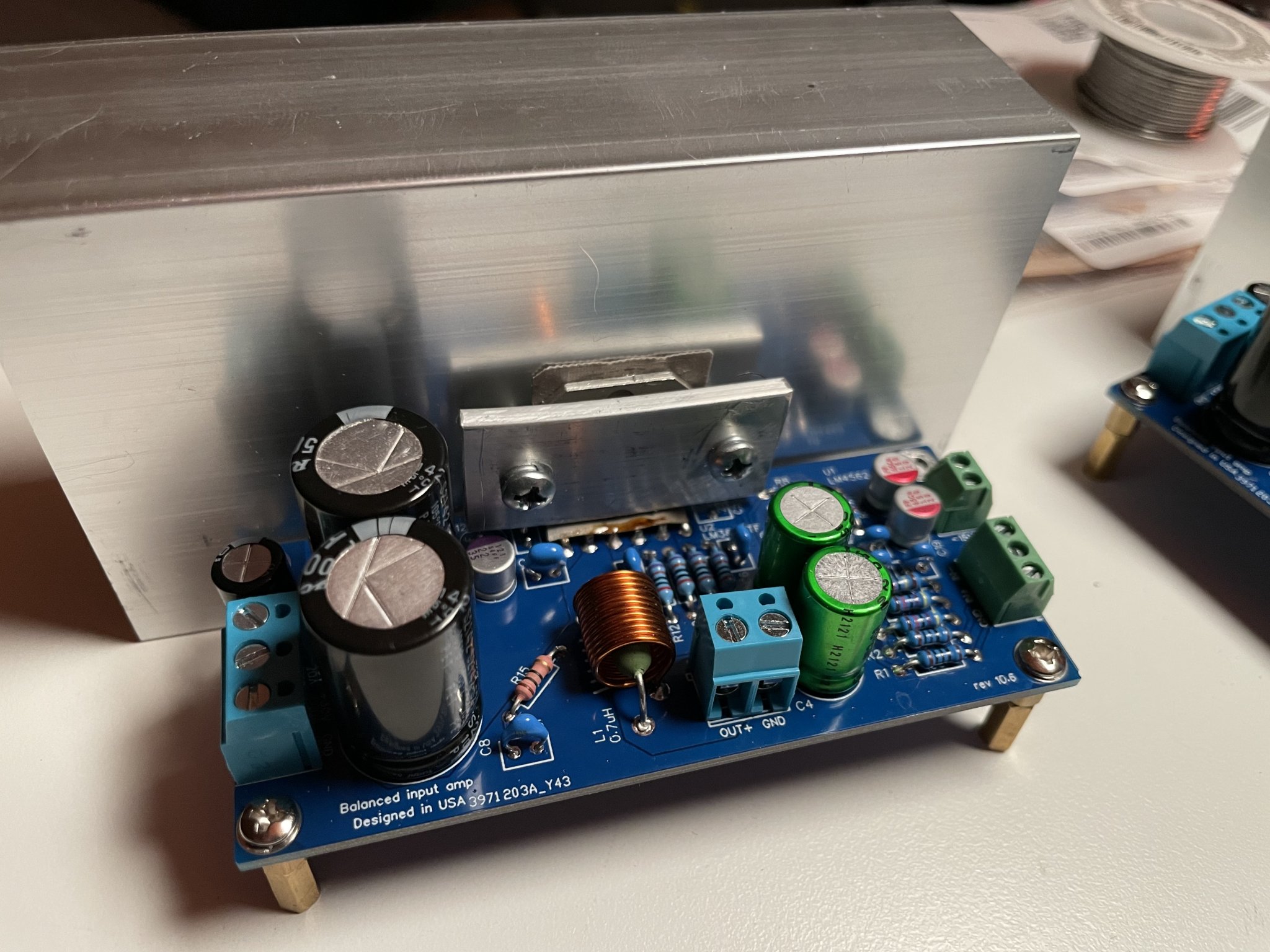

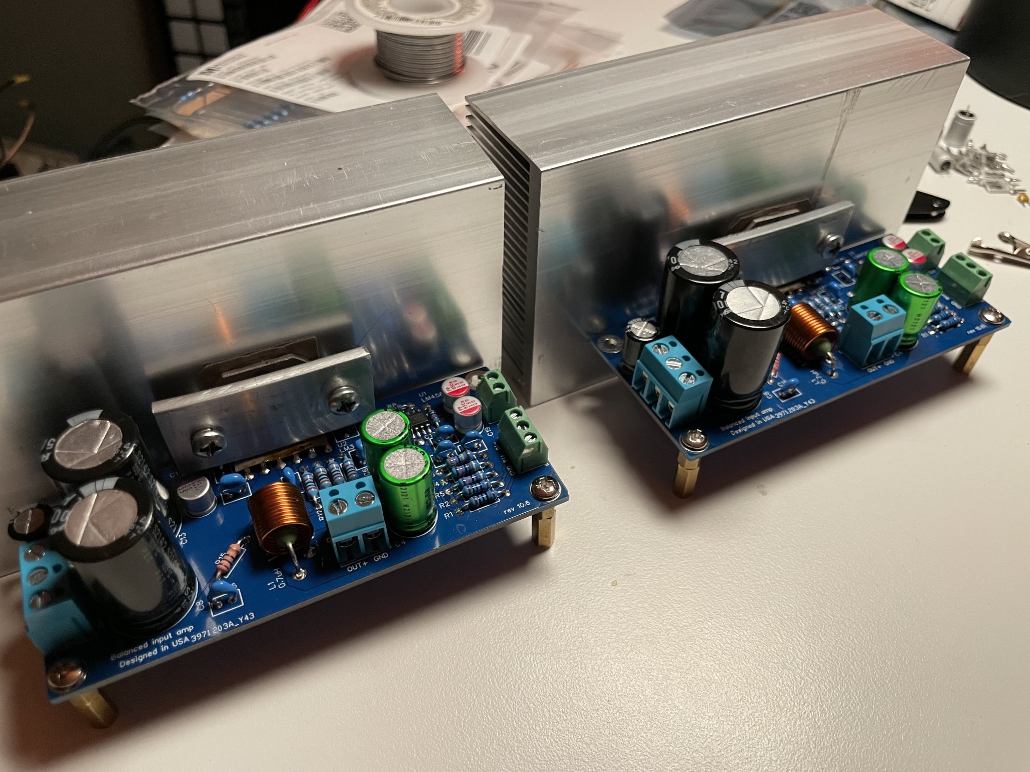

I decided to go with simplified design and move 15V regulators out of the board. Attached pictures of newly assembled amp modules. Yes, I had to resolver poor LM3886 about four time now each.
Opamps in soic package were used - OPA1652 FET input.
I am also removing linear power supply and replacing it with Connex SMPS300RE.
