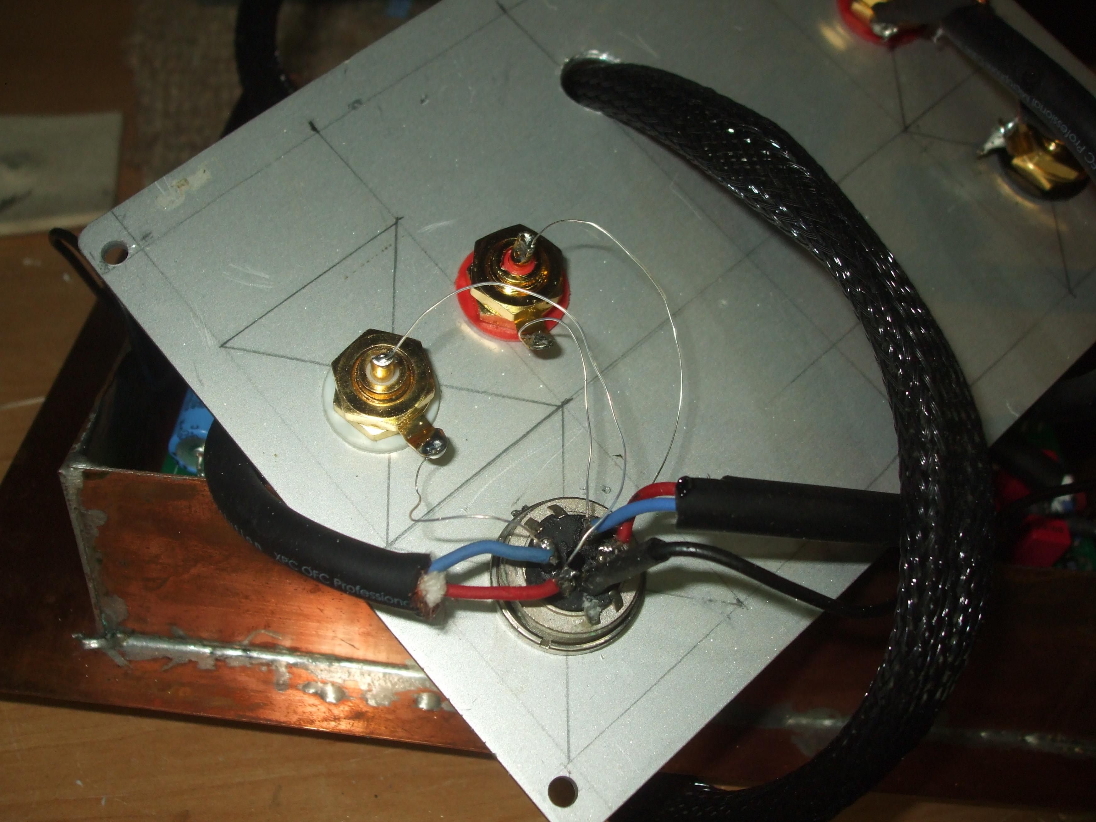

I had FDW balanced on a 5-pin plug now TT is on normal RCA
IMO 5 pin is beterer (fell free to get big red biro to correct spelling mistakes I will feel free to suggest alternative use for it while U waiting for my next post. CAPISH ?!)Not going to start FiFi revolution now I will have to fit both

Done!
Double plugs on input eventually I will change TT back to 5 pins for now compromise aloud for direct swap between 2 Preamp stages.

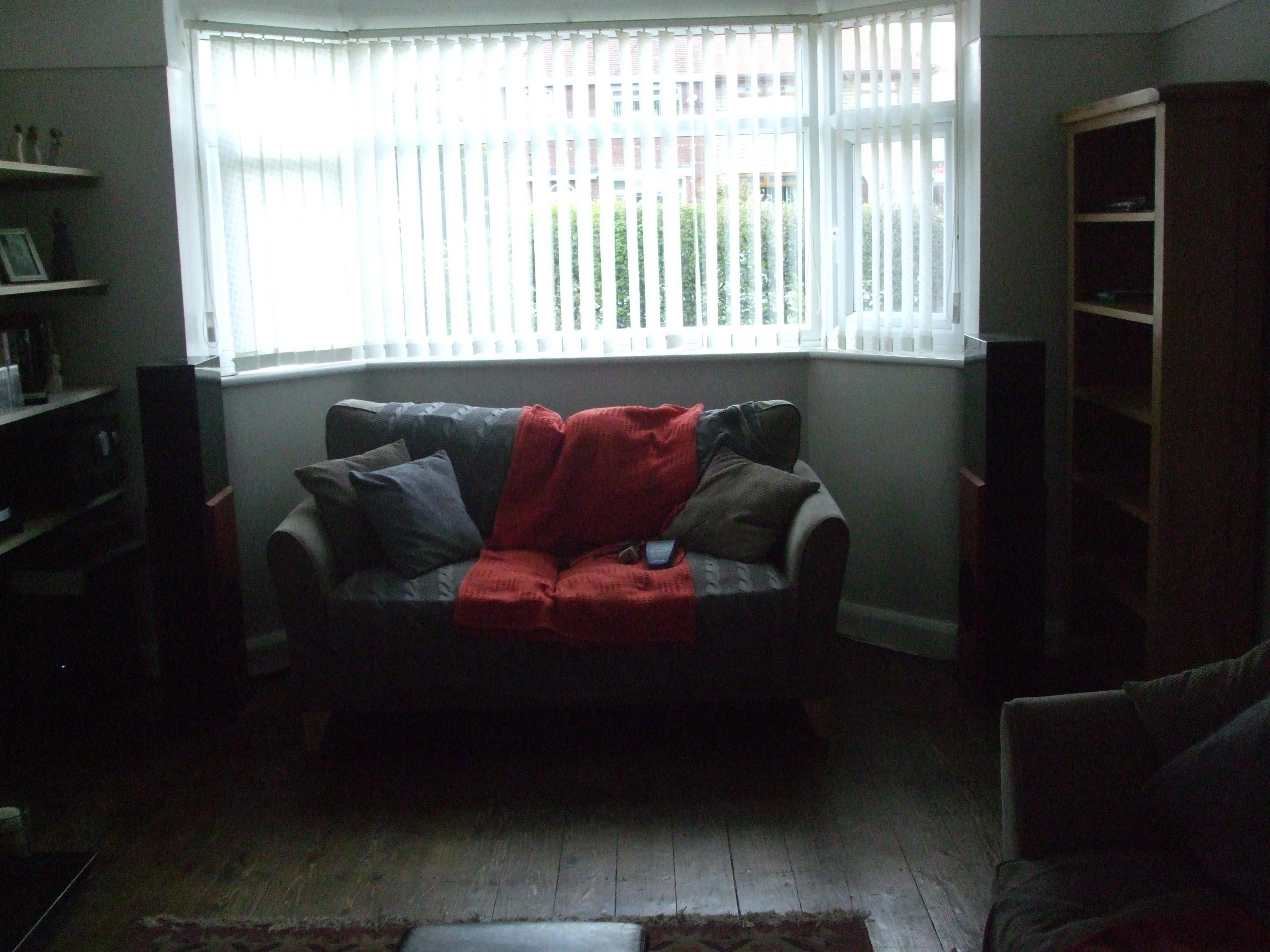

Current set up again compromise as one have to put up whit couch be in the way and the F5 hidden behind it.
Beat FiFi being part of garden rookery or life as single.

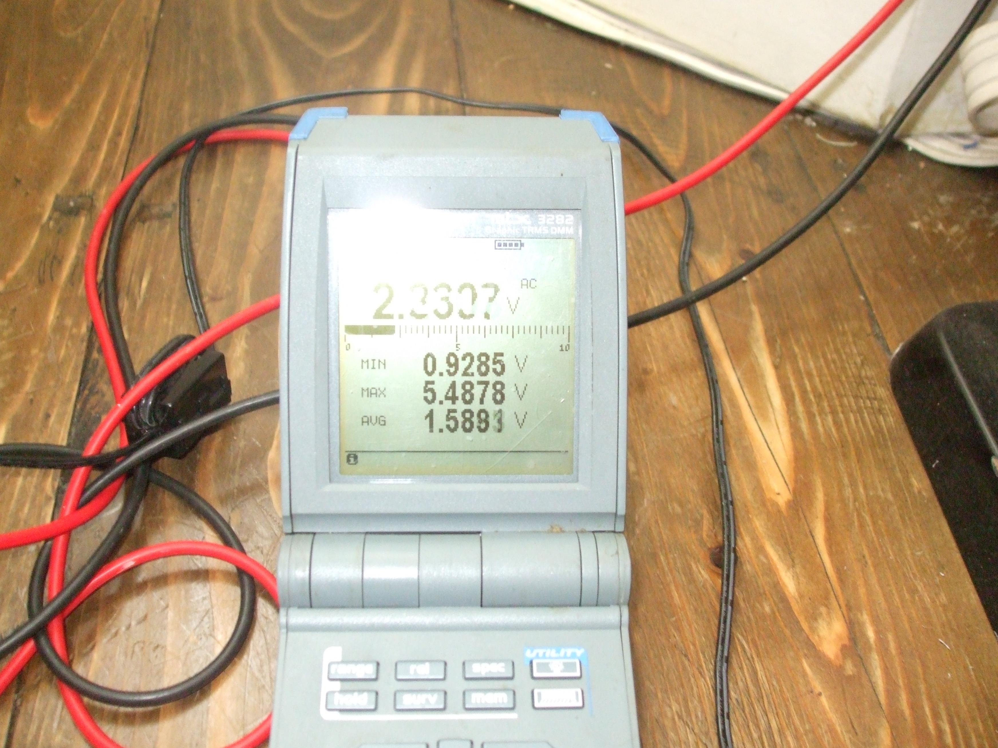

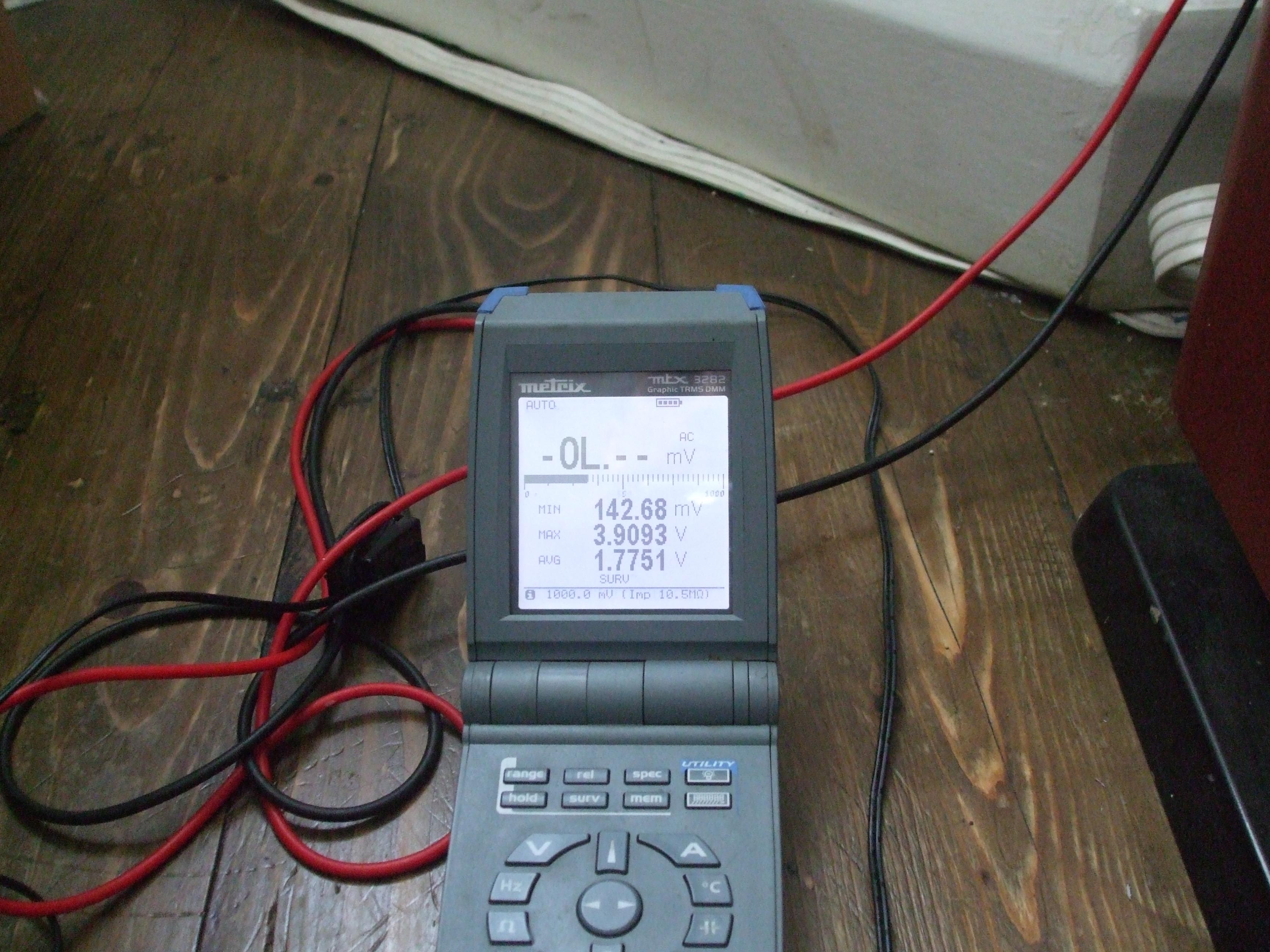

The second is considerably louder
3.9 V peak out of first one 5.4 peak out of second from the first track on side one.

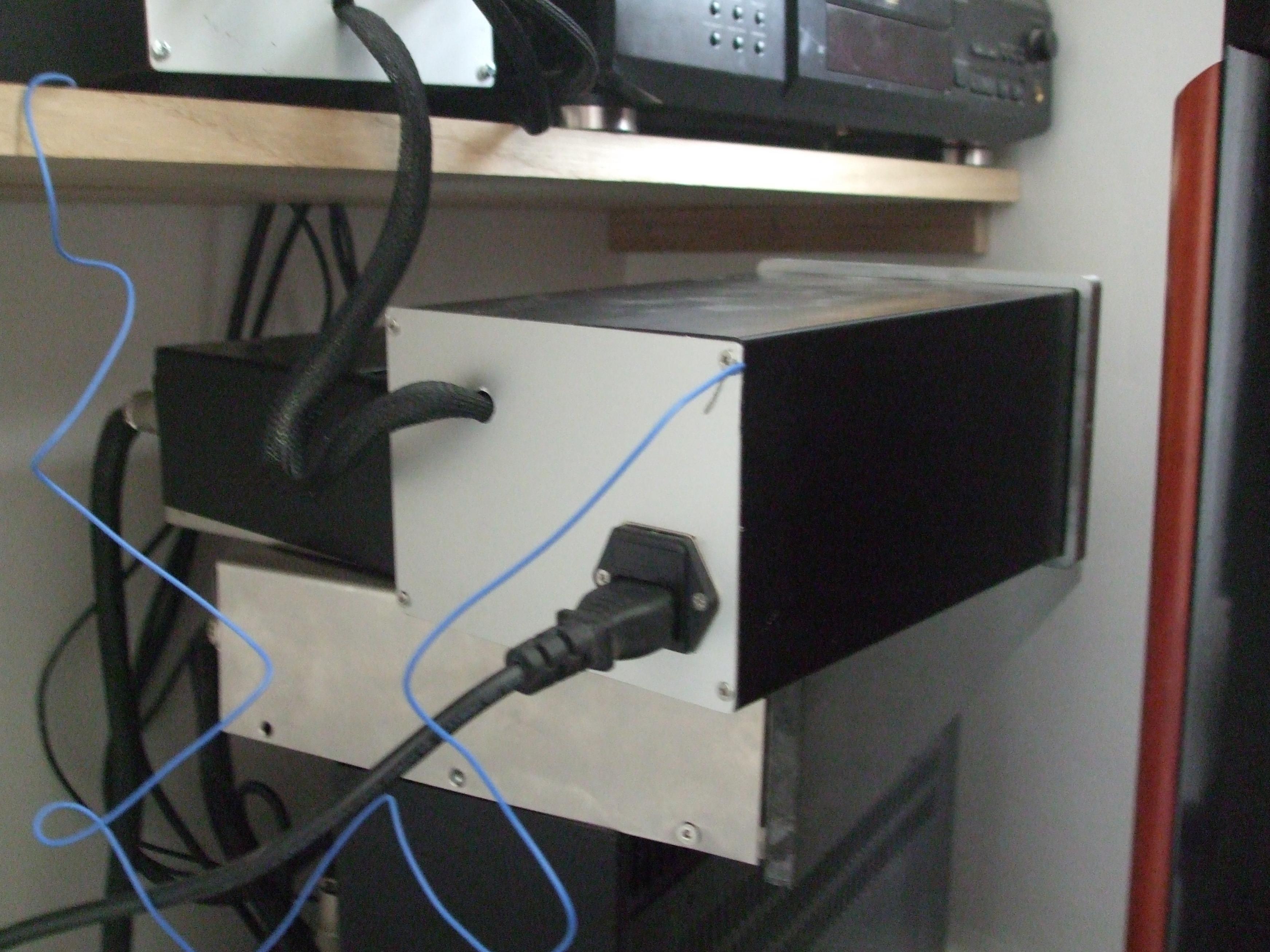

After 3 years Frans Balanced is out of the suitcase I had to use bit of wire from TT to PSU box to ground TT tonearm and.... total silence thing is broken what do U espect after 3 years
But no is not
Is just much quieter than other one
And other one is pretty unfair competition being R2 Paradise.
Frans Balanced is playing away still on that Grace Jones album... just turn volume down a little bit to get a feel and set volume to that 3.9 V and then... she is back and 4 V out of 87dB speaker apparently is enough to disturb neighbours and I am to chicken to be single so time to tidy up and while there is same time left I am going to drag the lot to the loft sod stupid RCA Phono Plugs and go back to the 5 pins one!
Just have to make adaptor for when things are travelling around...
