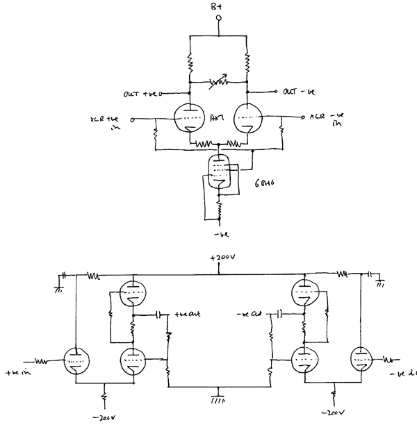

balanced grounded grid preamp
My plan is to use Long tail phase splitter for balanced input. (See the top schematic). The output is then connected to the input of the lower schematic.
