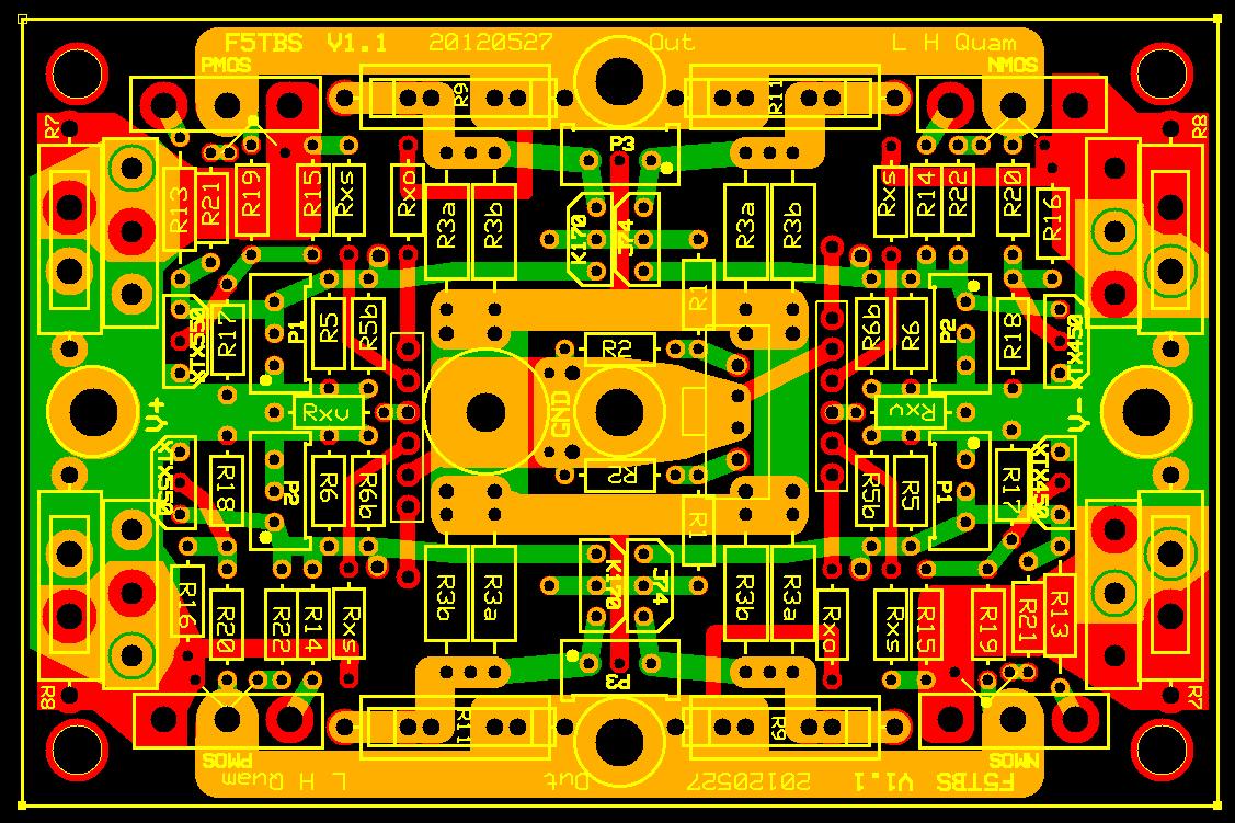

Yes I had a few F5TBS-v.1.1 boards built. The image below shows the artwork. The board has numerous options:
- One Balanced F5 (with or without turbo diodes)
- A pair of unbalanced F5 channels (with or without turbo diodes)
- A single unbalanced F5 channel with 2 MOSFETS per rail(with or without turbo diodes)

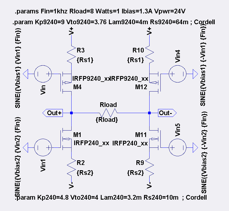

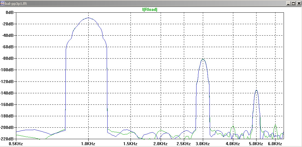

I have crunched equations and run simulations that confirm by previous statement (conjecture) that in the balanced amplifier it may not be important that the PFETs match the NFETs. The simulations are of the output stage only and with no feedback, being driven by perfect sine wave voltage sources. Show below is an extract of the schematic.
With 2:1 mismatch of the transconductance between the PFETs and NFETs vs. exactly matched, I see only about 4-10% increase in that balanced THD vs. exactly matched FETs, depending on the values of the source degeneration resistors. This includes odd harmonics.

I cannot disagree with those remarks. Yes, Vgs differences have a big effect in the F5 because the adjustment of output bias current and offset voltage also affects the loop gains, and therefore the polynomial coefficients and harmonic structure of the combined gain stages. However, beyond the 3rd harmonic these effects are so small as to be virtually unmeasurable.
The main point I am trying to make is that matching NFETs to PFETs is no that important, in the balanced F5 or the unbalanced F5 with the P3 adjustment.
The simulations (and equation crunching) show that minimizing the output FET source resistors is the best way to reduce the 3rd harmonic. Thus, choosing output FETs with small internal Rs and high transconductance, and good thermal coefficient would be a good choice. How about a circlotron using SJEPR100s and no source resistors?
