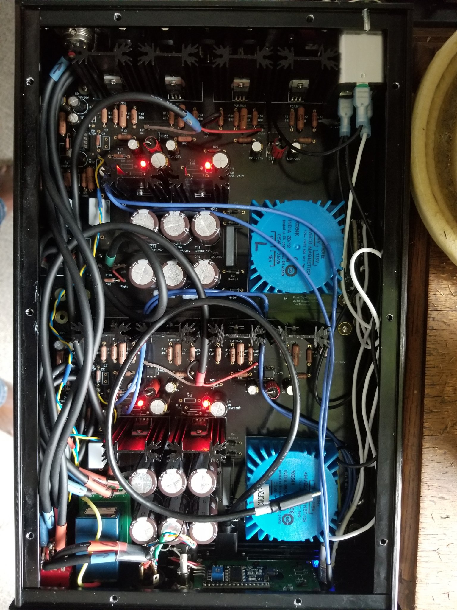

Hi rikiheck,

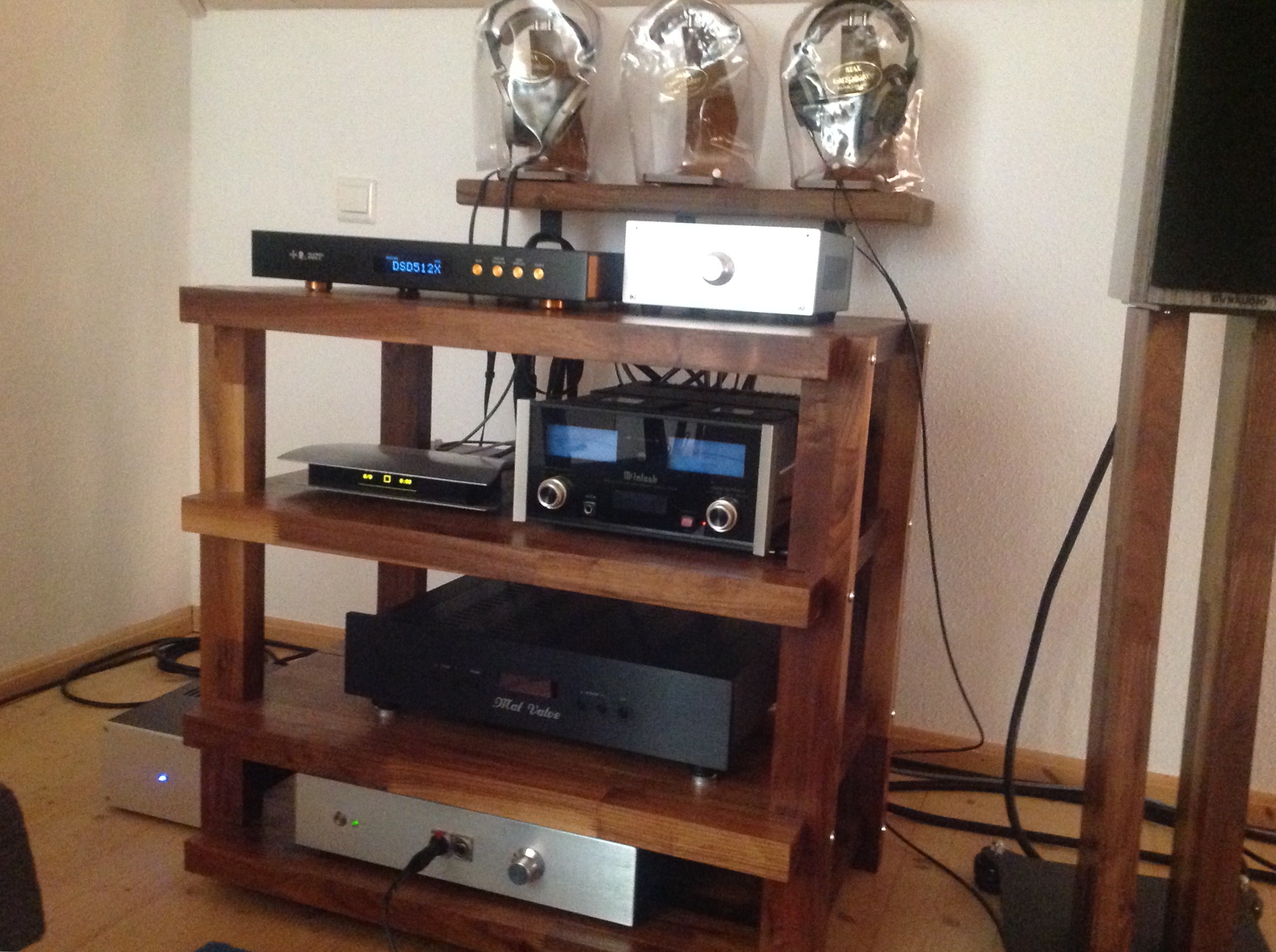

I did it (option 4) and it pays really off: Double whammy in differential mode. I can compare it with a single ended version of the whammy. I build one for my son and the double/differential whammy for myself. I'm a bit of a headphone/headamp freak because it's my 3rd headamp: I use also a McIntosh MHA100 and a Malvalve Headamp 3.
The setup is pretty simple: I go from a DAC - Holo Audio Spring 2 Level 2 - to a switch and from there to one of the headphone amplifier.

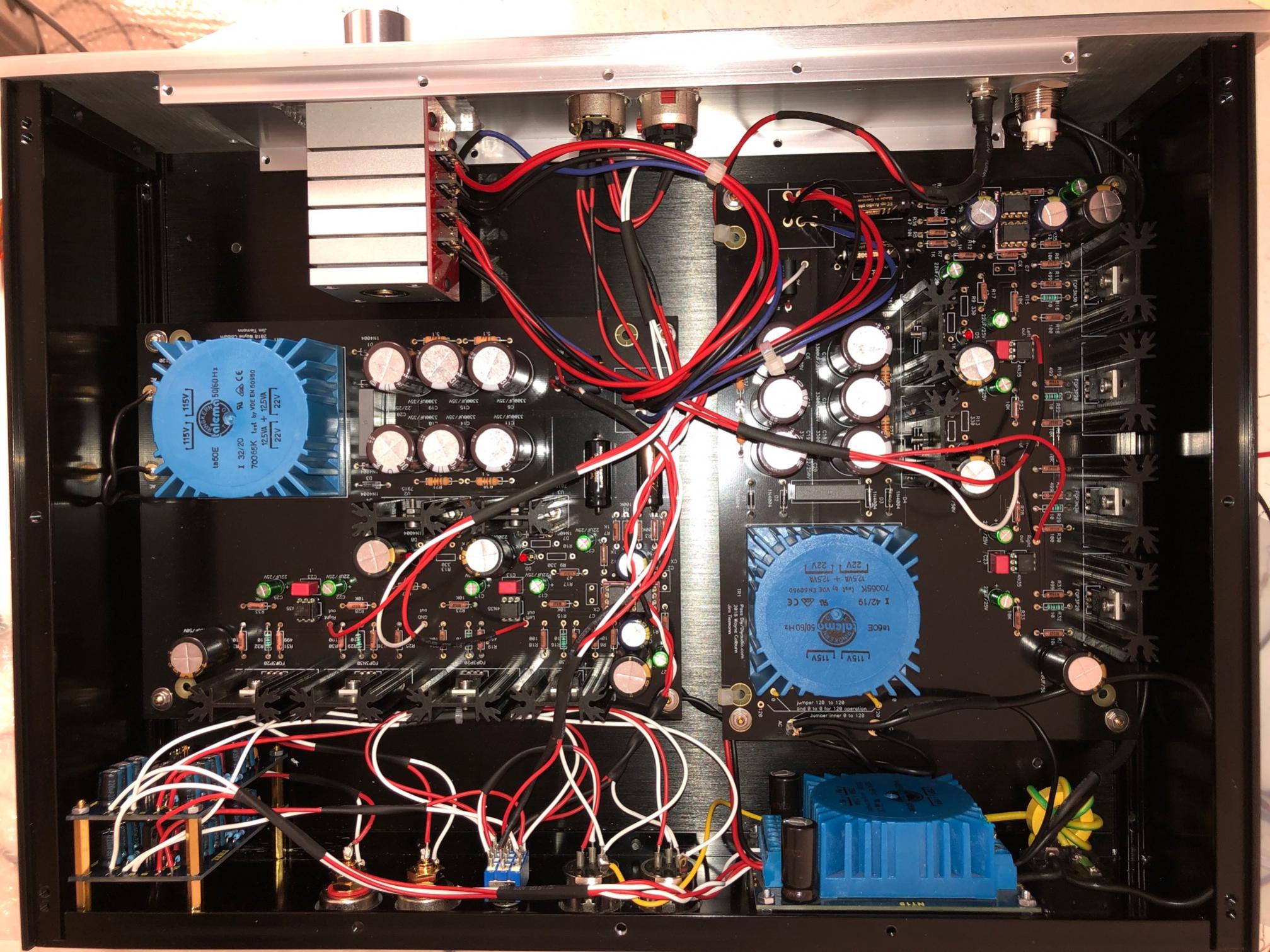

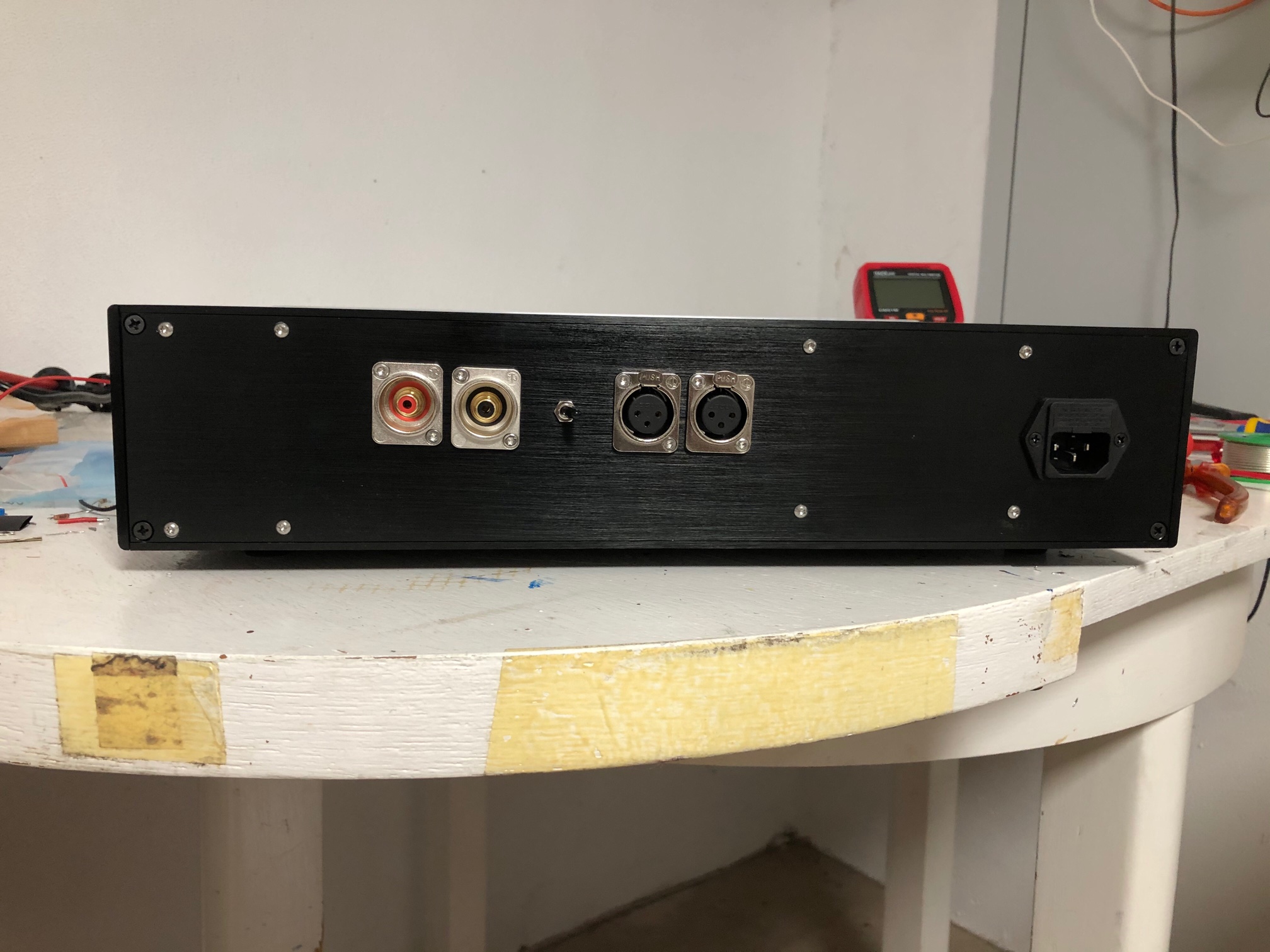

Special is in the Differential Whammy that I used a stepped attenuator (shunt) and a differentiator to get balanced signals from input RCA but I also - or better mainly - use balanced input jacks (XLR). And I'm using BB OPA627BP, two each side, a total of 4 in the dwhammy. I will add more details, stay tuned, and I hope I will be able to add some pics.
Differential & balanced Whammy - DBWhammy?

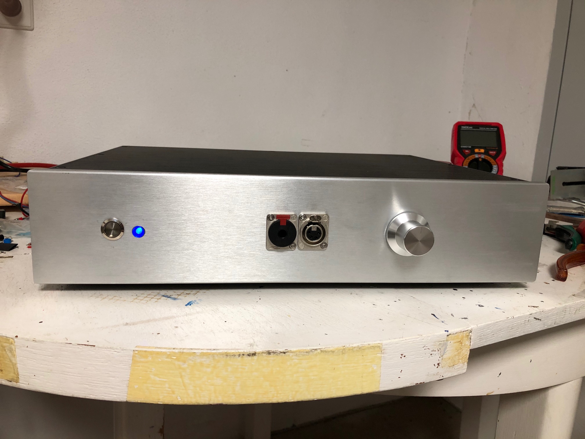

Here some pictures - if somebody wants to see the result of the differential & balanced Whammy. And the DBWhammy is socializing in the rack.

Hi rikiheck,

Hi PhopsonNY, Sorry I have not seen your response from september. Yes, indeed it‘s just two whammy. I‘m using 2 OPA627BP each channel and I love the sound really. I would rate in comparison with two other Headphone Amps the balanced Whammy the best sounding - of my collection and meeting my listening signature with the Sennheiser HD800S. I‘m using a balanced Khozmo resistor poti which helps to shift the setup to a very high level.
Currently I‘m buliding a balanced preamp with 6 stereo (3 stereo balanced) preamps ( Wayne Colburn LS BA2018 ) as a front end of my headphone amps - the used Holo Audio DAC does not deliver enough power and the combination sounds phantasic. I‘ve build one balanced BA2018 (2 stereo modules) as a preamp for our son and the unit was so dammed good that I decided to create something which I have never seen as a commercial product. BA2018 plus Wammy in a balanced setup with high quality poti sounds indeed absolute great!
