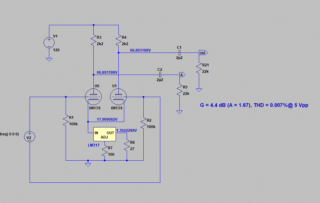

Don't really understand how important is the degree of disbalance in practice. I have left the input of the power amp to deal with this. Expected elevated second harmonic due to the imbalance but cannot really measure any, perhaps because of the transformer pp action.
The circuit shows a SE output but in reality it is connected as BAL. R7 is a rheostat.
Erik, Intersting idea...but how do you bring the cathodes to 10-20V ? One Resistor like in the Karna from L. Olson ? http://www.nutshellhifi.com/Karna.gif
Ok, but then we have only a differential pair with a non-perfect symetry as the Load resistor is quiet low compared to the impedance of a CCS...and especially for low mu tube you want a high impedance, dont you ?

Different story when two stages are there and dc-coupled. grid of second tube is elevated to anode level of the first one...so...we have enough headroom for the CCS plus the grid-cathode voltage plus the signal swing.
I never thought about this and never have seen a schmatic where the same theory has been applied to only one stage to get rid of the negative supply...but lets take this example of an 10y:
At 300V, we need about -10V for the grid at approx. 30mA. The CCS needs 15V to operate, the signal swing is maybe 1V, the headroom for the filament difference is 7.5V/2 as this is a DHT. So, we need approx. 10+15+3.75+1 giving approx. 30V total headroom. Add a tv-damper and it will be 70V.
So, we need to shift the whole psu by 70V up: Anode 370V, grid 60V, Cathode 70 (middle point), cathode of tv-damper 30V, Bottom of CCS 0V.
The price to pay for this would be a new coupling cap for the grid I am afraid. So which devil is worse ?

Hi Blitz,
we already exchanged some ideas regarding this in post 26 and 27.
The idea is that indeed one replaces that resistor (as in the Karna) with a choke with similar DC resistance and gapped for the required current. The DC resistance sets the idle operation points while the inductance provides for a higher load. You did some calculations on that already
I would use the splitting transformer at the input, so the stage already becomes a balanced input signal. Theoretically that would not even require the choke in the cathodes anymore (Lynn Olson is not using them as well, just plain resistor), but the choke would certainly change the operation characteristics (for example better isolation from PS, true differential operation) that the end result will be different than the plain resistor.
I have never done this myself, as I do not have wideband chokes at hand (and try to reduce the use of iron as much as possible).
