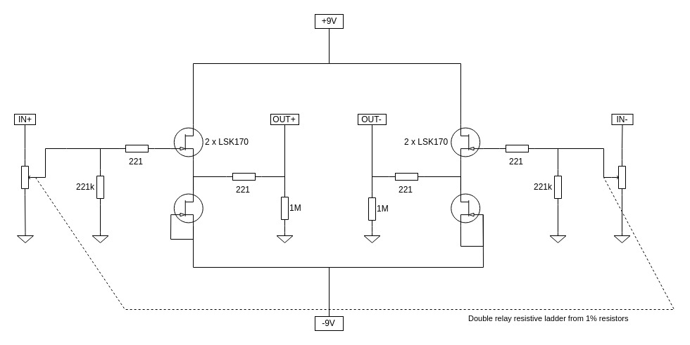

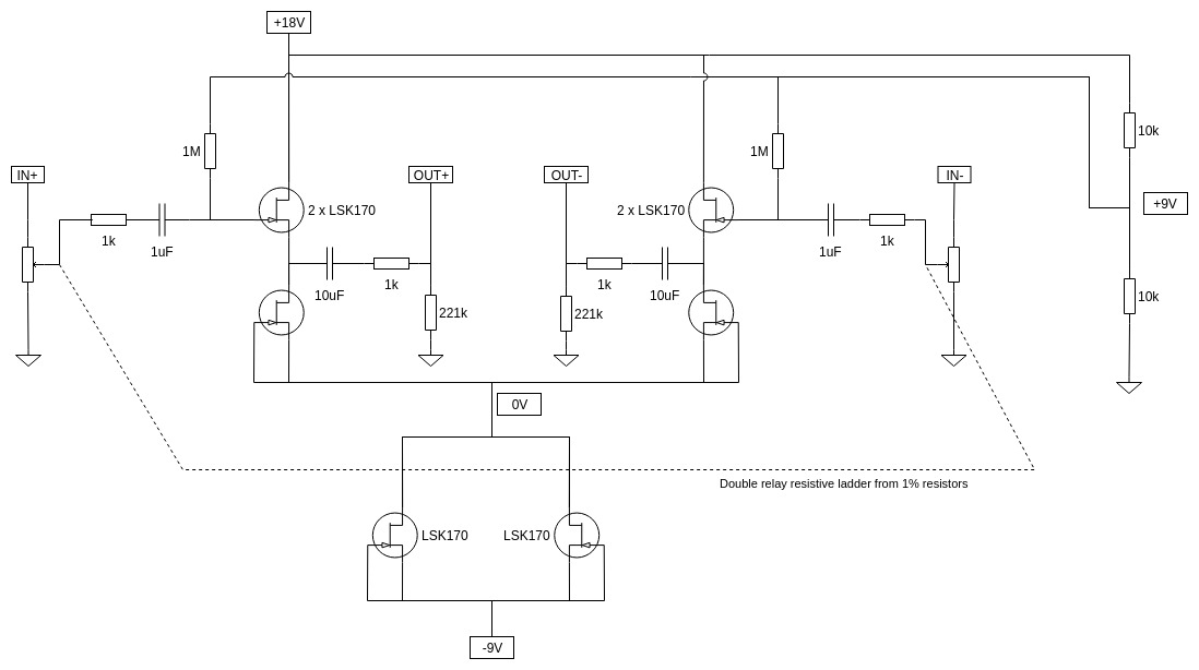

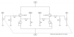

B1 Balanced
Sorry. Let's try this one
- Balanced B1 preamp
